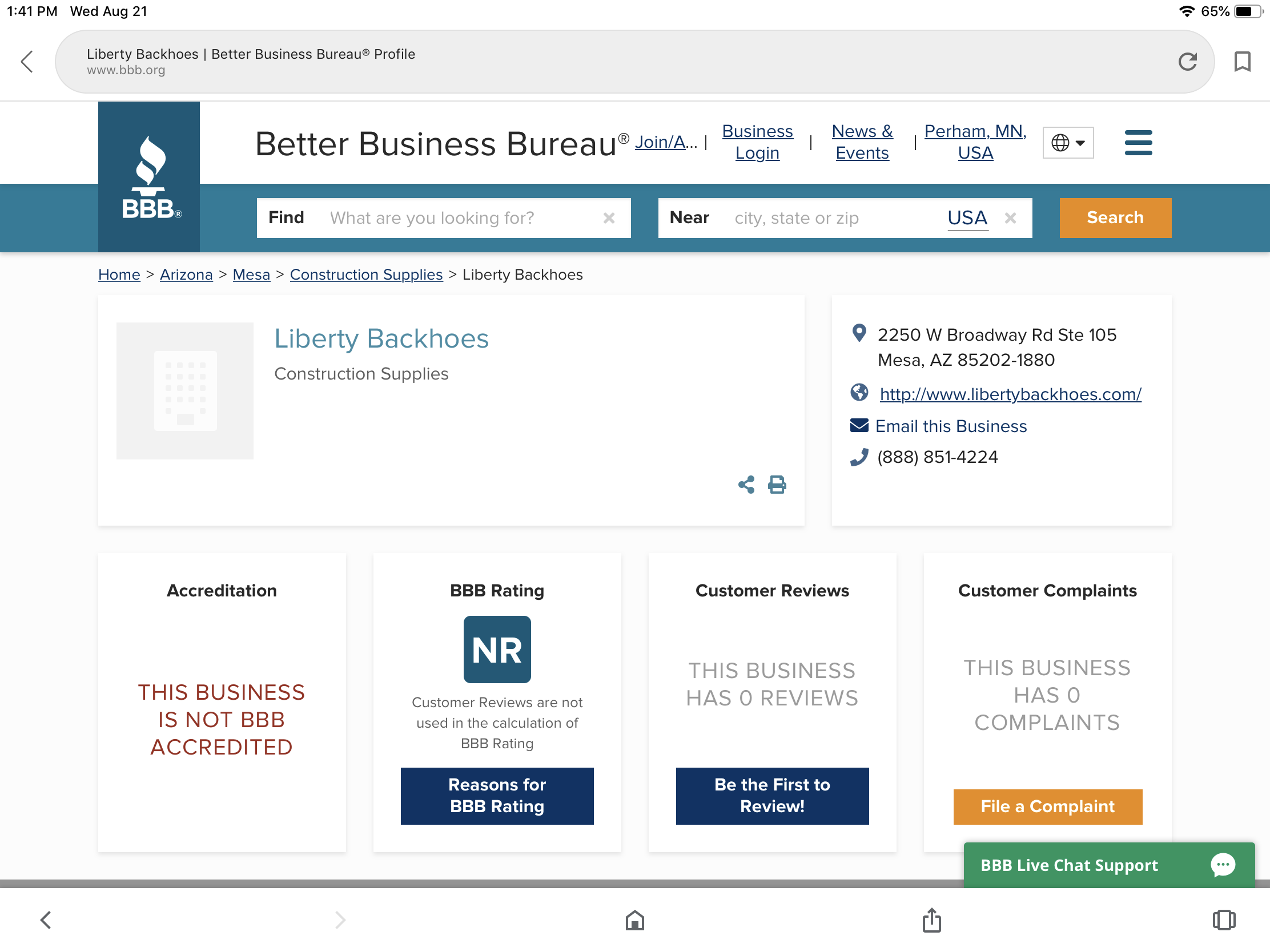

Can anyone share where I might find some information such as retailers, service providers, owner/service manual, etc... for a Liberty Implements Backhoe attachment?
I just purchased one second hand and from appearances it looks practically unused. However the operation of the hoe, though functional when not under load, is not generating enough force to dig when used in sod. The obvious source (Liberty Implements) doesn't have a currently functioning website (or at least I can't find one), nor is there an answer at the only phone number I can find.
It's a 3-pt hitch unit with a PTO powered pump, sitting on the back of a Kubota L3830. No leaks or obvious damage to the hoe. Specifically I'm wondering about the hydraulic fluid spec and failing that as a reason for weak output, is a pump rebuild an option? There is no name on the pump to indicate manufacturer but I do have pictures if someone can identify the source of the pump through those.
