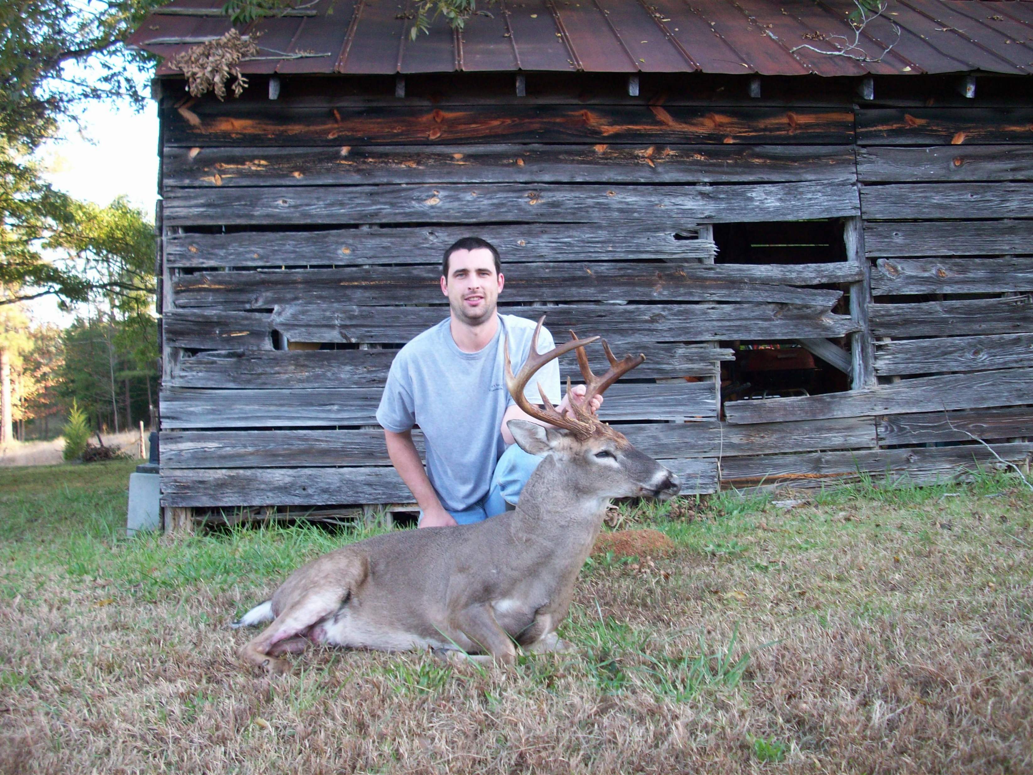

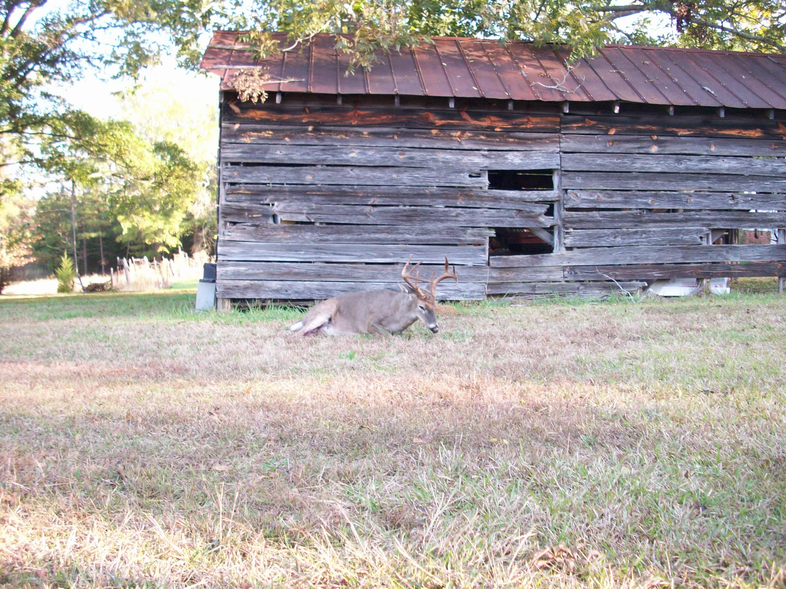

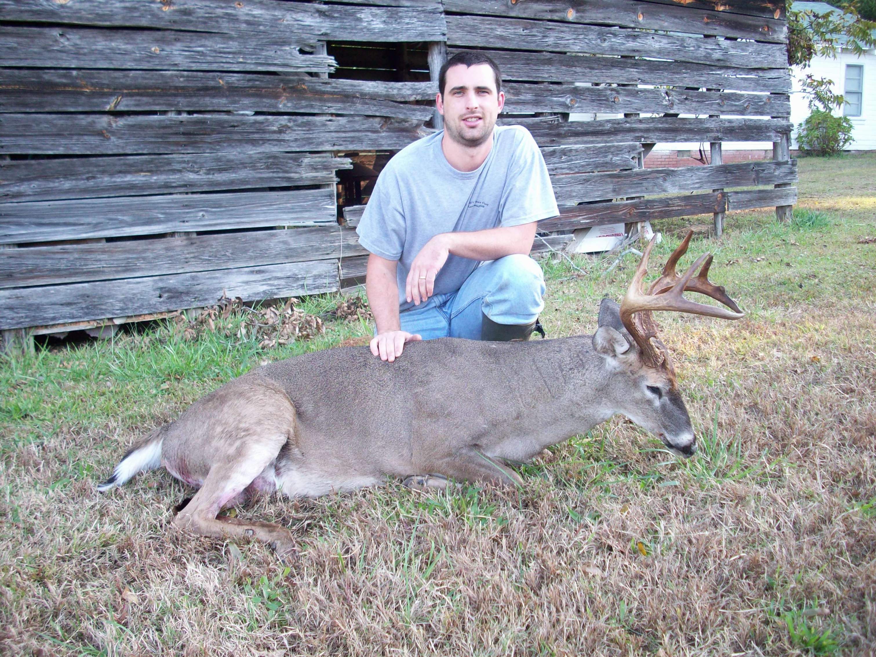

Your dirt is just like mine on the farm. Depending on where you are you can have a sandyred clay load, just red clay and there is decomposing granite everywhere. The sap wood is what rots fast in like a year or so. If this is a large part of the tree it will loosen in the hole and cause it to fall over. If you trim the white off and just leave the red like someone mentioned and you still have at least 6"s i would say they should last 50 years easy, red cedar is very rot resistant even in the ground.
The wood shed on the property has been torn down several years ago due to post rot and leaning nature of it. The carshed, chicken house and cow loading shed/storage sheds are still in great shape, minus all the rotted boards used for flooring and siding that were just rough cut green pine and never treated.
These pictures show the carshed i am talking about. To the left in the picture is a workshop/room that is about 6 feet wide. The area to the right opens on the end and is just open. There is a floor on the left that is rotted and sagging. Many of the boards have weathered and broken off or are just very thin as the termites have eaten about half of them, esp on the back side where it is shaded.

OK you hit the problem on the head. a 3-4 inch tree has very little hear-wood, which is the only part that is really naturally disease and rot resistant.
In my pics you can see some of these posts look like they are 5-6"s at ground level some maybe pushing 10". NONE of these were trimmed though. Im sure rotting of the edges has occured but this shed is still very solid as the posts and framing are still wwell intacted.
