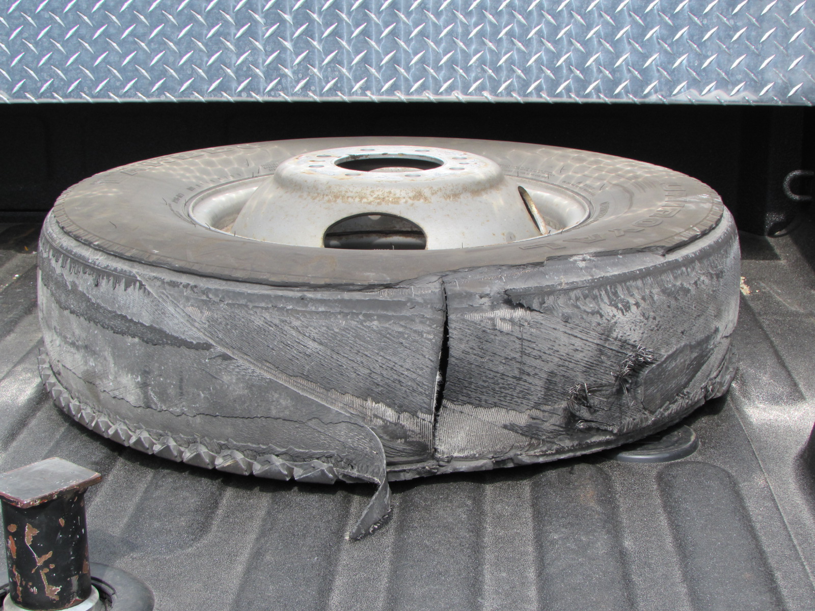

I bought my dual tandem gooseneck trailer new in 2006. That makes my tires 8 years old this summer. On the way home from a tractor show this weekend. Ka-Boom!! Right rear outside dual blew out. There is no sign of any sidewall cracking, dry rot, or anything else with these tires. If I am successful posting the photo, you can see this wasn't a sidewall blow-out. It split right across the casing on the tread side. I've never seen anything like it. I am considering this a "warning shot" that my 8 year old tires should be replaced. What do the rest of you think?? Tire Blow 13Jul14 01.JPG

Did you happen to notice the date code and where the tire was made?
I've seen new trailers with 5 year old tires.
No arguement from me on replacing all of them.
Have you priced Greenball?

I bought my dual tandem gooseneck trailer new in 2006. That makes my tires 8 years old this summer. On the way home from a tractor show this weekend. Ka-Boom!! Right rear outside dual blew out. There is no sign of any sidewall cracking, dry rot, or anything else with these tires. If I am successful posting the photo, you can see this wasn't a sidewall blow-out. It split right across the casing on the tread side. I've never seen anything like it. I am considering this a "warning shot" that my 8 year old tires should be replaced. What do the rest of you think??<img src="http://www.tractorbynet.com/forums/attachment.php?attachmentid=382840"/>
8 years old is 2 times too long for a tire.
Chris
