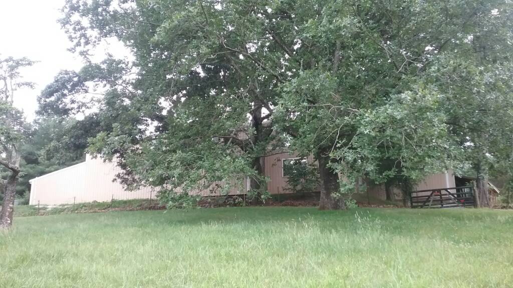

Sounds awesome. Off topic, but have any pics to share?

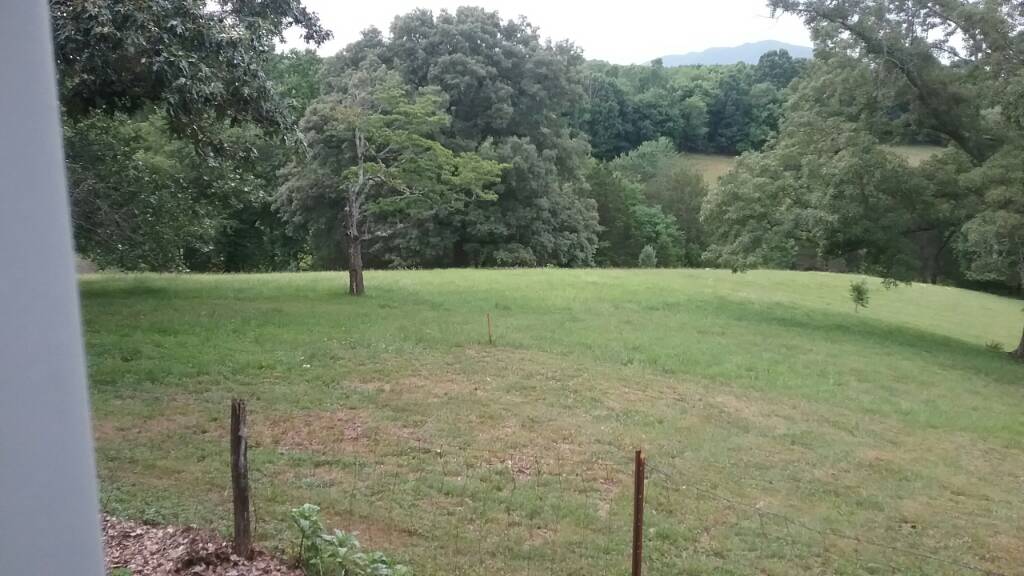

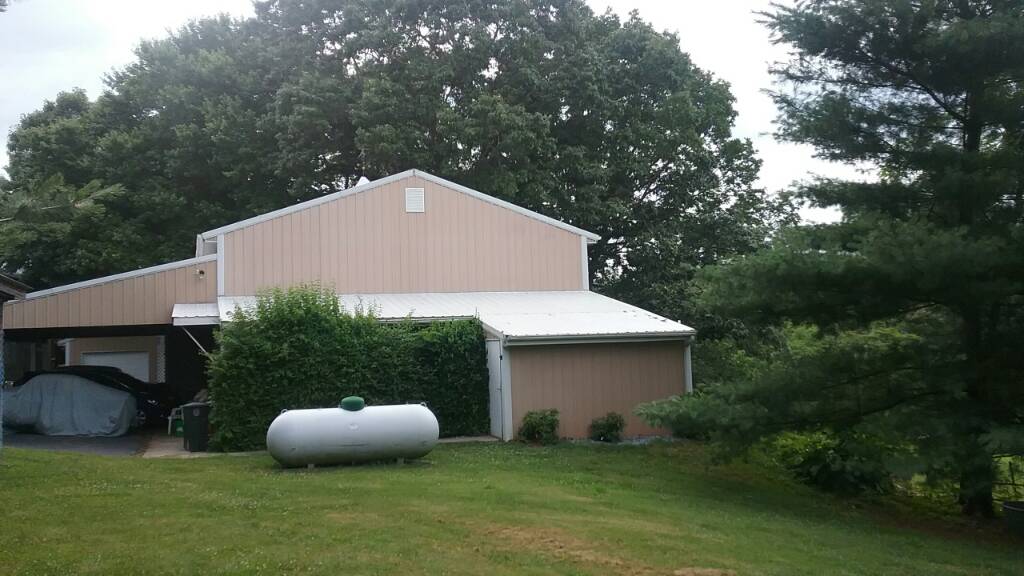

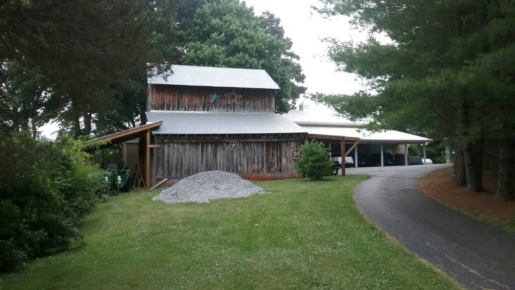

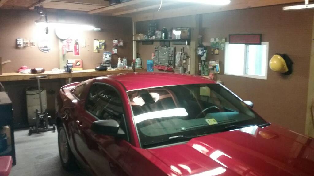

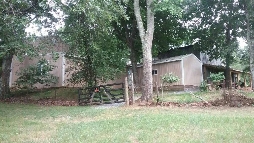

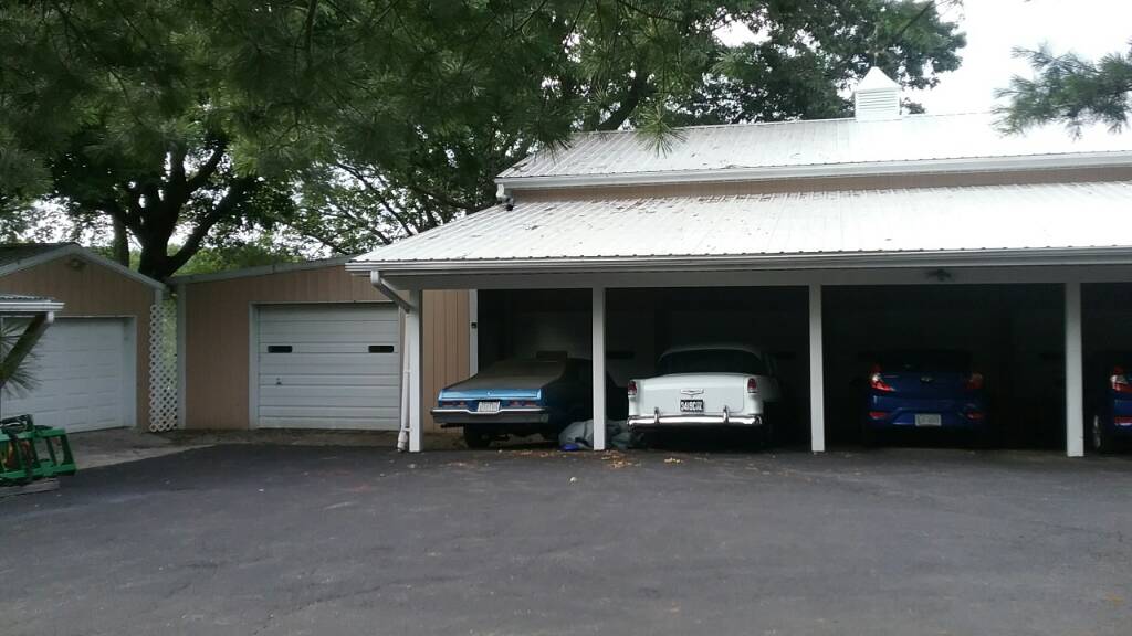

/ LIFETIME PLASTIC SHEDS? #14
Sure. It's hard to take pictures for all the trees. The back is where barn and hay shed will be. That old fence and gate will be removed.
That old tobacco barn is of course separate.20180621_183707.jpeg20180621_183753.jpeg20180621_183610.jpeg20180621_183938.jpeg20180621_184040.jpeg20180621_184227.jpeg20180621_185212.jpeg
