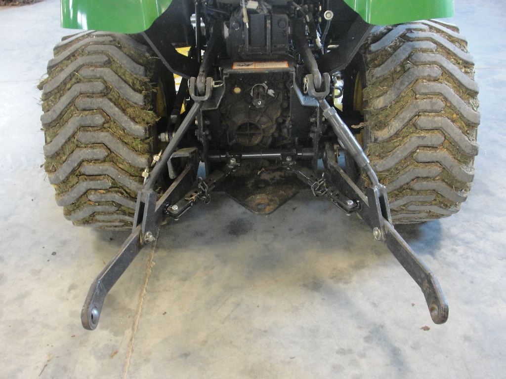

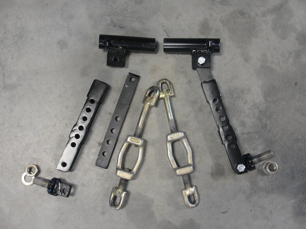

I built a pair for my JD2210. Great addition.
For some reason I can't post pics right now. I'll come back later and post some.

   / lift arm ajusters #6
Here's my pics. The turnbuckles in the first pic is what my tractor was built with.
   / lift arm ajusters
Fantastic...this is exactly what i have on my Kubota 2650 i wish they would do them all like this. THANK YOU VERY MUCH
