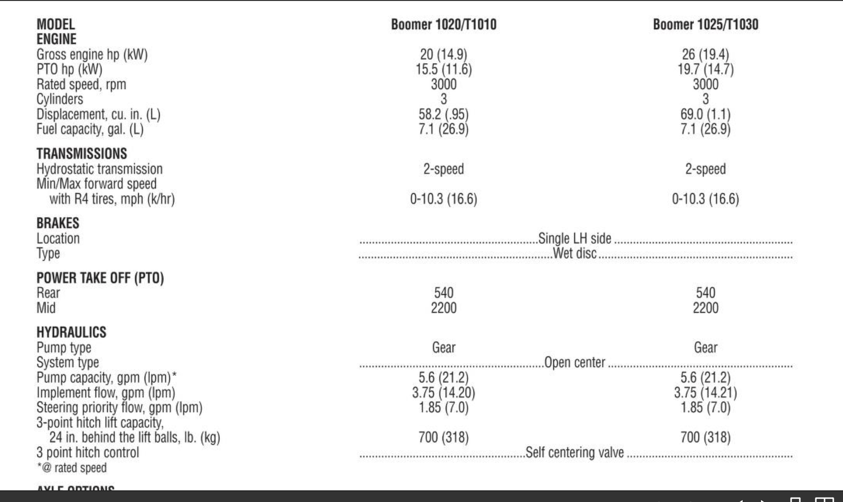

According to the spec sheet, the T1030 NH has a standard hydraulic 3pt hitch. The specs show it to be just like any other compact tractor. .
If so, it should also have a knob under the middle front of the seat. That knob normally works a needle valve that controls 3pt lift arm drop speed. But if turned all the way in, it will completely block the outlet from the 3pt lift cylinder. That is often used to hold the arms in any position.
