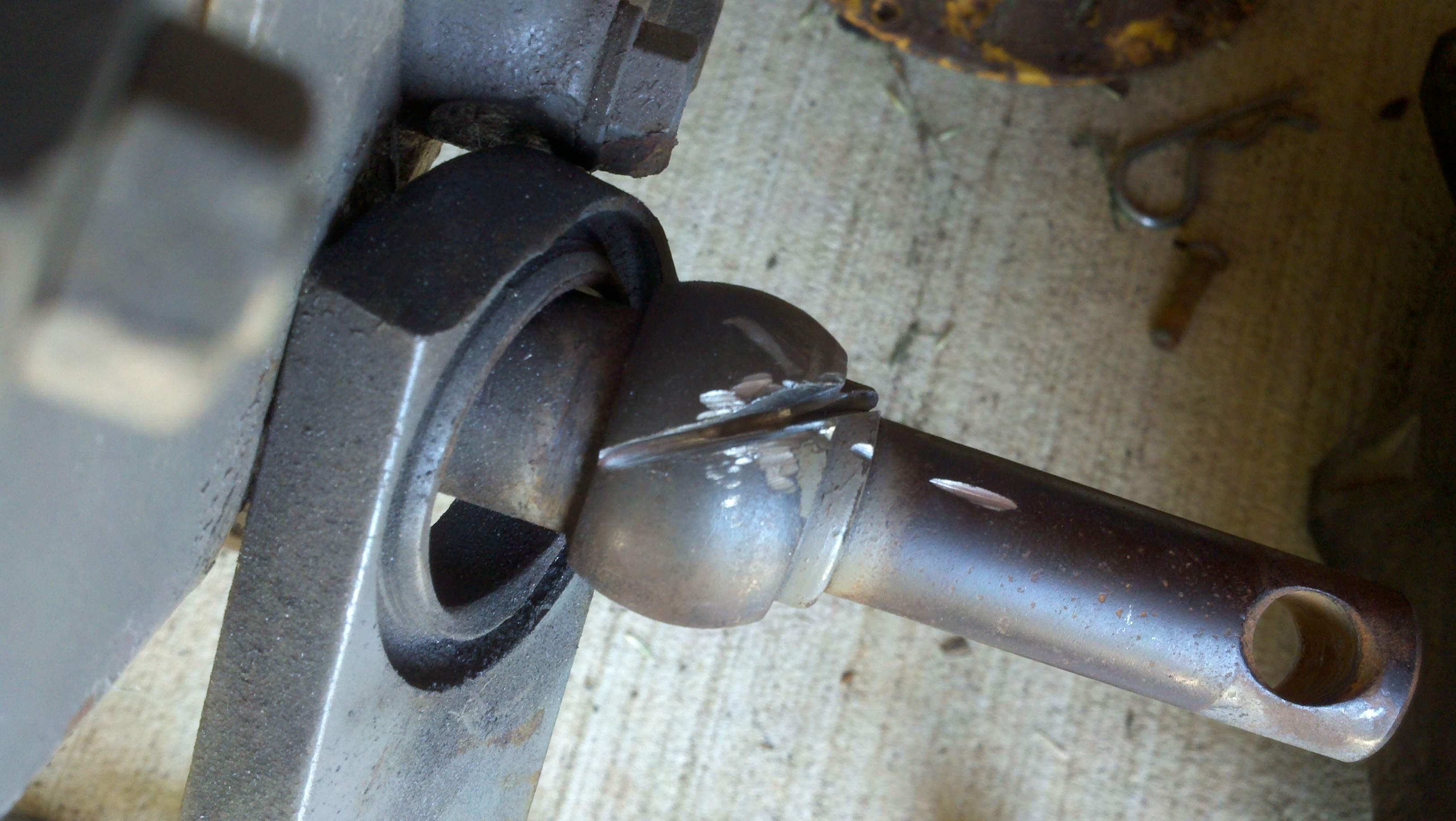

My lift arm ball joints are frozen to the shaft and I can't remove the arms. One arm is completly seperated from the frozen ball. Can i heat them to unfreeze them and then whack them off with a hammer?

In the picture it looks like the ball might be one piece with a sleive that slides over the shaft (on the inner side). Is there any hope of removing the whole shaft to work on it?
No chance of an allen key in behind holding things together?
If the arm was on the ball where it belongs, would there be any need for the ball to move on the shaft?

Just be careful not to overheat,in case there is a. seal that could melt. I've cut bearing races off shafts with no problems.

If the arm was still on the ball, I could use the lift. Somehow it popped off so I need to remove the ball from the shaft so that I can get the arm off so I can go buy a new ball and press it in the arm. But, I first have to get the ball off. It all just slid on when new, but that was a while back. The shaft itself moves fine, but the ball will not. Nor will the ball on the other side. I am going to try to hook up a gear puller on it, heat the ball somewhat, and give that a go. If I could get one side off, then I can pull the whole shaft out. Thanks for your suggestions and I am headed out to try some more.

First I would ask what you are trying to accomplish??
And you trying to remove the shaft? or simply put the ball back on the arm?
If you are trying to remove the shaft, (it looks like it is already part way out), can you continue to remove it and use a press? And if you are trying to take the ball OFF the shaft, a die grinder and a little slit lengthwise and she should slide off by hand.
If you are trying to drive it back ON, becarefull with the heat. I dont know your model, but some tractors have that shaft runnign through the differential with a seal on each end. You dont want to melt that seal. Also, you dont want to take that shaft out if this is the case until you drain the oil:thumbsup:
IF you are trying to put it back on, I'd get a peice of pipe that JUST slips over the pin, and possibly remove that tire to get a better swing with the hammer.

Pat31rf, you are right about the ball and sleeve being one piece. It came that way hooked up to the arm with the 3 point lift system. Now I think I will take the advice of LD1 and put a slit in the ball and try to chisel it off someway.

If you get it slitted all the way through, is should fall off. If you are worried about messing up the shaft, dont quite grind all the way through, then use a chisel like a wedge and give it a few pops, you will see it when it pops appart. The cut line will expand. She will pull off by hand then:thumbsup:
Have had to do a lot of bearing races this way

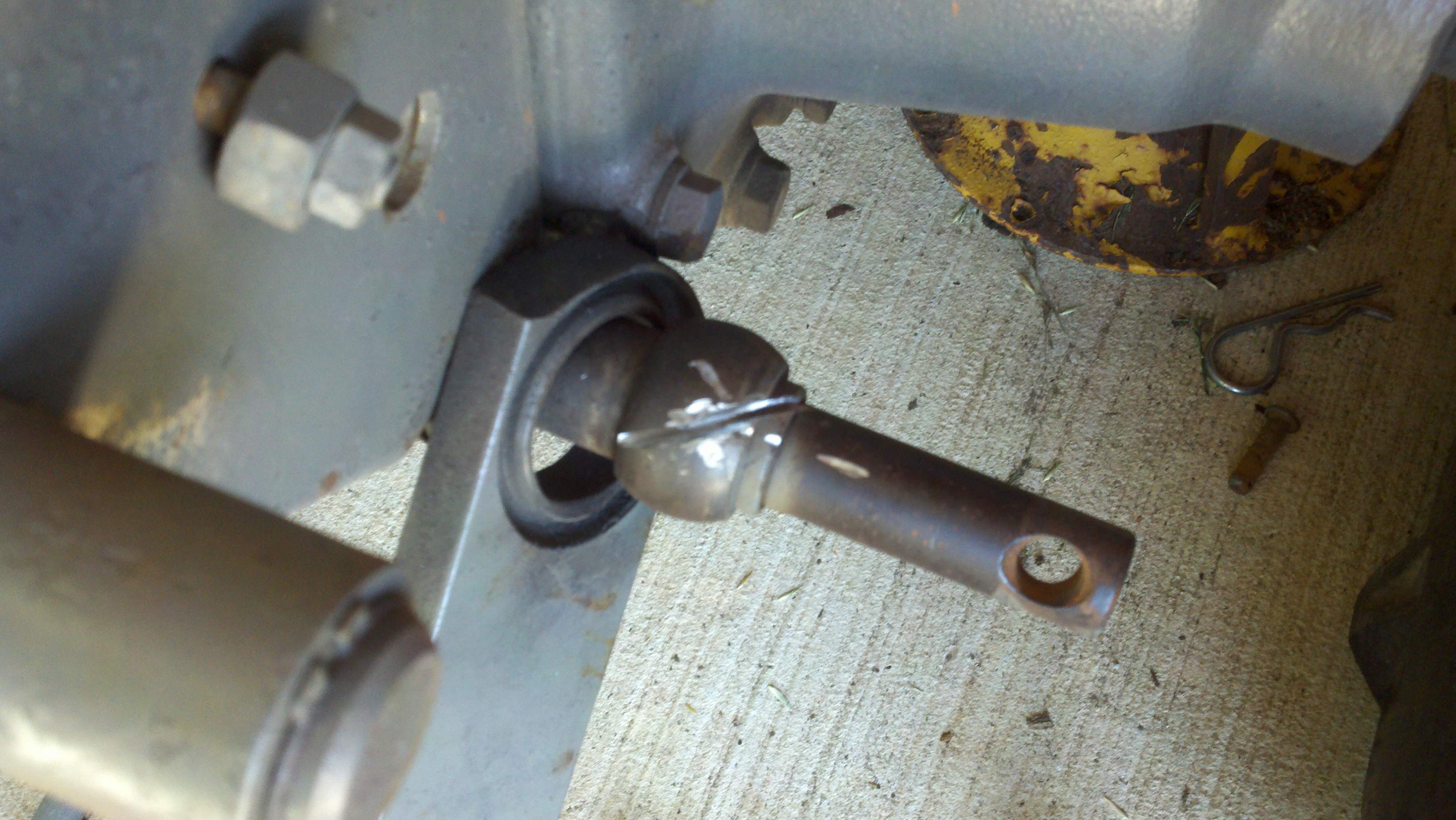

Still won't budge! I put a air chisel to it to try and loosen it. Any ideas? Thanks

Heat it up with a torch,and put a pipe wrench on it,to break it loose.
