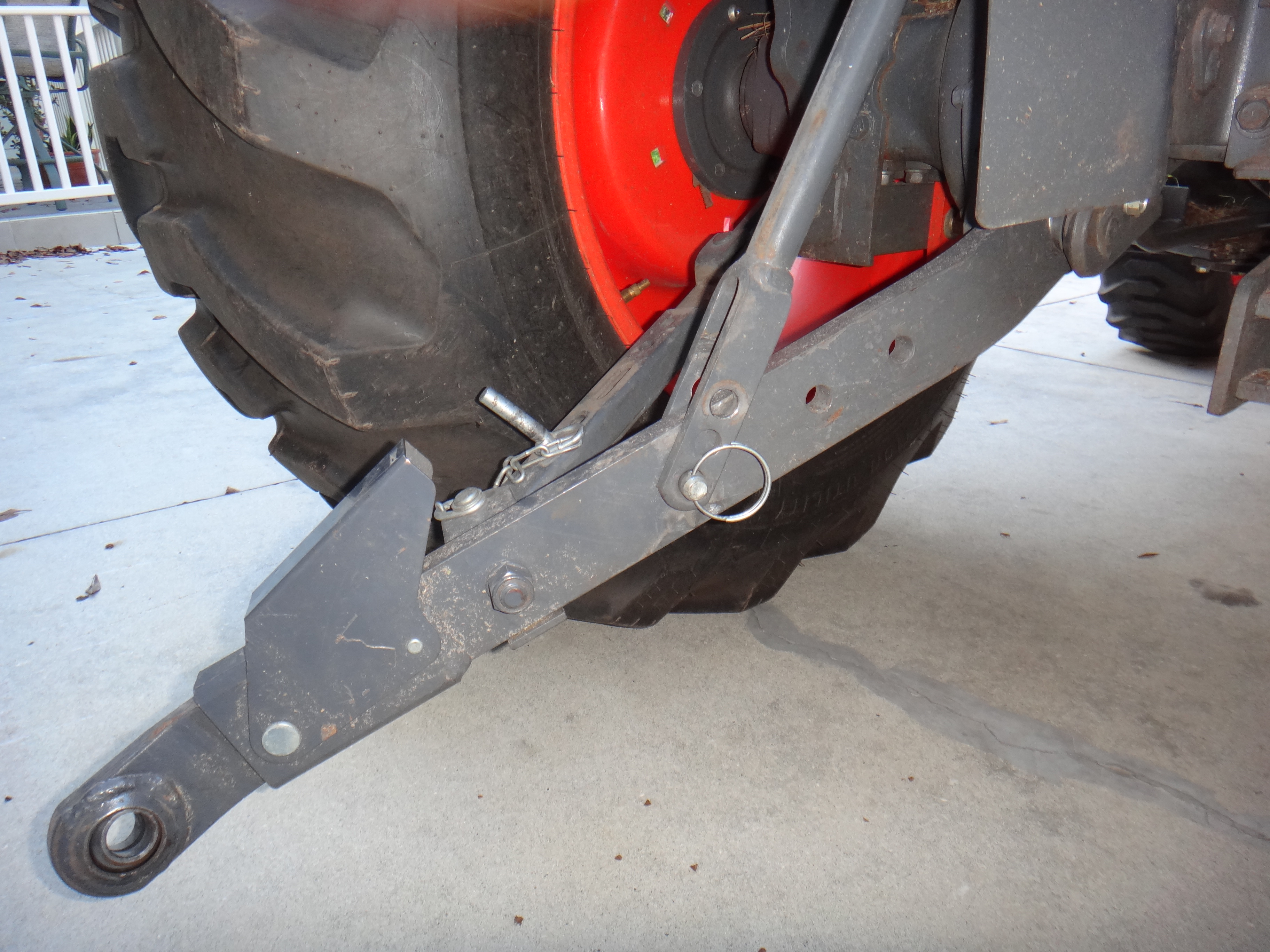

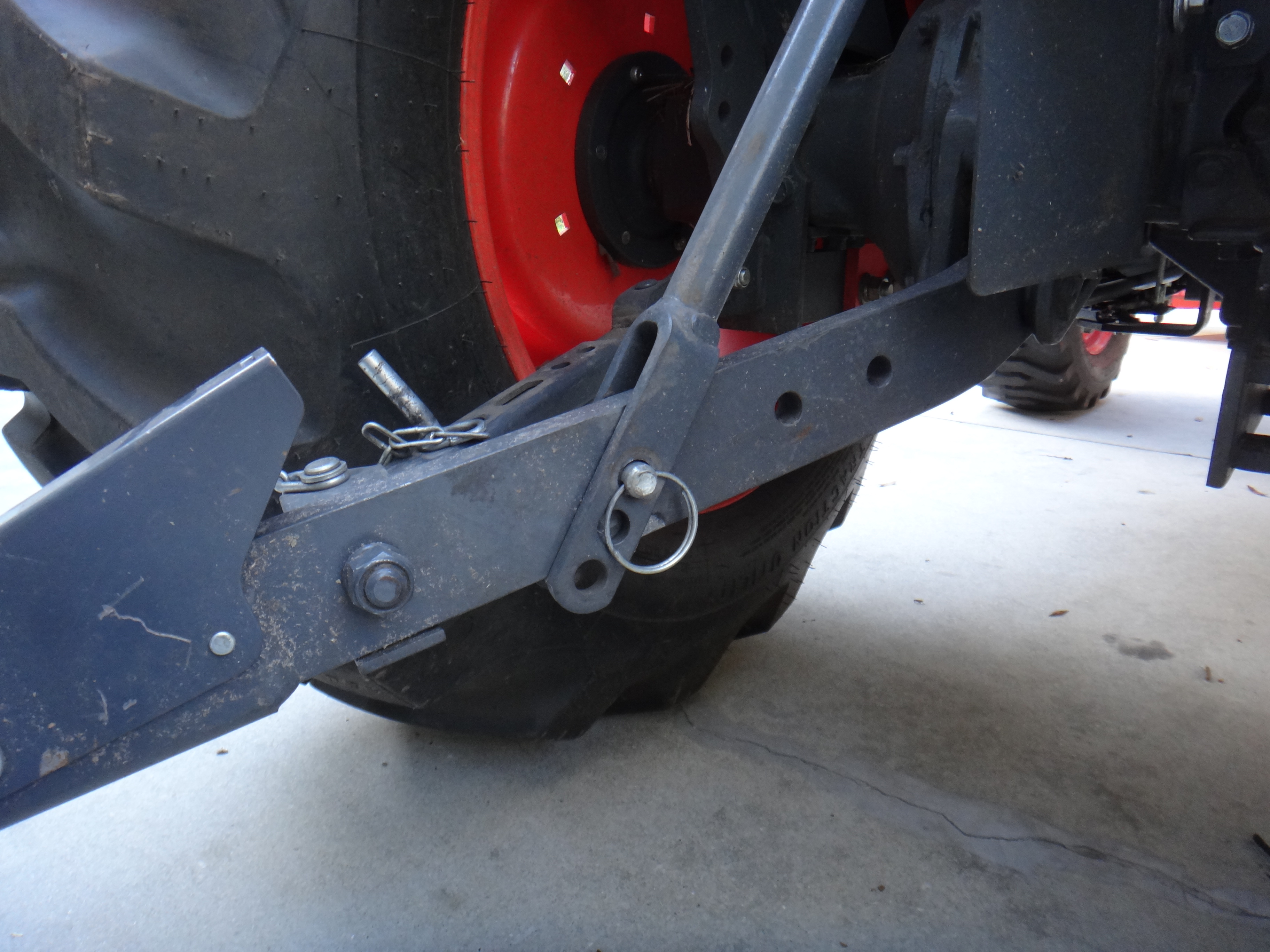

My tractor has hole and pin adjustments for tilt in the Lifting Rod stirrups. Three hole and pin adjustments on the left stirrup, two hold and pin adjustments on the right stirrup. "LOWER HOLE MEANS LOWER LIFT.
Setting tilt in this manner allows you to keep both lifting rods in about equal tension. If you have to much tension in one Lifting Rod, it means the other Lifting Rod is offering very little support.
It is easier to set the left side of the implement lower, so when it touches the ground it is RELATIVELY easy to turn the screw adjustment for the right Lifting Rod.
