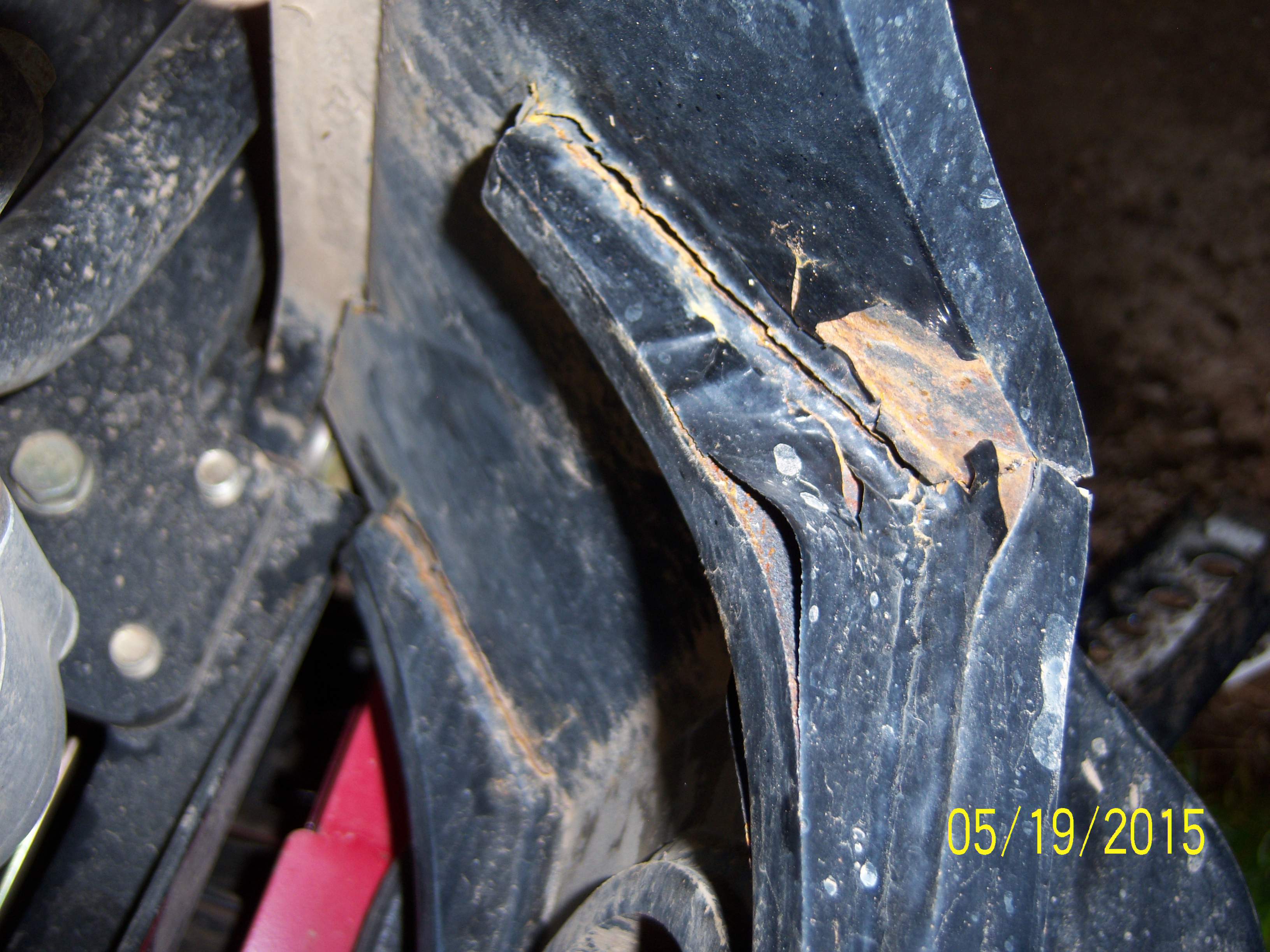

I suspect they will take care of this, even though it is out of warranty. Meanwhile, any other folks with a ML150 loader ought to check for cracks. First sign will be a small crack in the paint at the bend.

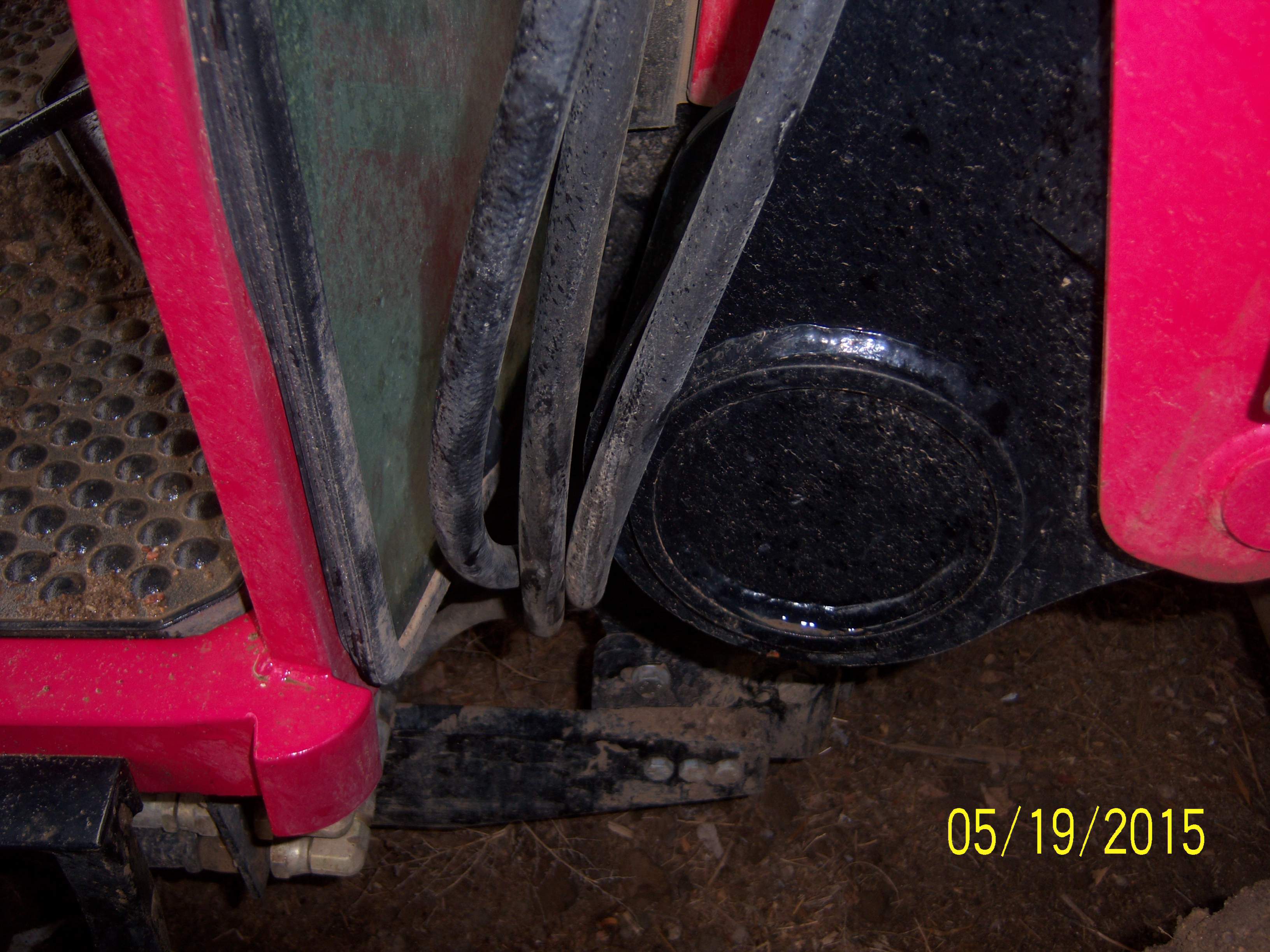

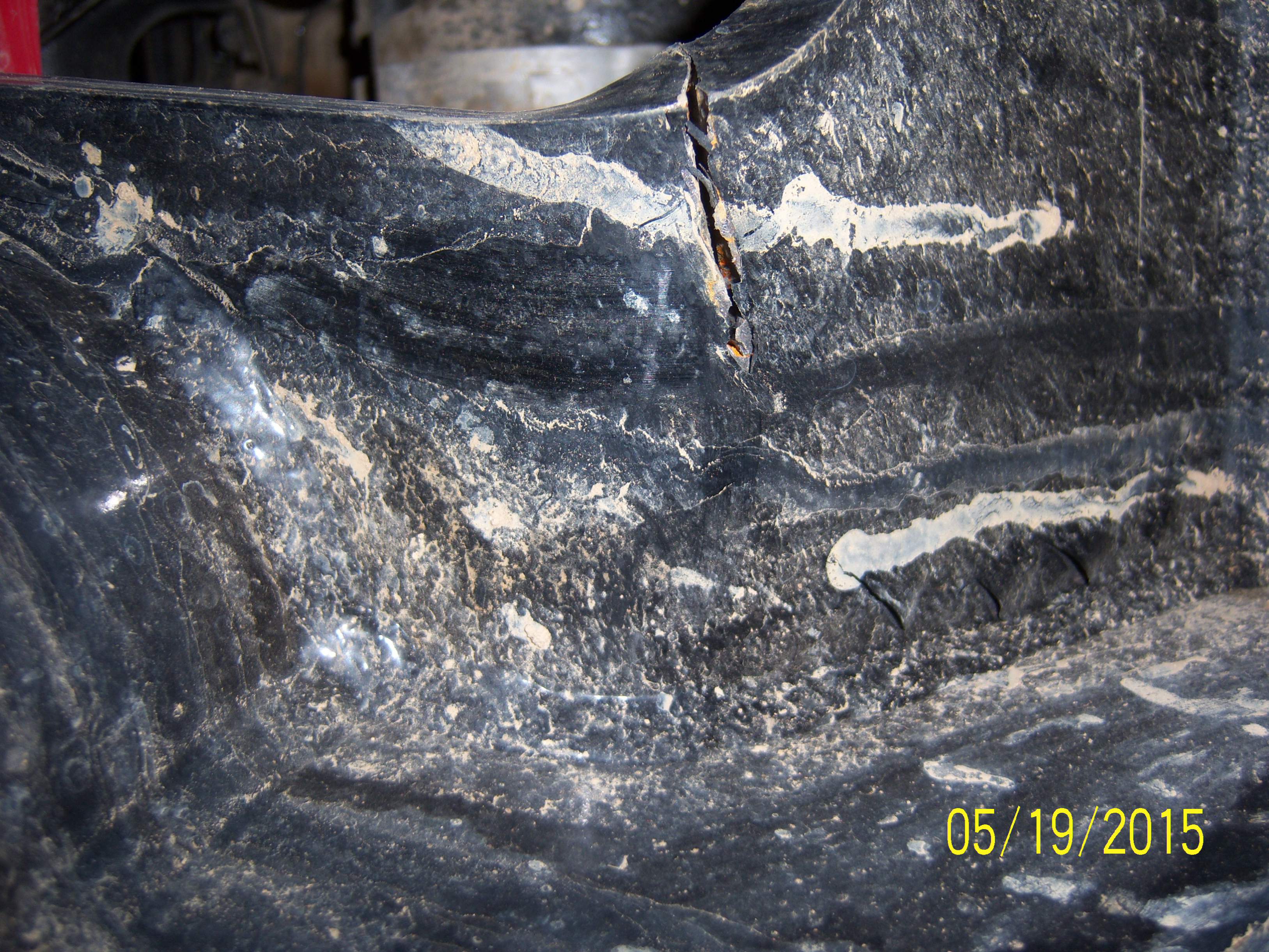

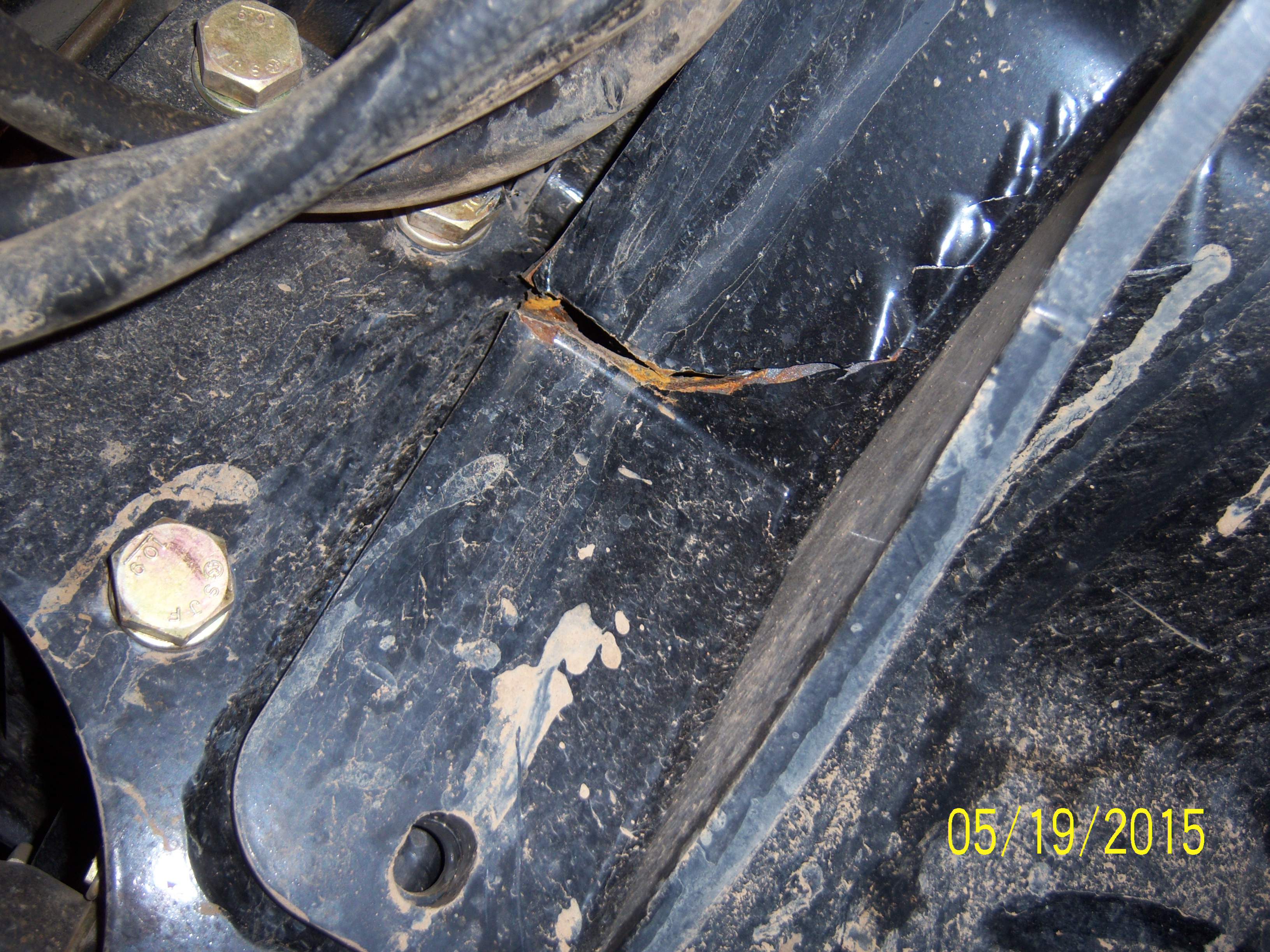

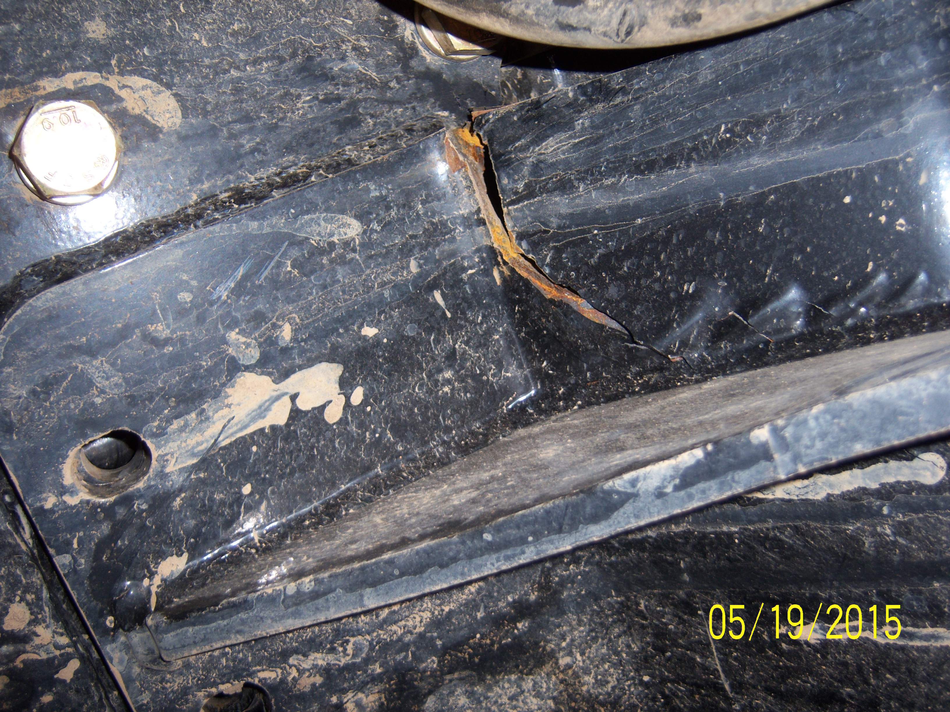

I"ll give her a try
Hope these show up. The pics are of the right side bracket that attaches the loader to the frame

In the last picture on the right it looks as if you have a badly worn hydraulic hose.

Just dirty, although one was pinched between the frame and stuck in the crack. Just a little abraded though.

From what I can see, this is a serious example of under design. If MH ante ups the parts you can reinforce them based on your experience before they go into service. ... It may be that sharp edges where left in hi stress areas, making them prone to cracking. In that case the strategic removal of a very small amt of metal by blending those edges with a flapwheel will increase durability w/o welding in braces. MIGHT be enuf. :confused3:
,,,larry
   / lift arm ram on my 5010 gear broke #17
On the open station, the ML150 was changed to a ML151. The ML151 was braced better. On the cabs, the ML155 was changed to the ML156, again with better bracing. All replacement mounts have the better bracing.
