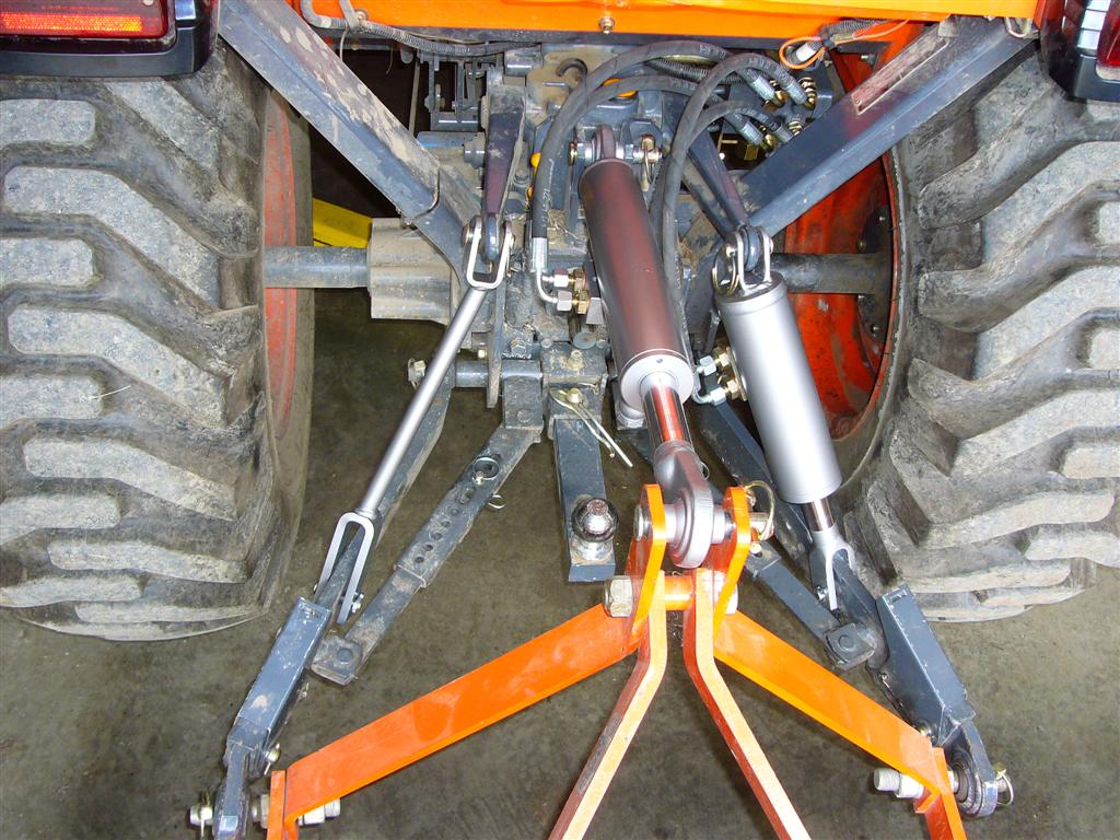

That perfectly describes the stabilizers (horizontal links) on our Kubota L3830, but I have never seen or heard of the lift links being made like that. Any chance you have a picture of them?
See:
for an example of the type of stabilizers I am talking about on a B3030.
(Picture source: http://members.shaw.ca/B3030)
See pages 2 and 3 of: http://www.sparexusa.com/Catalogs/Compact/3point.pdf for the types of lift links and stabilizers I am familiar with

Can't say I've looked at the 3x20 series tractor's anti-sway links..
As I'm sure you know, I own one. The vertical links - or lift arm stabilizers - are 2x2 square tube (with handles) over a threaded center, right and left both adjust. They're greaseable. The horizontals (side or sway links) is a 1x1 square pin hole tube over a piece of 3/4 flat rod, also with pin holes. They are both adjustable as well, but don't require grease.

Stopped by the Kubota dealership this morning to see what they had and how much gold they wanted for it. A set like I described in the OP was $400.pair. I almost choked. I studied some pictures of some and off to the steel yard I went. Bought a 3' piece of 2x2x3/16, a 3' stick of 1.5x1.5x3/16. I already had some 2" X 3/8" flat bar laying around to I used it on the outside end of the 2x2.
I heated and formed a 1/2" loop on the end that shackles to the axle and am able to use the existing shackle. slid the smaller insied the biger and drillled 6 holes 1" apart through both tubes at the same time. Right now there are 6 1/2" holes, 1" apart CTC or adjustments. 5" of adjustment should be enough to get this thing tuned up. The steel prices have gone crazy. a 3' 2x2, 3' 1.5X1.5 and a 3' 3/8" X 2" flat bar was 56 dollars. I already had som old turnbuckles laying arondt.
Will post pictures tonorrow is I think about it!
