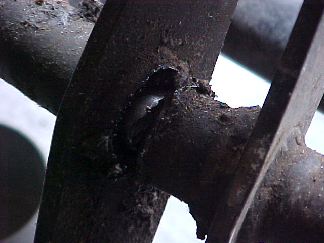

   / Lift arms #5
Shows broken center pivot pin, both sides.
PJ

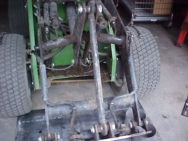

   / Lift arms #6
Close up of one crack.
PJ

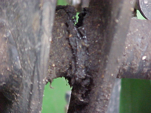

   / Lift arms #7
Final shot of other side.
PJ
