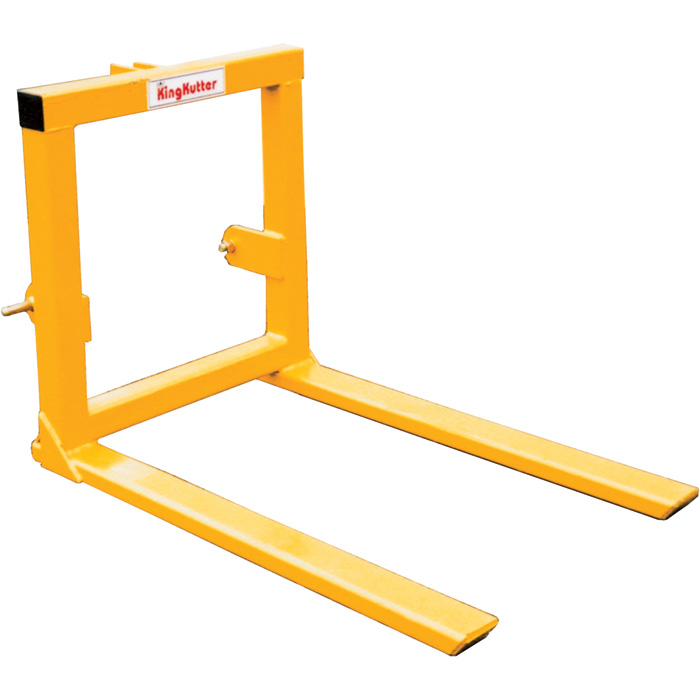

The original thread question:
If your 3-point hitch is rated to lift 1500 lbs, can you put on a 100 lb lift fork attachment and then lift a pallet weighing 1400 lbs? Not driving around, just simply lift a pallet of that weight?
Has anybody verified their tractor's maximum lift with a known weight? A pallet of landscape pavers, for example, you could count the pavers and know pretty accurate. Four 55gal drums of fuel is 1400 lbs. Understood that rarely do you actually know the real weight of a pallet.
3-point pallet fork example: View attachment 418435
So I had to go back to the beginning (having been following this whole thread with lots of amusement, thanks for that!) to remember what was the original question.
Sodo my answer to your above question would be you're right at the limit of what your tractor on paper will lift so that in itself tells you you may or may not be able to lift the load, BUT if you want to "help" your tractor and possibly guarantee that it will lift it then add a hydraulic top link which will allow you to adjust the length of the one "arm" and make the arms closer to //. (lol had to get those in there.) Joking apart though if your hydraulic toplink has enough length to allow it to become just marginally longer then the lower arms then effectively you'll be able to lift slightly more then the max your tractor can lift on paper keeping in mind doing so means:
1) it won't lift as high
2) the load will start to tilt down as you lift up - the longer the top link is vs the lower arms the more this effect will become pronounced.
Incidentally a hydraulic top link will make using a set of forks on the back of the tractor much more useful. (sidebar to the original question, sorry.)
Last thought: If the original question was asked because you're planning on doing said lifting all the time then I'd say go get a bigger tractor - being right at your limit every time you use the tractor will be frustrating and quickly grow old. If you asked this just to find out how close you can get to the tractor's theoretical limits then frankly while you're going to get (and have got) lots of friendly advise at the end of the day the only answer that's really going to satisfy is for you to test it out yourself, and then you'll know exactly what your limits are. If you find you cannot lift anywhere close to what the tractor "should" be able to lift then you probably need to adjust your relief valve. I'd expect a tractor to be able to lift pretty close to what the manufacturer advertises. That's been my experience to date.
