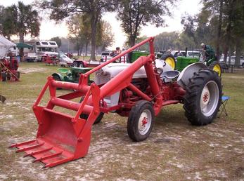

Get you a fancy one like this and you got plenty of room for the cyl.. ( it's back on the backside of the upright portion of the mast.. uses a rocker arm and rod to xmit the power. )

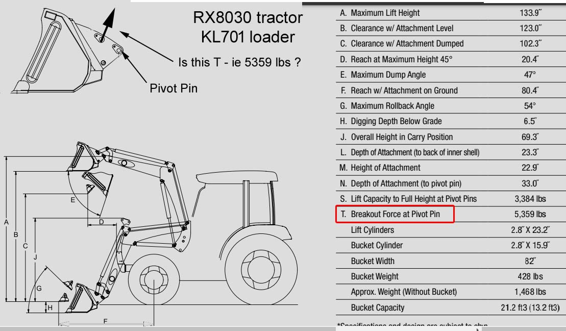

Lift is obviously how heavy of an object you can lift "at a particular location" with respect to the loader. Some (unscrupulous) companies will give that rated at the lower pivot point. That's beyond the back of the bucket (closer to the tractor) and the number is worthless. A better one is "bucket center" as that is where you will have a load. An even better one is to have it at 500mm forward of the bucket edge. That is where a chained on load like a large log is often located. Heck, I'd be happy if they would just certify how many pounds of heaped dirt can be picked up to full height!
While I agree the use of different measurement points is confusing to new buyers, I'd actually prefer to have the pivot point number to compare loaders. Yes, you will never actually lift anything directly at the pivot points but it tells you more about comparative loader lift than mid bucket especially if you are intending to use a grapple or forks for example. 500mm forward of pivot point (not bucket edge) is also useful for the same reason. Bucket sizes vary however so "mid bucket" lift just favors companies that put shallow buckets on the loader.
Given that we usually do not lift heavy loads to full height, what I'd really like to be able to compare is 1) max volume of gravel or dirt you could lift to full height as you pointed out and 2) max load you could lift to a traveling height, say 2ft off the ground. and 3) "breakout force". Again, it is more useful if that number reflects either pivot pins or 500mm unless you intend only to use the stock bucket.
Regarding the initial question: what is breakout force?....I have always thought it was the combined max force generated by using both lift and curl cylinders simultaneously when the bucket/grapple is on the ground. That is somewhat different (higher) than just curl force at front lip of the bucket.
If one were to look up the technical specs on how breakout force was measured, one wouldn't have to think about it.... ;). By the way, I didn't specify which cylinders were used to generate the upward force at the bucket lip.
SAE J732 is written for larger wheel and track loaders, but should also apply to skid steers and compact track loaders. Breakout force is one of the specifications defined, and here is how it is measured;
1. Loader on hard surface, transmission in neutral
2. All brakes released
3. Unit at standard operating weight, rear of loader not tied down
4. Bottom of cutting edge parallel to ground, no more than .75" above the ground
5. If tilt circuit is used, bucket hinge pin must be specified as pivot point, and lift arms should be blocked under bucked hinge pin to minimize linkage movement.
6. If lift circuit is used, pivot point should be specified as lift arm hinge pin, and front axle should be blocked to minimize tire deflection.
7. If both circuits are used, the dominating pivot point must be specified.
8. If the circuit causes the rear of the machine to leave the ground, the force required to lift the rear of the machine is the breakout force.
This is all listed in the Caterpillar Performance Handbook in the wheel loaders section. In the skid steer section, both lift and tilt breakout forces are listed separately. SCUT, CUT and even UT's often don't list which break out is published and some even fail to follow the specs exactly -- resulting in what I call "marketing numbers" that have little to do with what the machine can do.
Your comment on the lift being affected by the size of the bucket is valid, but the manufacturer should list lift and breakout for each bucket as it it part of the spec. Personally, I only want to know how much the machine I'm on with bucket that it has attached can lift. The pivot point number fails to give me a feel for that as it can be hugely different. But, that's just me, YMMV.
There you go ruining a perfectly good TBN thread with data. We could have dragged this out for days.
I understand your point about individual buckets but the manufacturers don't make it easy to find out which bucket they used. I fully appreciate that we don't lift things by the pivot pins but it is at least an easily understood reference point. Actual lift capacity precision is probably not all that useful anyway as our loads are difficult to precisely quantify so for me it is the comparison of one loader to another that is most useful. As few loaders share the same bucket, either the pivot pins or 500mm measurement seems easiest to use.
