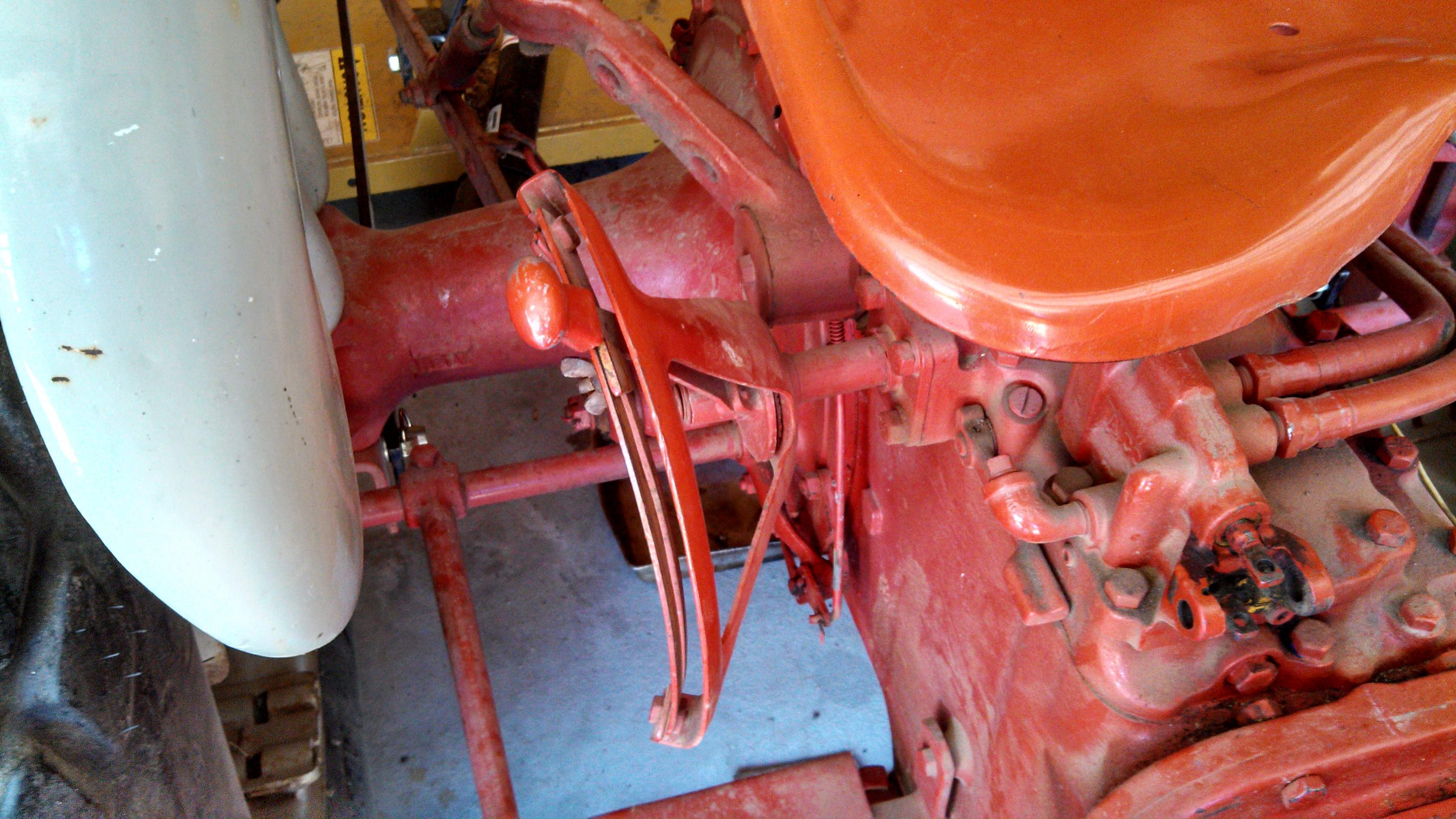

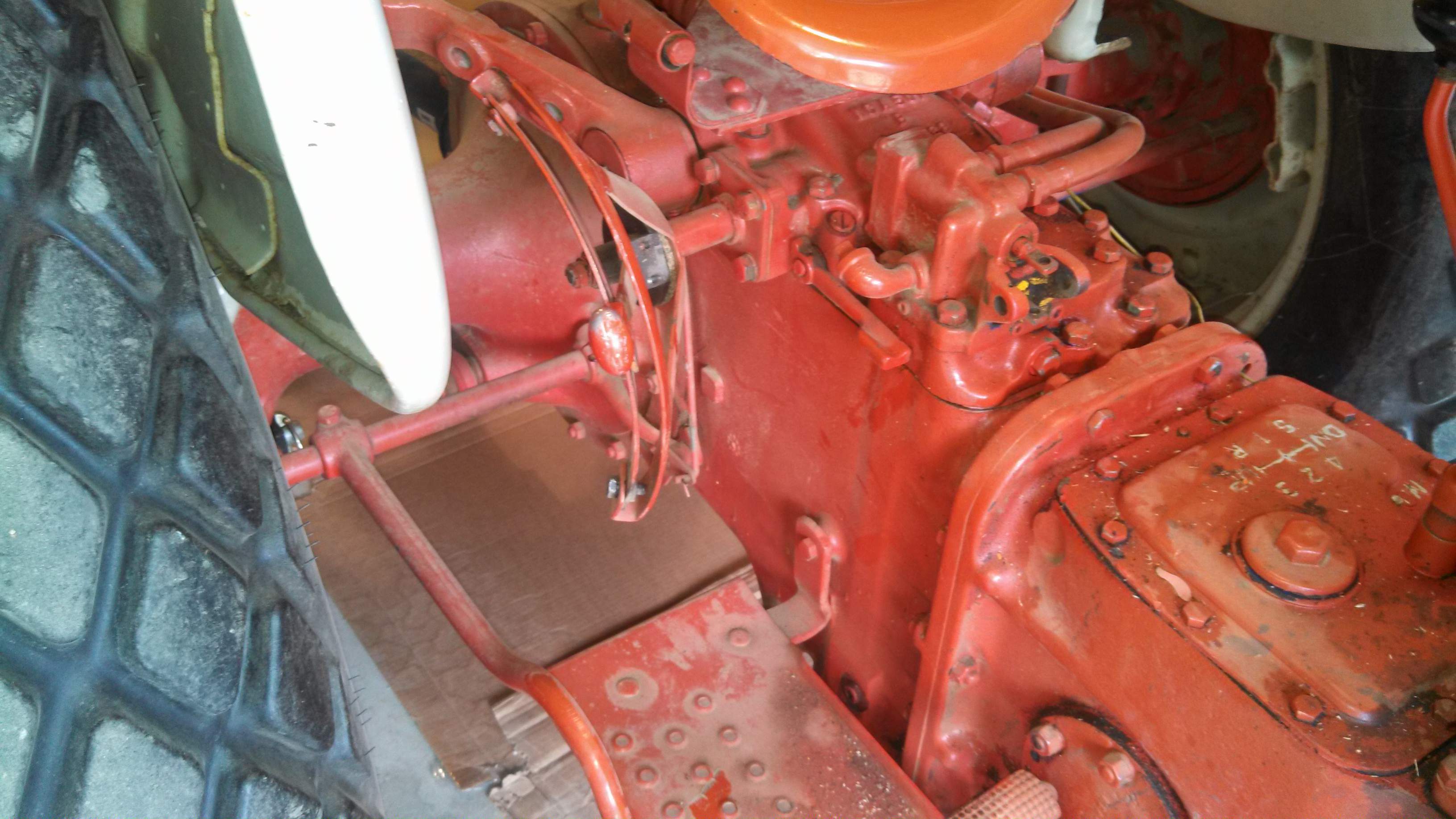

Thought I would tie this thread out for future searches.
I adjusted the position control with the touch control lever touching the lower bolt that holds the quadrant together.
Put everything back together and the resolution is wonderful! The arms move when you move the touch control. Very responsive!

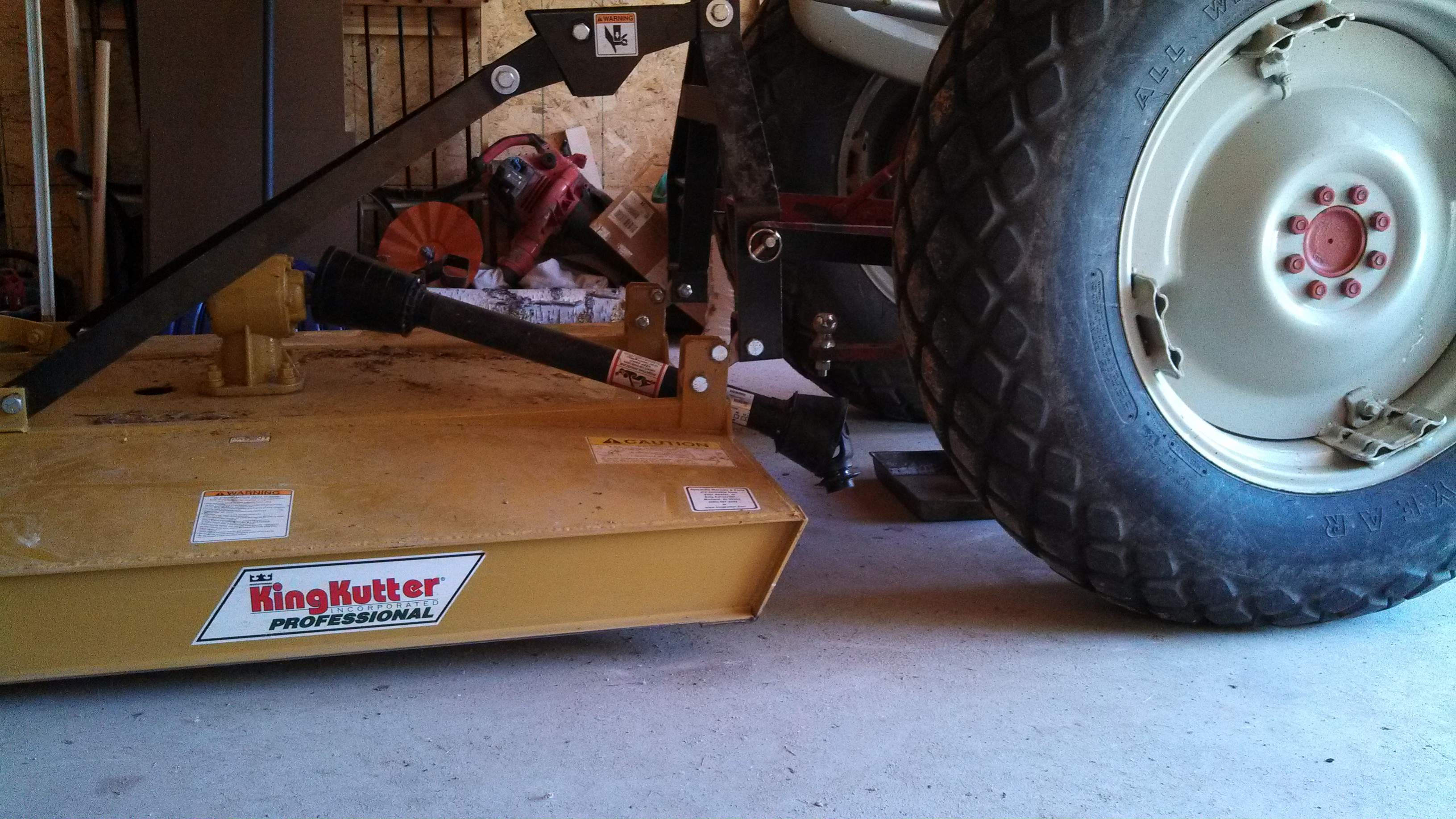

Below is a picture I posted on another forum, before the repair. Note the position of the mower in relation to the touch control.
And here is how it looks after the pin replacement and adjustment.
Thanks to all for their input and great ideas. The old girl is working pretty good now!
