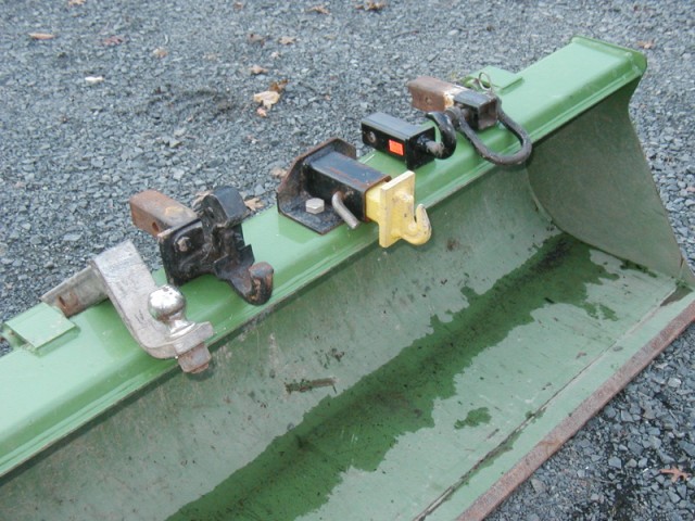

Here's what I came up with, I too wanted to have some extra lifting options with the 1200 or so pounds of lift capacity my 300cx was capable of. I bought the weld on chain hooks and was ready to go (was uncomfortable with grinding that new paint as Larry said) but started thinking that since the 300cx had a limited lift capacity, 3/8" chain was a little over kill and that nylon web slings would be better for what I would be doing. this is the result, I call it the bucket buddy, sure comes in handy for my needs. I did use one of the hooks but haven't tried it yet, the ball hitch and pintle get alot of use, was thinking about starting a new thread on my little invention (as far as I know it's different than anything I've seen) but figured I'd throw out here first. J.B.

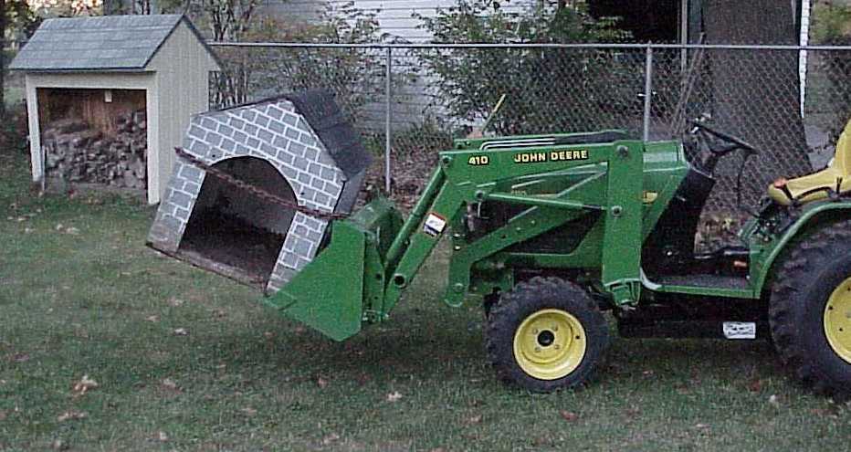

   / Lift Hooks On A 200CX #15
</font><font color="blue" class="small">( So what are the hooks on top of the loader used for? )</font>
They are for carrying houses.
Cliff

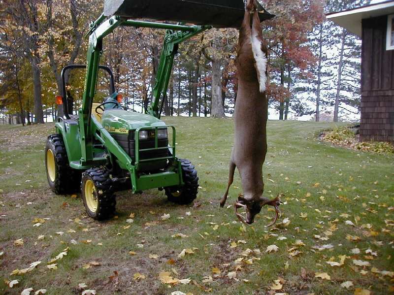

Lots of uses as you see.

That last pic didn't show the hook at all, but just what was hanging on it. Here is another showing the hook. Works great for skinning and initial cut-up, being able to vary the working height.
