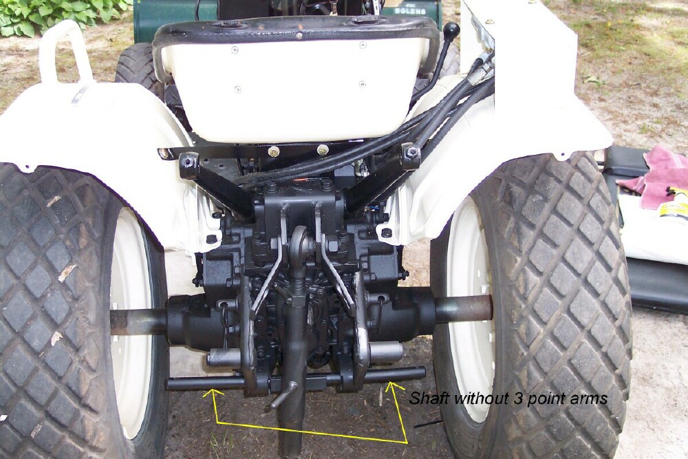

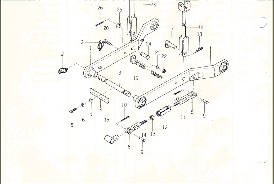

Just as a follow up here are a few pictures of what I think you were talking about.

in your breakdown ,what I was referring to was #4,5,6,7 in the parts , I appreciate your interest .
/ Lifting Arms on H1502 #5
I believe when everything is assembled correctly item #4 shouldn't
come in contact with anything to put pressure on it to break the bolt.
How much side to side movement do you have.

/ Lifting Arms on H1502 #8
If part #4 is not there what stops the bar (#3) from sliding from side to side?
If everthing shown in the first picture is assembled correctly
there is very little side to side movement. If you remove everything
like in the 2nd picture then the shaft can and will slide out into
one of the tires. On my tractor you can't remove that
shaft without removing one of the tire/wheel assemblies.

I think as long as you have your lift arms on and the corresponding hitch pins and sway chains you can remove the centering bar (part #4 in the diagram shown previously). I have problems with mine also but it's not that the bolt breaks, more that the centering bar bends. You might also want to consider installing collars instead of the centering bar like shown here to eliminate the problems associated with it:

The shaft is the anchor rod which is long enough to support both lift arms , spacer with spring clips on both sides to lock them on .
/ Lifting Arms on H1502 #14
After looking for a picture of the three point assembled, I see that that length is needed. As above you might be better off using a bearing lock ring on each side.
