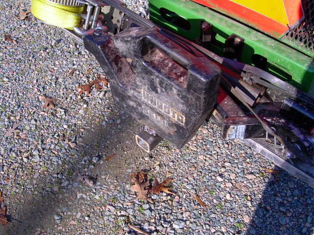

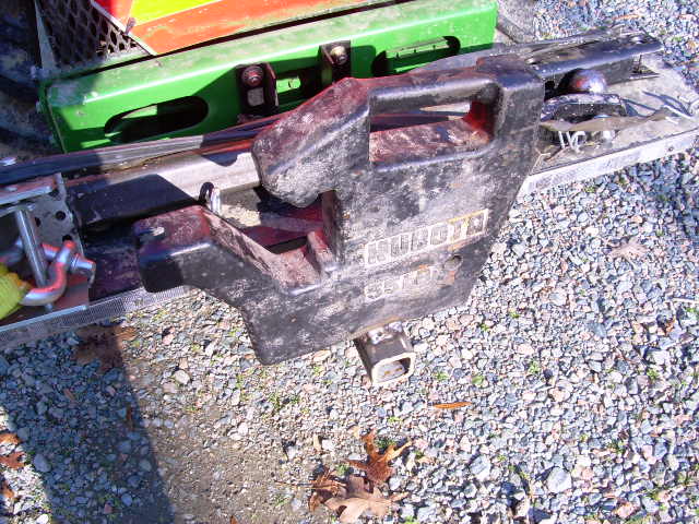

I got the 422 stuck this weekend. I was moving some very wet clay and ended up in the mud and parallel to it. Going either direction did not help. I had the back end far enough into the mud so that I could not easily get the weights off to connect the tow strap. I ended up wrapping my tow strap around the 2 inch receiver tube and the cast iron weight, kinda wedging itself between the two. I put just about everything the 4000 pound boat whinch would do on it and then got back in and backed up a little. I got out and retightened the strap and repeated. It took about three tries to get loose. Today I welded a connection point for the strap to the back of the weight assembly (no cast iron was killed during this welding).

I got the 422 stuck this weekend. I ended up wrapping my tow strap around the 2 inch receiver tube and the cast iron weight, kinda wedging itself between the two. I put just about everything the 4000 pound boat whinch would do on it and then got back in and backed up a little. I got out and retightened the strap and repeated. It took about three tries to get loose. Today I welded a connection point for the strap to the back of the weight assembly (no cast iron was killed during this welding).
Attached are pictures of the tow connection on the back of the weight assembly. I now have two weights. The back one sits on a shelf and is bolted to the front one.
