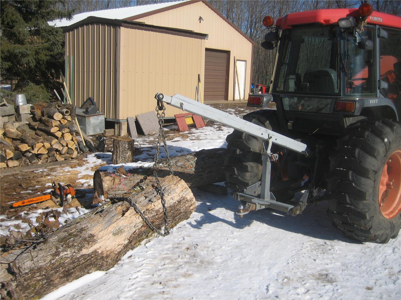

I saved this picture in my projects file. It came from Omni Mfg, when I bought their Transformer 3 point hitch.

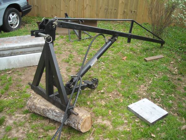

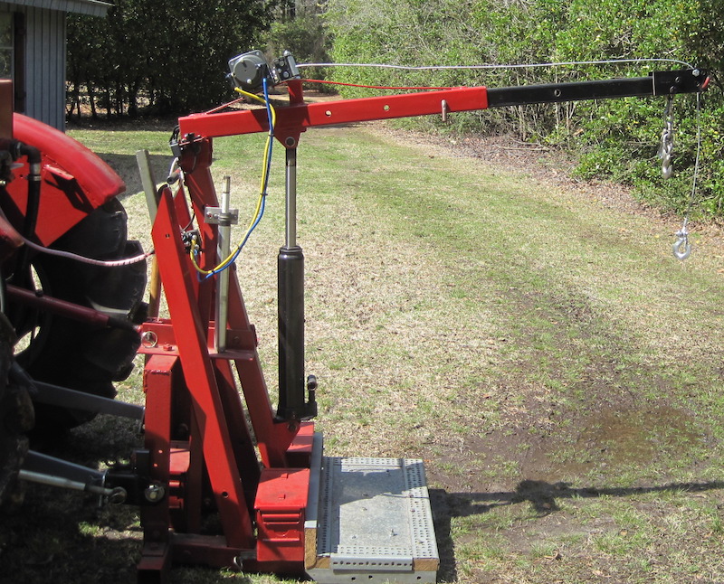

And a hydraulic one:
What are you wanting to build?

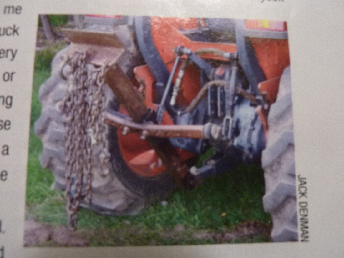

Here is an other way to do it - might spawn an idea. I haven't thought it all the way thru but maybe if you had a fork on the end of the lift bar like lower lift arms and you used a normal top link but longer you could get more lift for your mower with a simple mechanism
gg

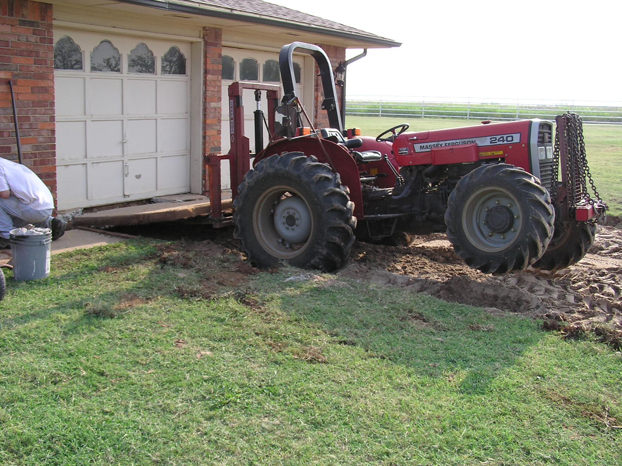

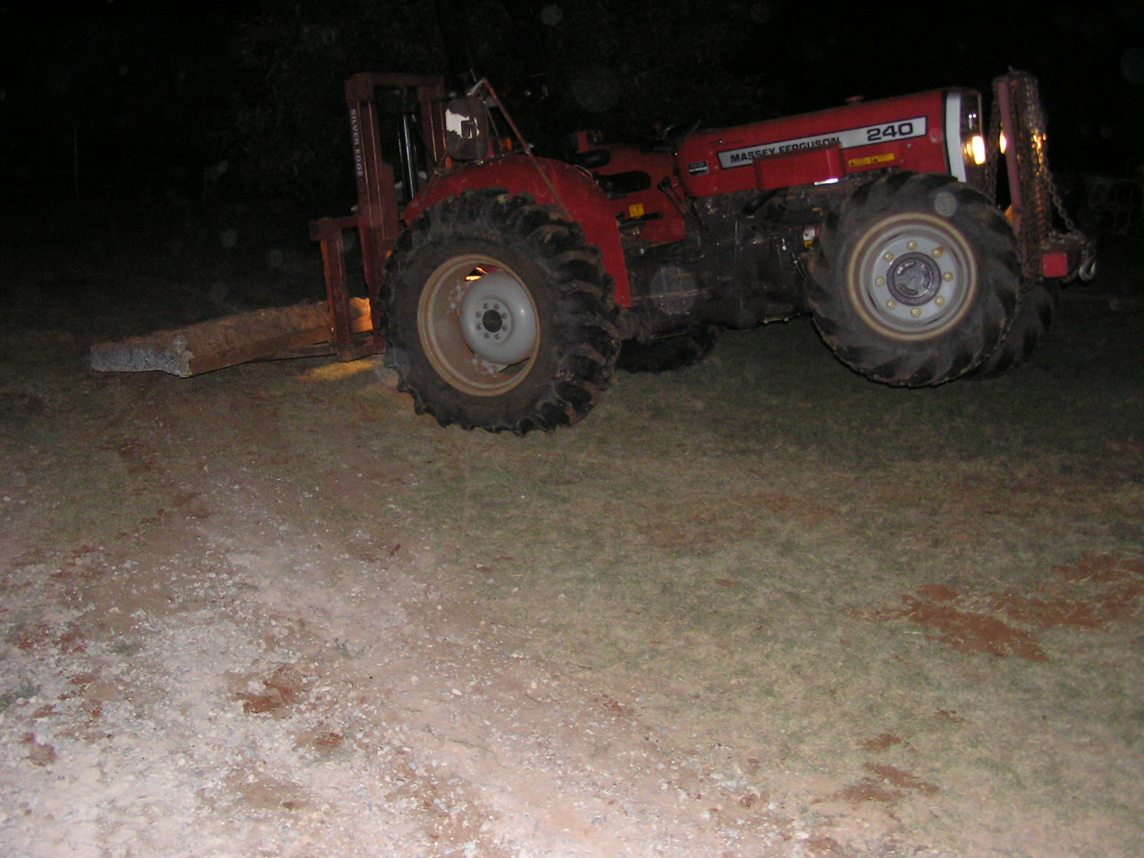

... and another one. Modified engine lift.

Since you are new here and probably don't know to click "Reply With Quote", I will guess you mean me, cause I am the one that posted three pictures.
Here is the first one again and one with adjustable lift holes:
From an image search.
/ Lifting hitch??? #8
The biggest problem with something like that is going to be pulling the front end off the ground. It’s a long lever so it’ll raise slow so rollover isn’t likely but it’s still not very useful if the front end is off the ground.
/ Lifting hitch??? #9
The biggest problem with something like that is going to be pulling the front end off the ground. It痴 a long lever so it値l raise slow so rollover isn稚 likely but it痴 still not very useful if the front end is off the ground.
That is what steering brakes are for :D.
