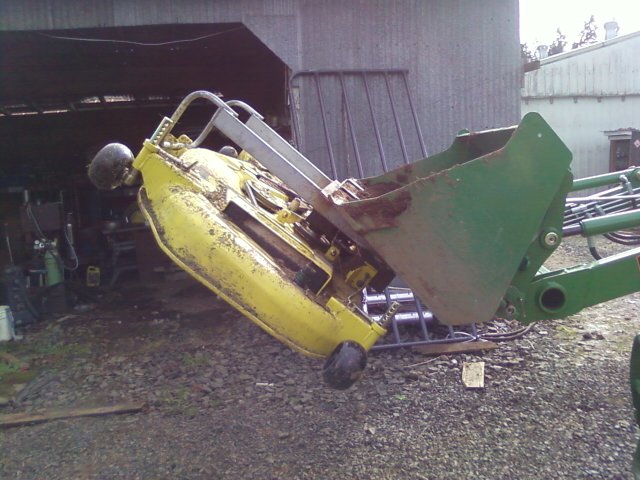

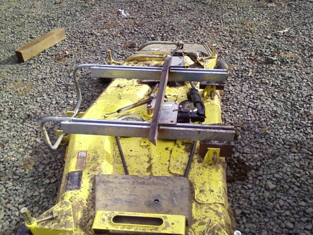

Here is my solution: I use it for both moving the mower and working on it. Very solid. Made from stuff from the scrap pile. It uses the same mounting points as the mower. I like the fact that I can tilt the deck. ... except down.
