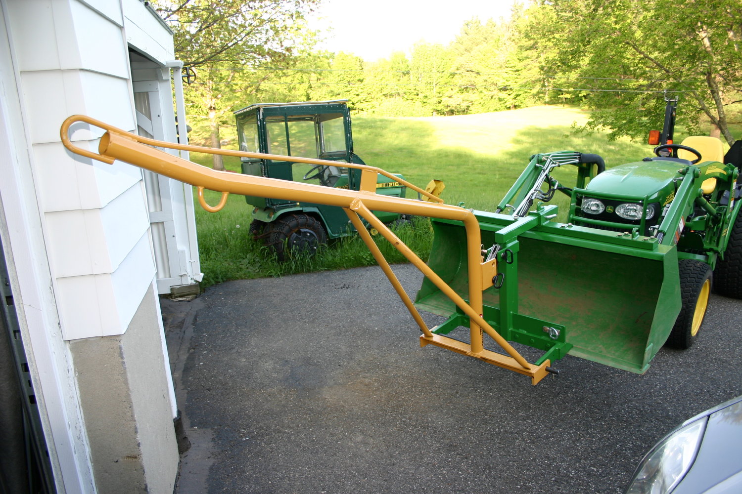

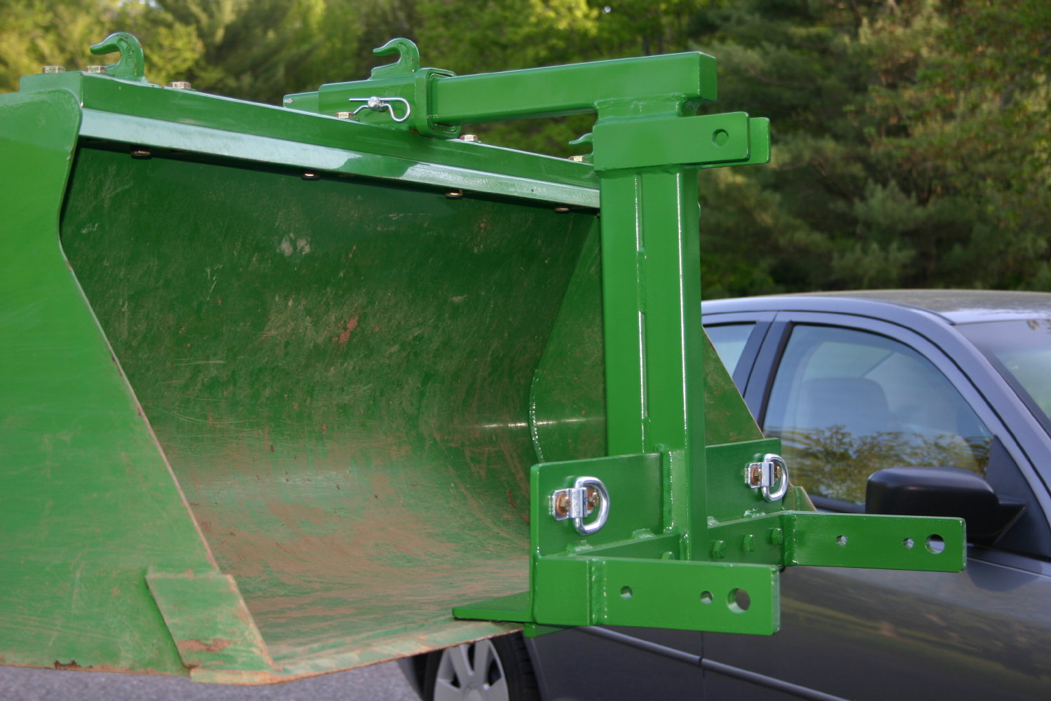

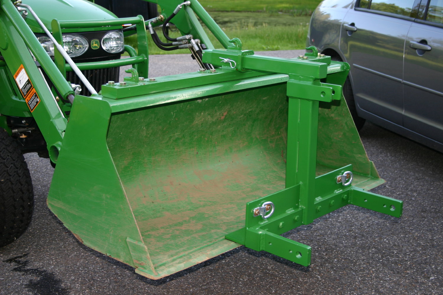

Hi Everyone,
I took a slightly different path to the same problem and built a bracket that attaches to the loader on my 2520 via the hitch mount on the bucket.
The 2 arms in front pick up the lift brackets n the 62D mower. They also are very close to the normal Cat 1 3 point hitch dimensions so I made an adapter kit to instal 3 point items on the front as well (see the picture of the boom pole for light loads).
I like it so far.

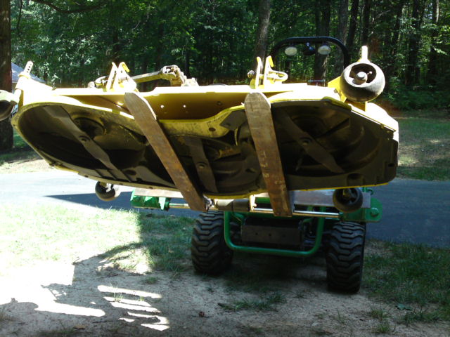

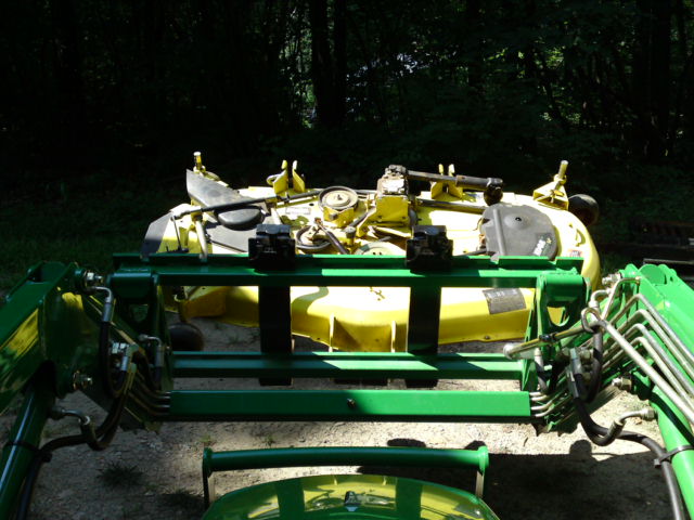

Here's how I used to manage my 54C deck. I just set the fork frame on a couple of 30" 2X4's that I keep around for working on things being held up by the forks.

Yeah, but you're still working under the tractor for all intents and purposes...

No, this would be standing next to the deck with it around waist height or a little higher. And with the legs inserted, it is as solid as a saw horse.
