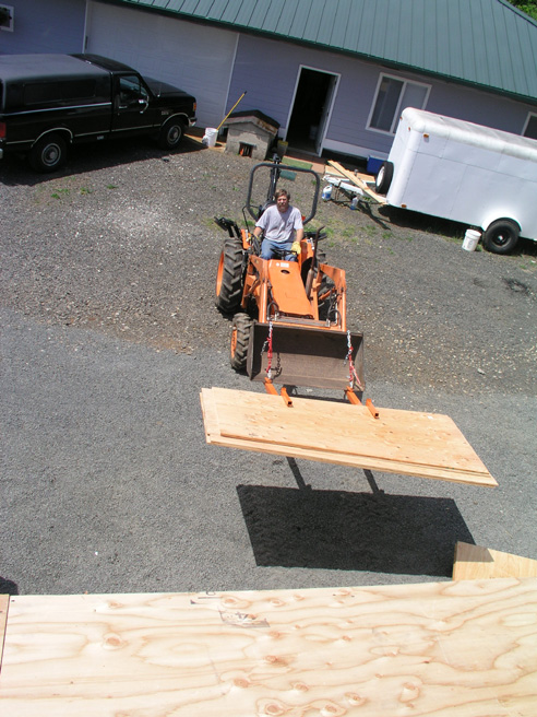

Gerard, here are some pictures of something I built to get some sheets of plywood to the roof of my house. These were built similar to yours except mine were built (2" X 2" square tubing, 3/32" wall) to slide over some some forks that were built out of 1 1/2" X 1 1/2" (1/4" wall) steel that is held in place by chain and binders. By loading the plywood on length-wise I am able to get it to the roof of a second floor building. Doug

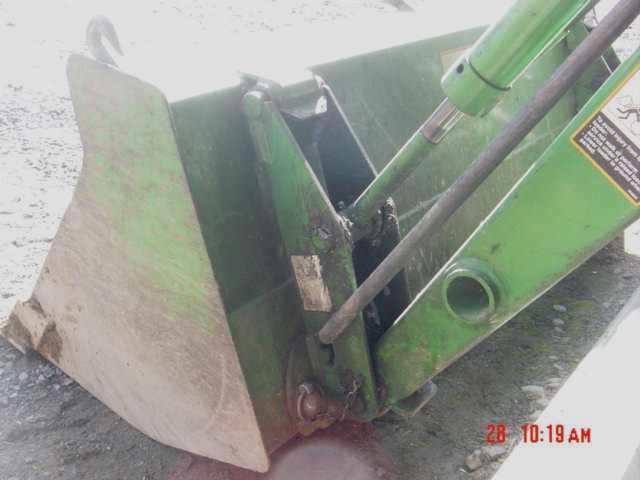

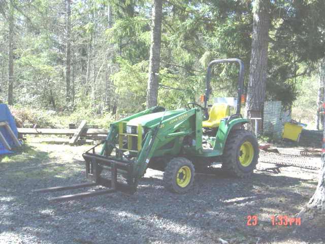

Here is a set of forks I built for my JD. The quick release system for the bucket makes it real easy to switch to them. ;)

shield arc - quick release is on my "must have" list for my next tractor. If I had that I'd have a set of real forks!!

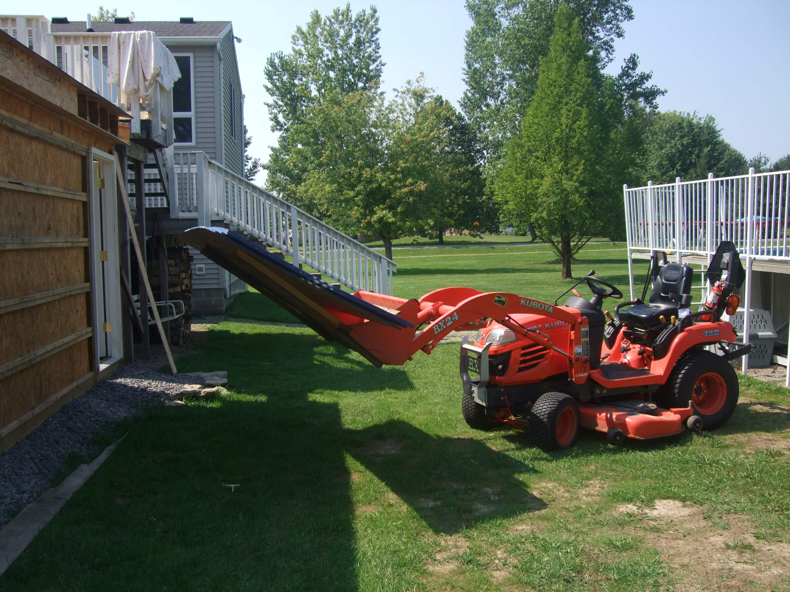

here's mine . i used couple 2X4's screwed together to lift osb to the roof

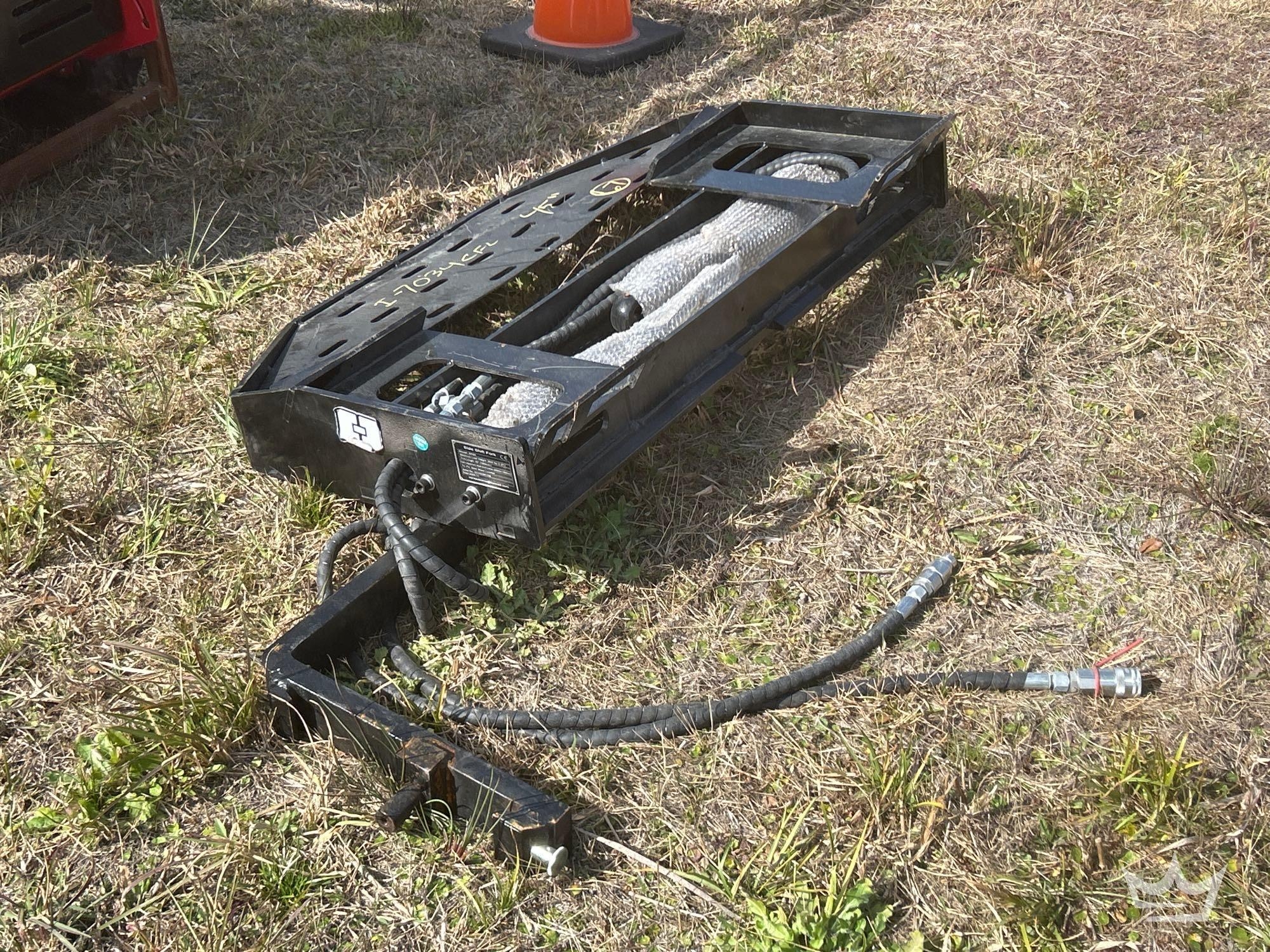

Hi gerard!
I have a good friend that has a Kubota; I've been begging him to let me convert his bucket to a quick release system! Shouldn't be too difficult.;)
