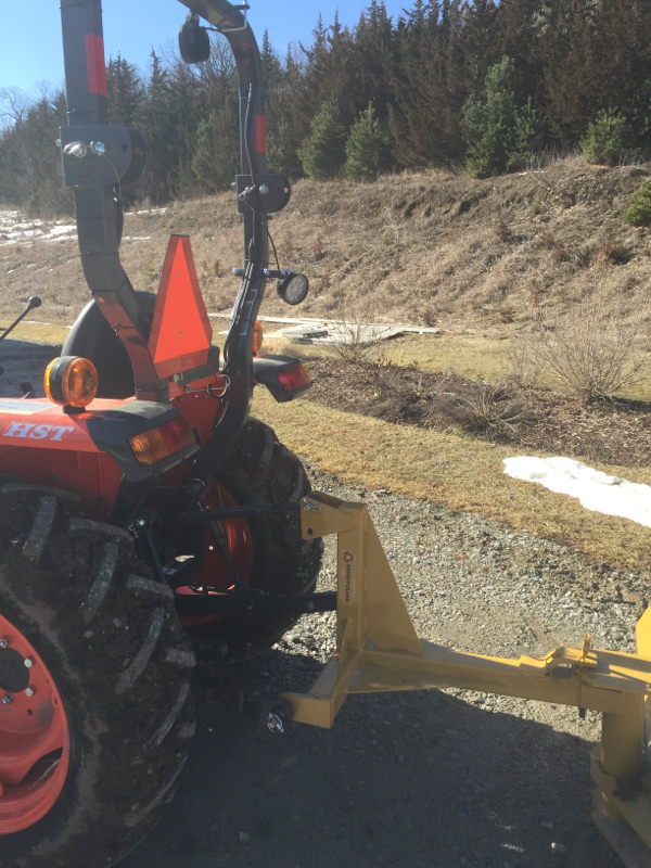

Does anyone have a recommendation for a lighting kit for a Kubota L3901. I will be running a reverse 3 pt. snow blower and want some better illumination in the back... as well as the front. What do you all run?

These are the kitty kats meow. I put a pair on my roll bar facing forward and tied them into the headlight circuit and added an on/off switch. When I turn on the headlights at night, I can switch these on or off and they light up good enough to run a finishing mower after dark. Very bright. Lots on here have these same lights.
   / Light kit for Kubota L3901 #3
Kubota runs power/ground 10A work light circuit wiring to the left rear fender that you can tap into and install any lights you want. Most of us use LED floods -- very easy to come by and prices have come way down.
The front-facing lights can be mounted to the ROPS with no fuss -- you can take advantage of the threaded nut welded to the front of the ROPS near the hinge on each side (it's a metric thread, I forget which). I imagine you could mount rears too, if you make a bracket. I mounted my single rear light to the bracket for the slow-moving-vehicle triangle.

I u-bolted a bar to my ROPS with some pucks underneath for spacers. Drilled into that & put in 4 LEDS (2 fwd, 2 back). Ran wire up to the dash, Drilled a hole for a switch & tapped into the auxiliary fuse. Maybe 2 hours of easy work.

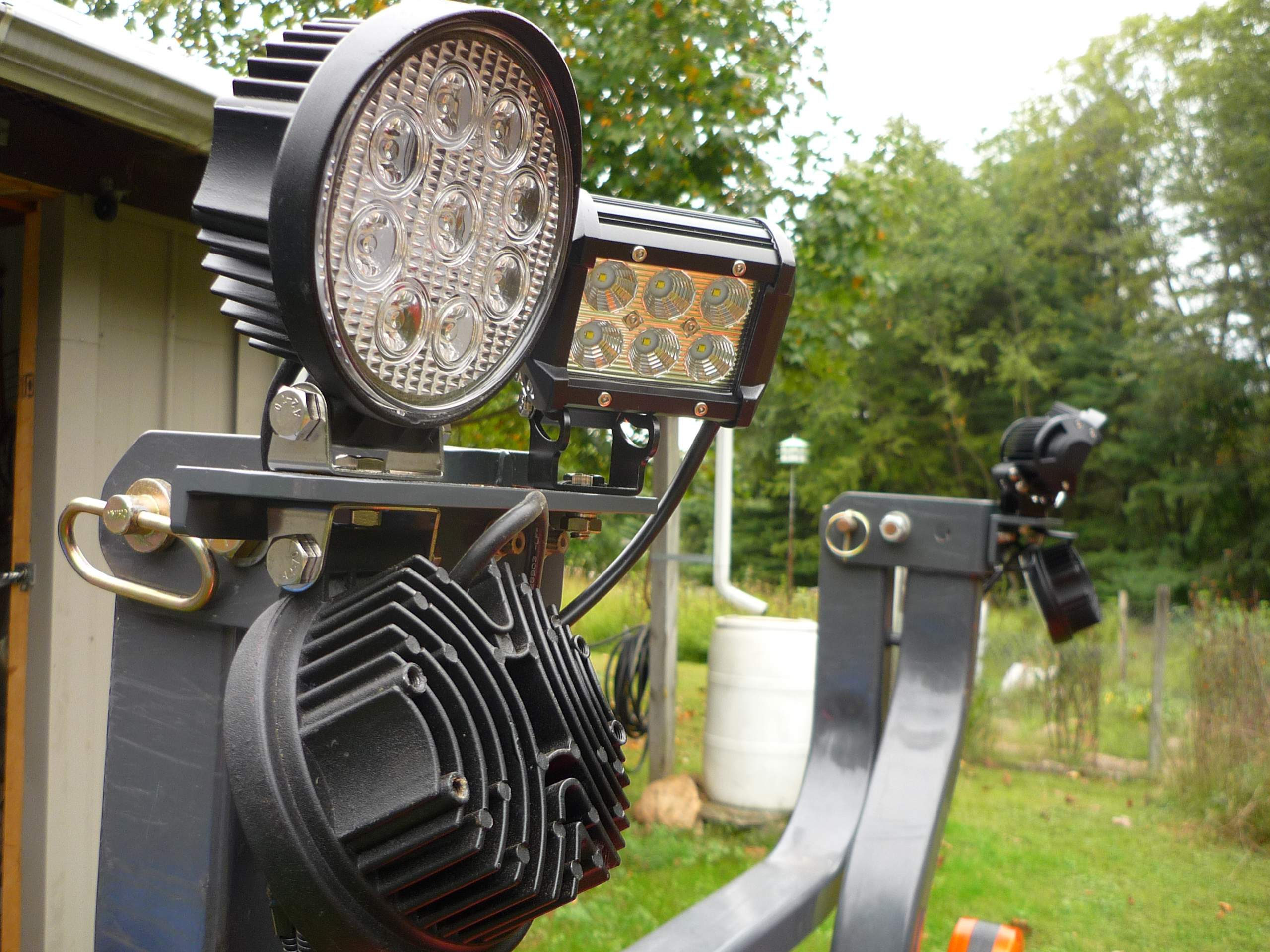

I ordered this light kit. Came with three lights and all cabling and ties with the appropriate connection for the L3901. Probably paid more than I needed to but it was easy to install and looks professional. In winter when moving snow at night or early am it lights the whole work area extremely well. Have not tried this summer at night.

ropslights.com is where I ordered them from.
