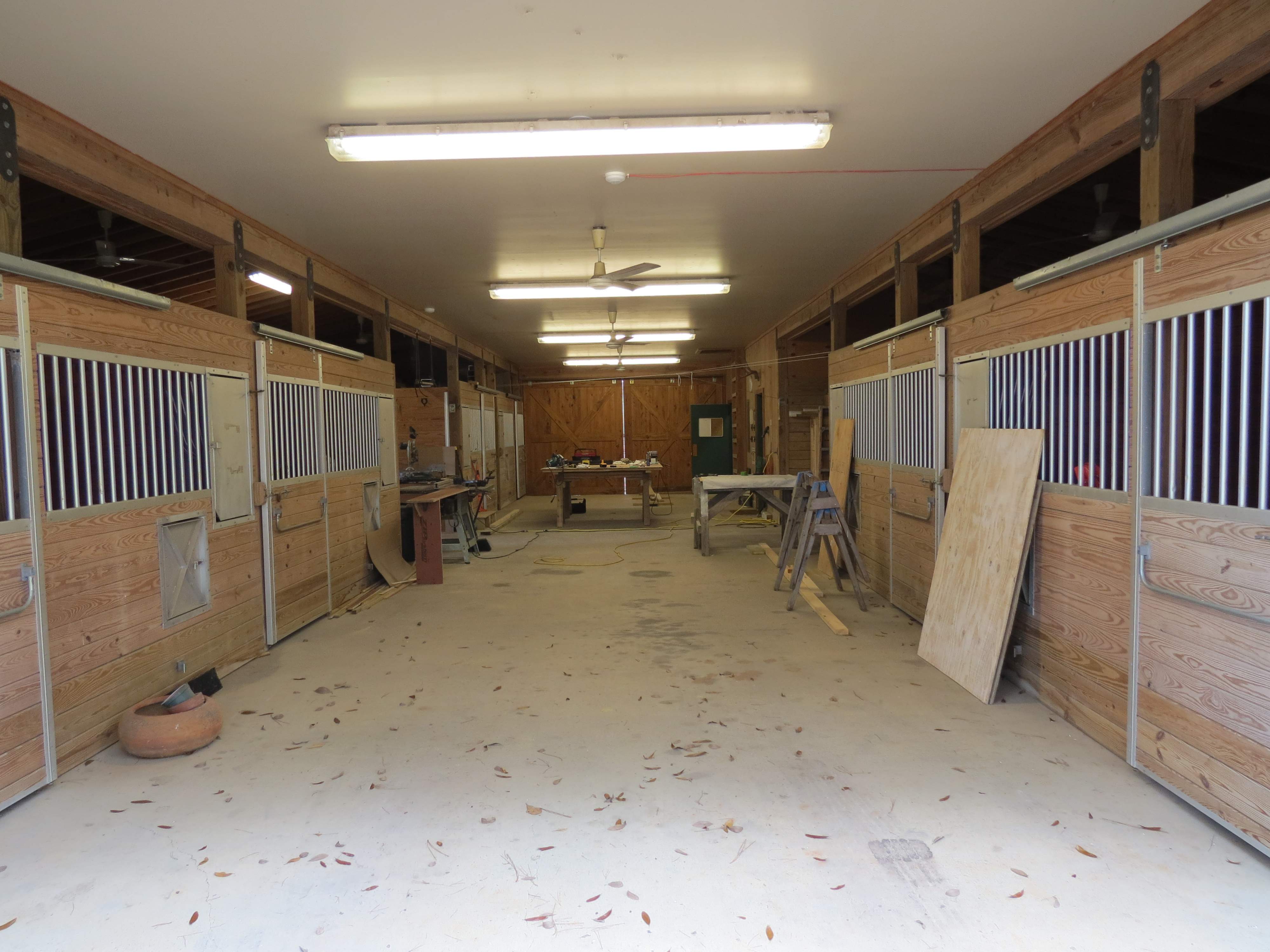

Here is mine at night. The barn is 36'X48" with 4 fixtures on each side of the aisle. Each fixture has 4 4' bulbs. Each side is on a separate switch with switch panels at each end. The doors are 10' tall so the lights are at 12'.

we have one 2 bulb 4' fluorescent light per stall and our 14' x 50' center aisle has 4- 2 bulb 8' fluorescent fixtures all fixtures are of damproof design. This provides us adequate light for most tasks.

For the central barn, i personally would use Three (3) 8 foot T8 tandem fixtures (each light uses 4 - 4' long lamps. Use at minimum a 4,100K lamp for cool white lighting as this seems to be the best look in a barn. I have also used 5,000K and 6,500K lamps for REAL bright (almost bluish white) lights for clients that want it superbright. Spaced 2 feet from wall to 1st light. then 4 feet between fixtures.
