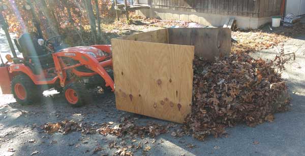

My leaf bucket is built of plywood and sits on the pallet forks.
For chips could put a metal cutting edge the base.
For moving chips I would use the standard bucket to load it then swap to forks to move it.

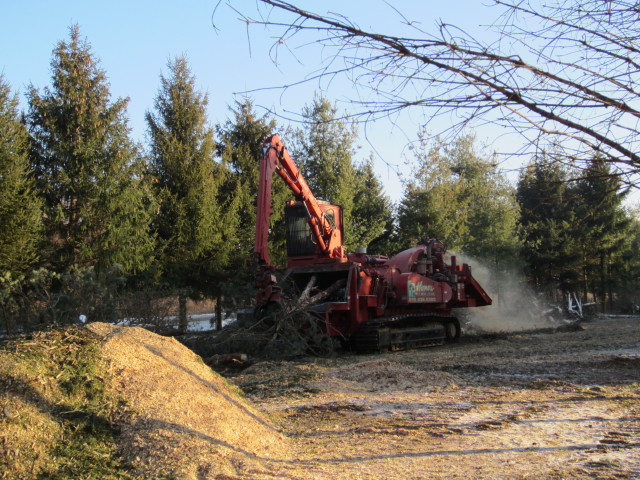

I had 1800 evergreens cut and chipped on the property (tree every 7 feet). I spread the chips out evenly at a depth of about 6" over the 5 acre area where the trees had been. After one year, I'm thinking that once the chips decay, it won't add much volume to the ground.
as light as they are, I'd build two of these and use one on the rear too. Easy enough to make the rear one a dump box.
