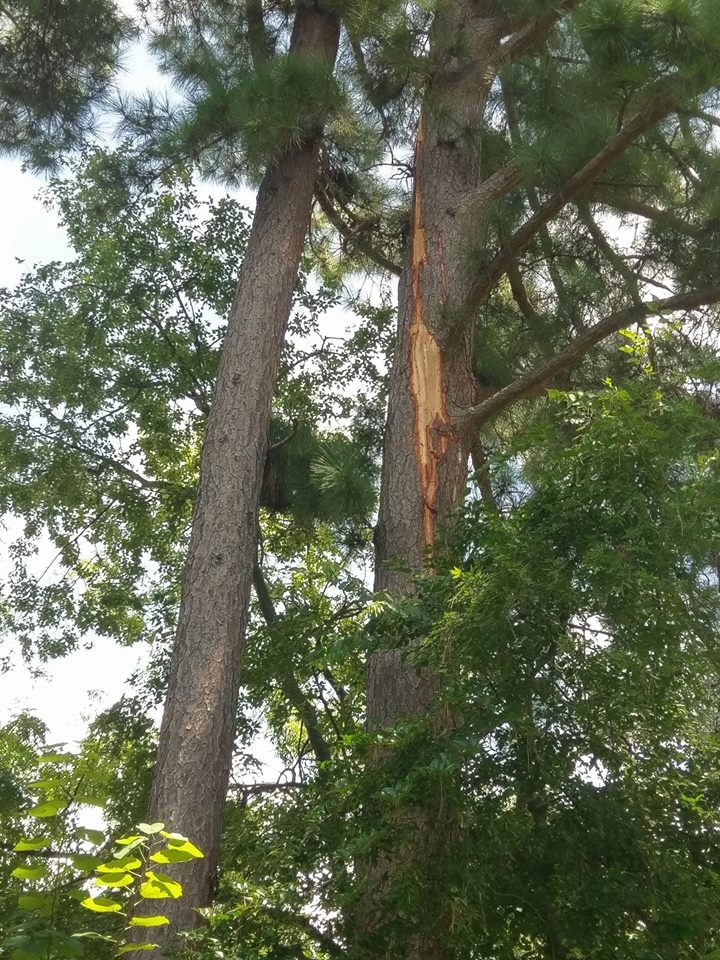

Client of mine in the city of Tyler was at work when a storm came through and her pine trees where struck. It cut a strip through the bark of tree up high, wound its way around, jumped to other trees and then hit her lawn. She came home to no electronics in her house. TV, computer, phone, appliances and just about everything else plugged into an outlet where all fried. A buddy of mine who is a Master Electrician came out and looked over the wiring. Half a dozen breakers where ruined, but he couldn't find any damaged wiring. He thinks the electricity traveled across the wet grass 50 feet to her natural gas pipe, and came into the house there. Then it found her ground wire, and entered her breaker box. The burn marks in the box are all off of the main ground wire.

I wasn't clear. My clients house was about 50 feet away from the tree that was struck by the lightning. There was rain and the grass was wet. The electrician who came out to fix the damage said that he thinks the electricity from the strike came into the house from the metal natural gas pipeline, and then along the ground wire into the electrical panel.
After I posted this picture on Facebook, friends commented that they heard it hit and thought it was a lot closer to where they where when it happened. One was a realtor showing a house about a mile away from where it hit. He was surprised at how far away he was, and how loud it was.
That's certainly a possibility and if true it means the lightning strike has very likely burned a hole through the insulation on the natural gas pipe. I can't see it not doing so. Sooner or later corrosion will make a hole through the pipe and a gas leak will occur. If that happens the gas will migrate along the trench (because the top few inches of fill tends to get compacted much more than the fill around the pipe) and it's highly likely it will make it to the house and either come up around the riser or if there's a crack in the basement right there or close by, it can leak through the crack into the basement.
