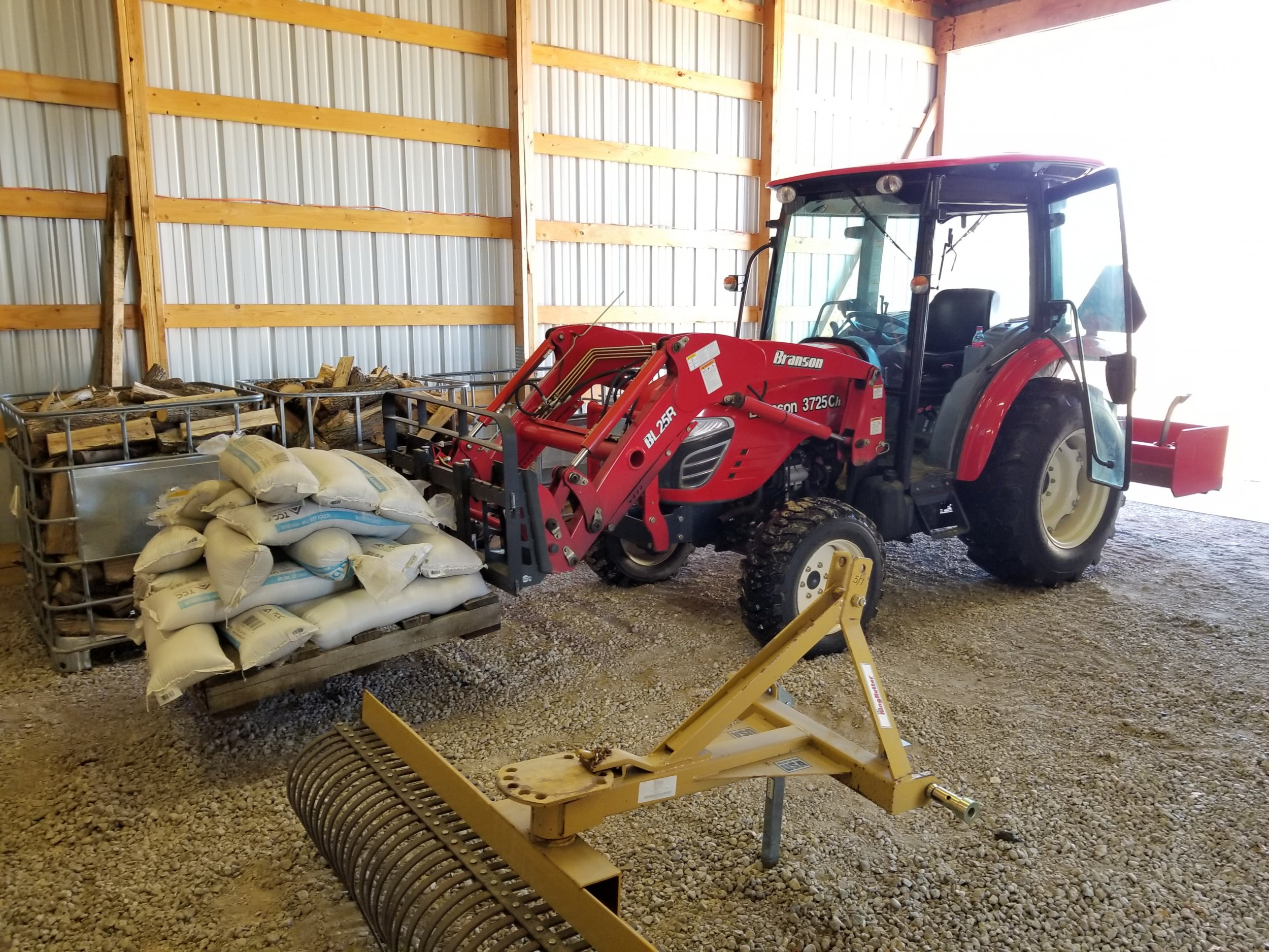

   / Lightest Weight SSQA Forks #7
   / Lightest Weight SSQA Forks #8
Those look perfect for a BX.
