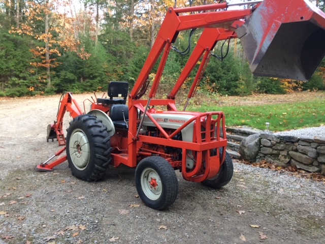

Here's a picture, My Be get some wheels turning!:scratchchin:

Nice looking 821. Cant show you an example, but mounting lights up high on the loader crossbar just in front of the steering wheel will be in a useable position. Any lower mounting and the bucket will block them when in a safe low position to drive around.
   / Lighting upgrades,show them off please! #4
1/4" hole in loader frame and mount lights on outside lighting up bucket corners.
