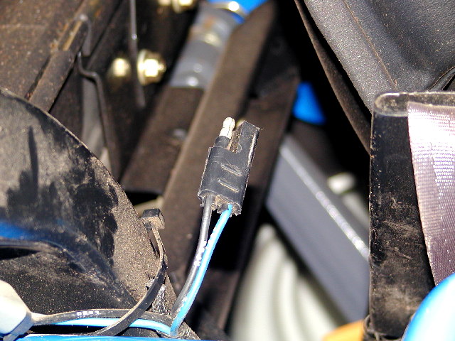

I also have a TC25D. The pigtail for the work light (the description of the fuse panel in the owners manual refers to one of the fuses controlling the worklight, among other devices) was sticking out of a grommet on the inside of the right hand fender. (See attachment) It's hot when the ignition is on. I used this to power my rear flood lights (See Saturday Project in Tractor Customization)
In addition to the rear work lights, I also installed lights on the ROPS for FEL work. Pictures can be seen in the Mo' Lights thread in Tractor Customiztion forum.

Thanks alot Mike. I figured the harness was sitting out there somewhere. I didn't want to tear the tractor apart to follow the wire. You saved me several hours. Thanks again. Have a great Thanksgiving, Mike
   / Lighting #45
You're welcome! I looked around for a connector to match the one in the picture and couldn't find one. I ended up cutting the factory connector off and just using butt connectors to connect my backup flood lights.

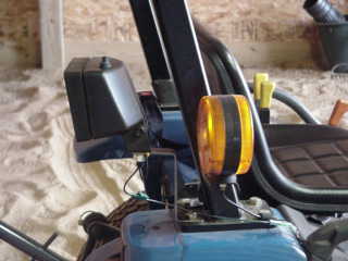

I did get it hooked up before winter 2000-2001. On my TC18, the hot wire stuck out from under the plastic behind the 3 pt. lever. I just added a common round connector and grounded it to the bolt of the mounting bracket. Works great, specially here in Michigan where it's dark by 5 p.m. when the snow starts flying.
JimBinMI

Forgot that I had taken some digital pics of the light, here goes posting.
JimBinMI

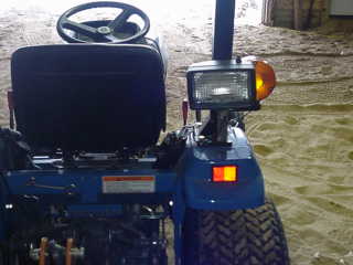

Here's one more from the back.
JimBinMI

I got the same light. I've found from the other replys that there is a harness already in back on the TC25-33. I'm trying to track down the connector which I will update on the thread once it happens. Thanks for the photos. Wish I had the sand in my barn. I'm on rock-hard clay. Happy Thanksgiving Talk later, Mike
