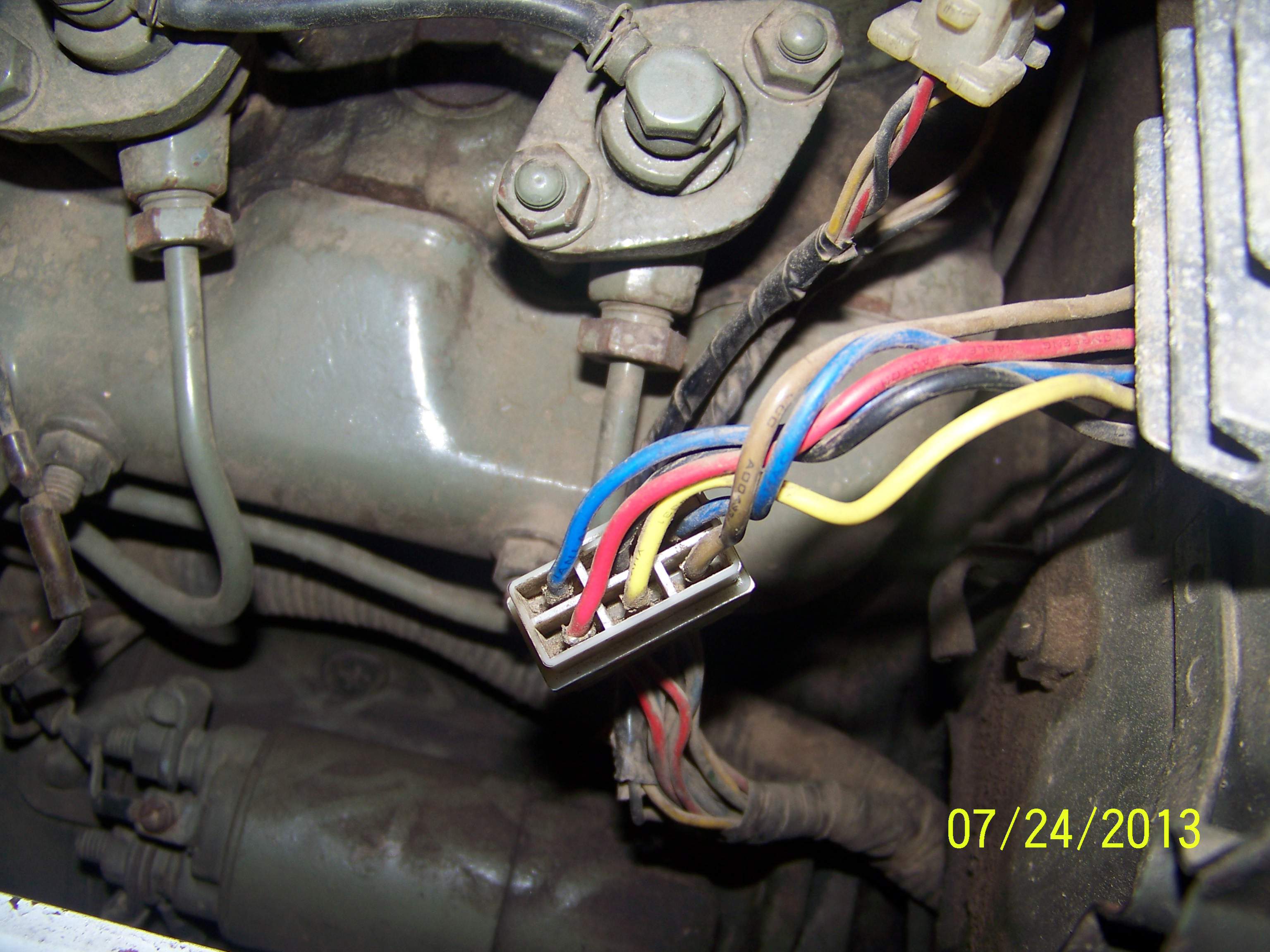

I don't want to be a naysayer but I have replaced my vr522 regulator twice on my 2002d. In my earlier post I stated you should get 13+dc volts out of the red and white wires coming out of your regulator. I think instead of white the wire is probably yellow. In any event if you stick your red test probe down in that plug to touch the wires it is the red one and the one right next to it. Naturally you would have your black test probe touching ground. Just to clarify I am posting a picture. I remove myself from all liability if you buy a new one and it doesn't solve your problem. :D I just know from personal experience these so called "no problem" regulators can go bad. I also know mine puts out 13+ volts on those two wires. :thumbsup:

Yep! it was the the yellow wire 10 amp. connection on the fuse panel. And sure enough CRS. so I had to go look. Were does it go? The Voltage Reg. :) I have a 520 Reg. yours should be a 522 but it looks to be wired the same looking at my YM2000 Dia.
/ Lightning Bolt Warning Light Problem - Redux #17
the red, yellow, and tan wires read the same, 12.4 volts. so it looks like i will have to replace the vr for the third time.
