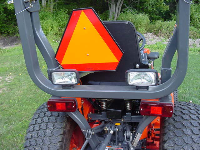

I added lights to my rops. Check it out.

Doc,
I bet those lights are handy.
So you added three 55 watt lights. Thats 3x55 watt or 165 watts. P=IV so at 12V you are pulling 13.75 Amps assuming you have all three lights in parallel. That would be a hot wire running to each lamp and directly connected to the blinker hot wire and a the other electode of each light grounded.
~14 amps is a healthy amount of current. I would do two things. Examaine the hot wire to the blinker that you tapped into and determine its diameter or gauge. You can determine the gauge from the wire diameter (copper part only) using the following link.
http://www.wiktel.com/standards/ampacit.htm
<A target="_blank" HREF=http://www.teicontrols.com/ampacity.html>http://www.teicontrols.com/ampacity.html</A>
These charts simplfy the issue since it depends on tempertaure, wire length, thermal cooling or insulation effects of conduit, etc.. But this gives you a good idea of what to expect.
If you find you are close to the max rating of the wire I would pull a new wire.
Also I would trace it back and find out which fuse it is connected to. Again if your close to the rating I would add a new fuse maybe a 15 watt slow blow. An inline would be easy to add.
my two cents.
Fred

Also the primary reason for use of a relay is to divorce the primary existing switch from the added current of the accessory. Lamp loads are about the worst in terms of contact stress, be it a relay contact or switch contact. The inrush current to an incandescant lamp is easily 10 times the steady state current. For a 50 watt light the inrush current is ~ 40Amps. It's a lot cheaper to replace an added switch or relay than the tractor main switch.

Cchoate,
Nice looking installation, Very professional! (smile)

Cchoate,
Where did you get those lights???
I really like the mounting brackets.
