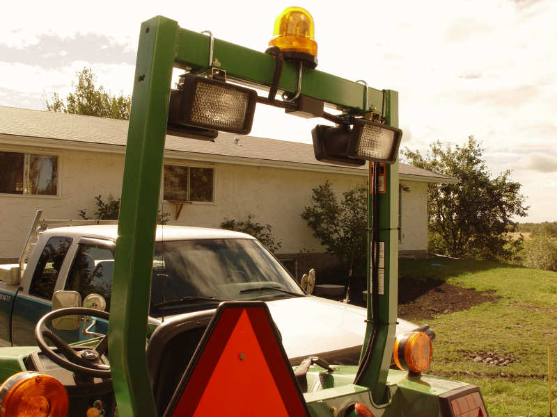

Lights, Lights, Lights. Never enough on a tractor it seems, so I added more. This is the source of their power.
I attached a fused, heavy gauge wire to the main battery cable post on the starter (orange wire). From here on
I ran all the wires in that black wire protector stuff so it looks more factory.

Attaching the actual lights to the ROPS took some thought. Way too much thought actually. I went through a hundred
designs in my head, involving the creation of all sorts of fancy brackets, custom fitted hanger bars, etc, etc.
In the end a simple piece of flat bar with 4 holes in it and ordinary U bolts from the hardware store solved the
problem.

   / Lights on a 990
I also added a rotating yellow beacon for those dark winter evenings plowing snow where I have to go on the road a bit.
This picture also shows the switch box I made. 3 single pole switches to switch power to the beacon, the front lights,
and the rear lights. The box also serves as a connection point for all the ground wires.

All the projects look really well done Brad. How many amps is your alternator? John
   / Lights on a 990
#12
I don't remember offhand the exact output, but the stock 990's alternator is pretty wimpy. Running all the lights will definitely exceed it's output, but I'm not too worried. I ran the front ones for a couple of hours tonight while moving some dirt and then checked the alternator to make sure it wasn't getting too hot. It wasn't even warm. I think the worst case is that I'll drain the battery some, but I can always top it up with a charger if necessary. I put an Optima in the tractor, so it should be able to take a bit more abuse than the stock battery.

don't take offense...but you know they make square u-bolts, right? i used the 2" ones to mount my lights to my ROPS, and they fit like they were made for it... /forums/images/graemlins/cool.gif
   / Lights on a 990
#14
No offense taken at all /forums/images/graemlins/smile.gif
Yes, I've seen square U bolts, but I didn't see any at the couple places I was shopping at, so I just got these. If I stumble across some, I'll replace the round ones because I agree it would look better.
