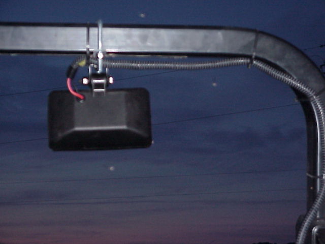

I'll try to get some better pictures later. This is how I mounted the light on top of my ROPS. It is actually centered. I went with a single light as that would keep me within the amp rating of the aux. light wire that NH provided. Since I'm not the fabricator that most of you are I took the easy way and used 2"X2" square u-bolts from TSC, fit the ROPS perfectly.

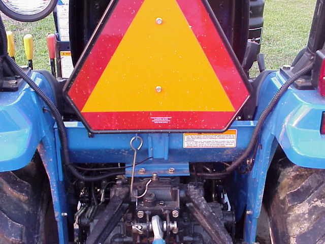

This is the wiring on back of the tractor going over to the rear worklight. You can also see the wire loom going up the side of the right fender up to the top light.

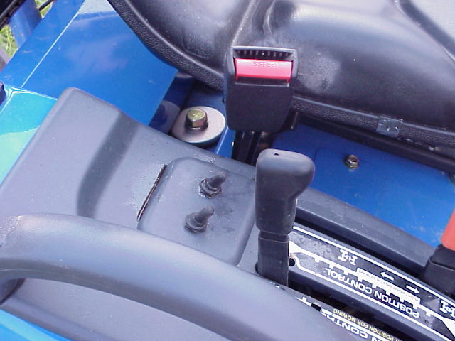

I mounted the switches on the plastic panel on the right fend by the 3PH controls and the 4WD selector. Everything is done with quick connect fittings so if something gets broken it won't be a big deal to swap out the broken piece. All in all probably 1 1/2 hours.

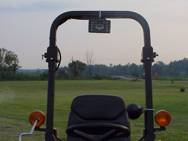

Sorry guys forgot to bring the pictures w/ me yesterday so I can't do an edit now w/ the better pictures. Here is a picture looking at the front of the lights.

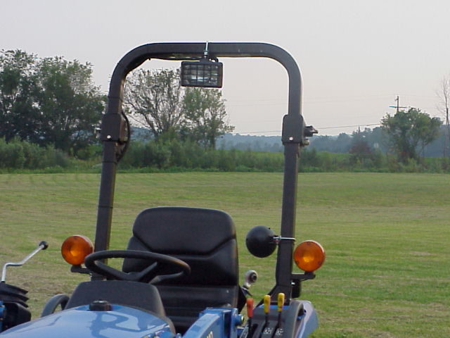

Another shot looking square on at the front.

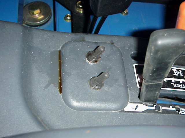

A better shot of the switches.

Now you can actually see the wiring at the back of the tractor and how I had to run it up both of the fenders and underneath the mounting bracket for the seat - hey it was good enough for NH to do, good enough for me. /forums/images/graemlins/wink.gif

After almost a year of using the lights in this configuration I thought I would post an update about my lack-of-happiness. /forums/images/graemlins/frown.gif I still wasn't real happy with the quality of light I was getting out front. It seems my head was also always in the way. Another problem I figured out while I was doing the upgrade, I had forgotten to turn the lens back upright since I had the light mounted upside down. /forums/images/graemlins/mad.gif By the time I realized this, I was already half way through the process and decided to continue. A couple of weeks ago I had run the wiring to add a relay. I knew I had to do this for 2 reasons. The switch I had used wouldn't carry 2 55 lights, the other reason is the factory fuse I was only is only 10A. It couldn't carry the 2 fronts + the rear work light. I forgot to get a picture of where I mounted the relay, but it is under same cover that I put the switches under. It ended up being right under the 3PH control. You can see the wires a little bit through the hole, but that is OK.
Here is a shot of the lights on the top of the ROPS after the upgrade. I had a chance to try them out last night - SUCCESS!!!! /forums/images/graemlins/laugh.gif
