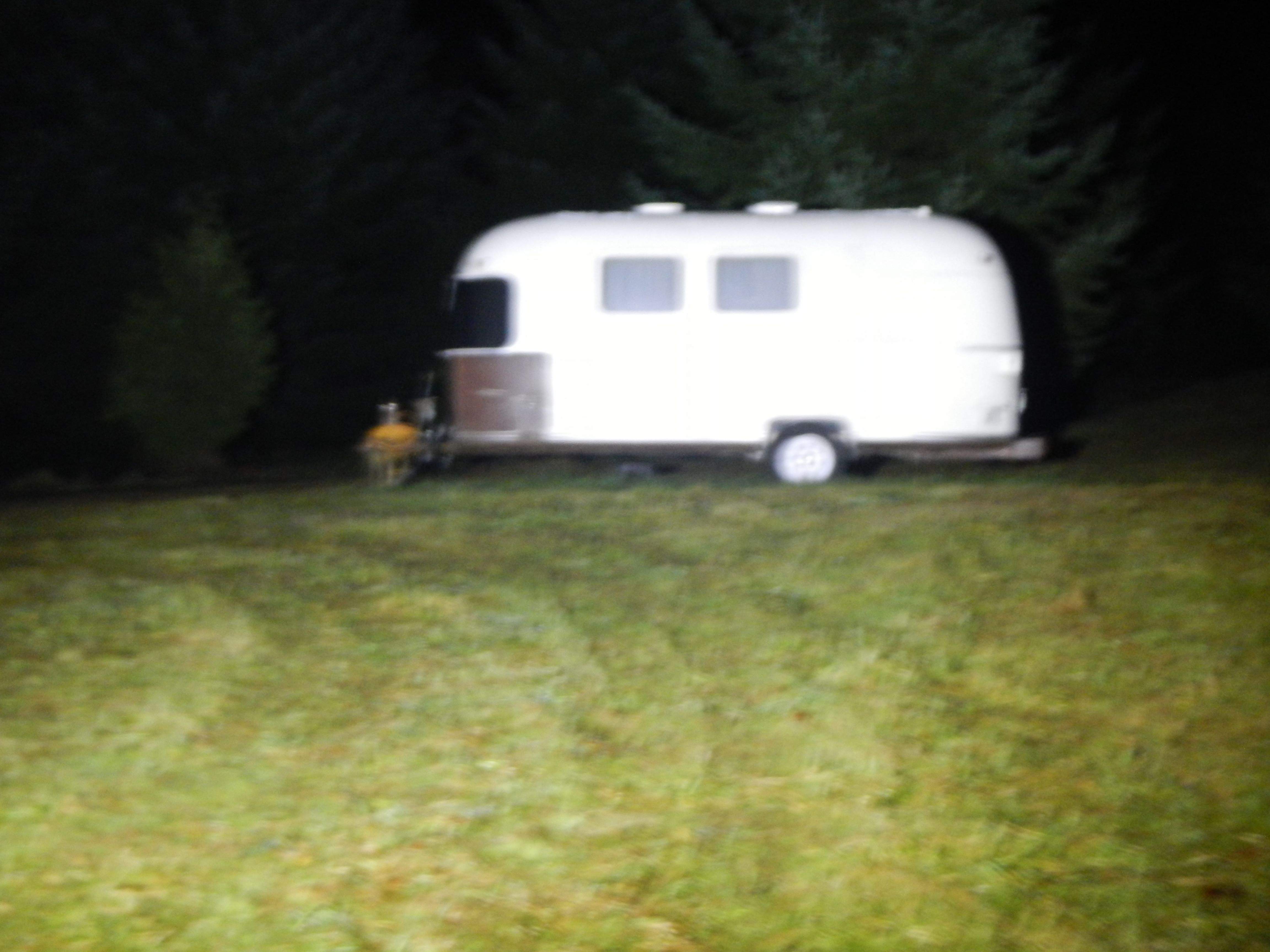

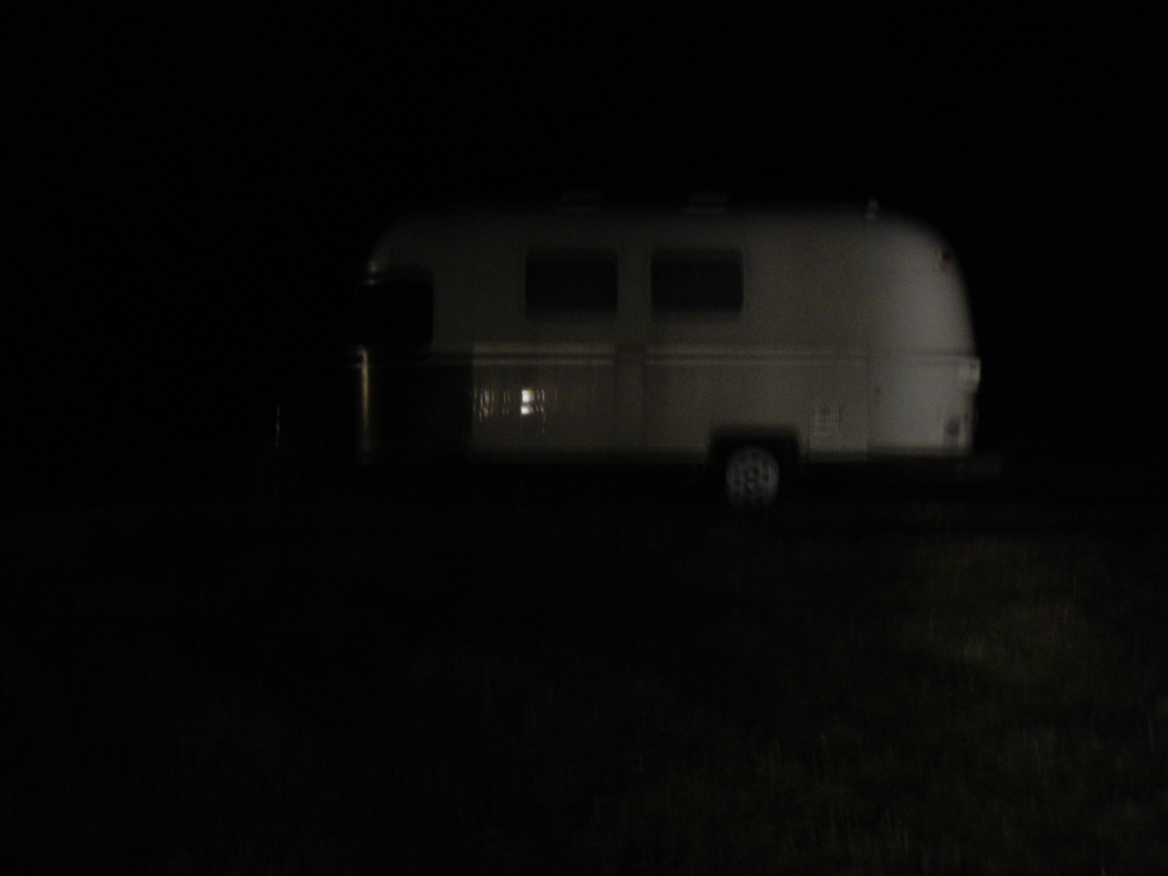

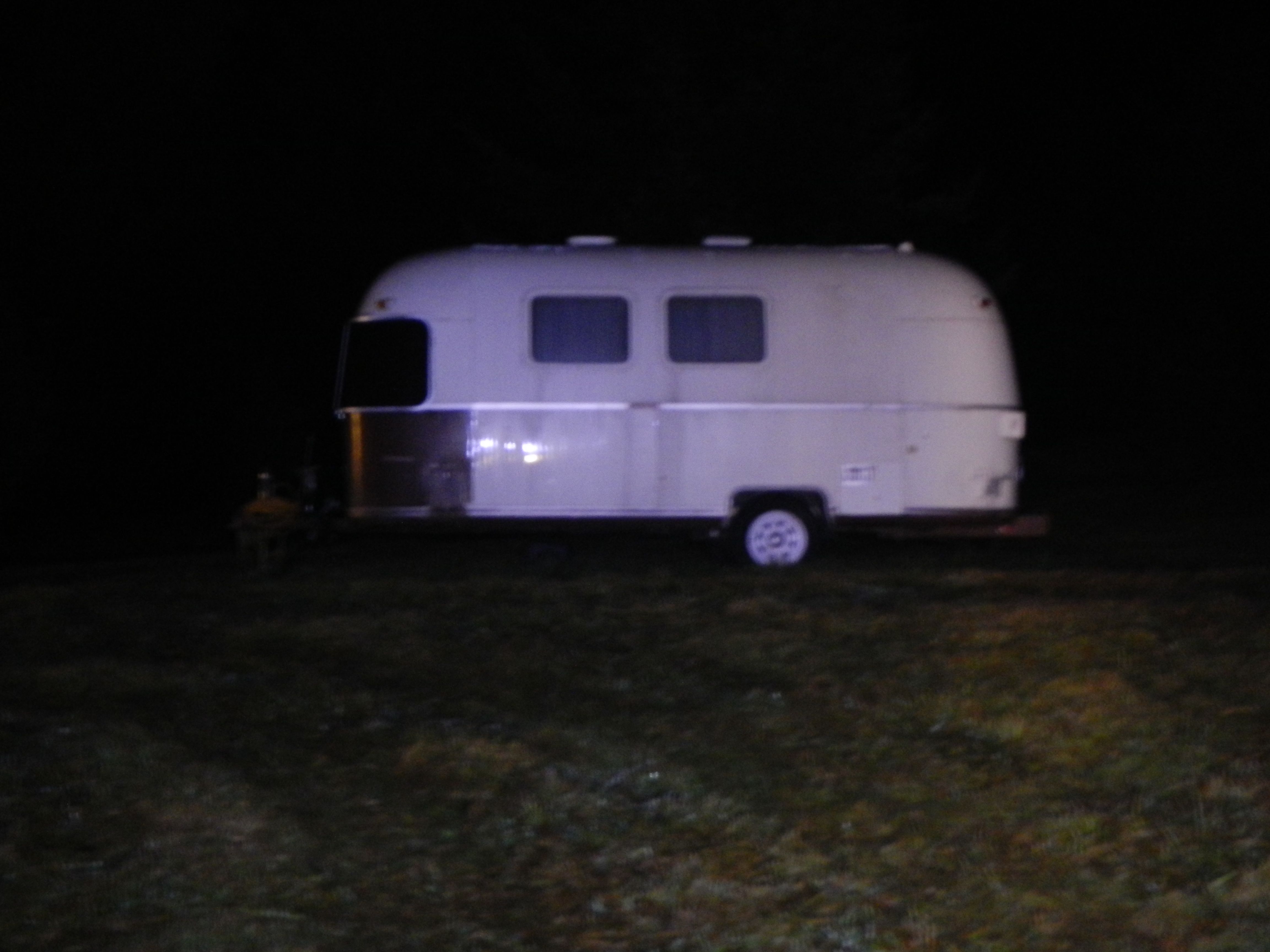

Frank, thought I would just repost these. These are pictures I took, exposure time and apature locked, I bumped the lense on the last take but none of the settings changed.
This is a picture of one single stock incandescent bulb projected at my trailer
This is a single, 24 watt LED,
This is a single 48 watt LED.

Those pictures sure do say a lot.
Thanks
   / Lights
Ken, just saw your pics. Amazing difference! Thanks for sharing.
