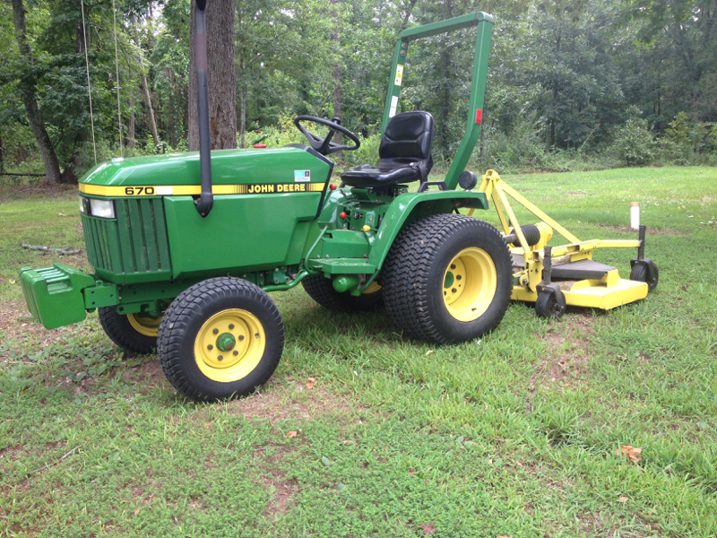

1994 John Deere 670 and 1948 John Deere B
Need to add some extra lights to my tractor for nighttime/evening work. The sky's the limit for light choices... What are your favorites? Not wanting to spend a ton.
Anyone mount them to the ROPS? Seems like the bug swarm may be bad if the lights are up there.

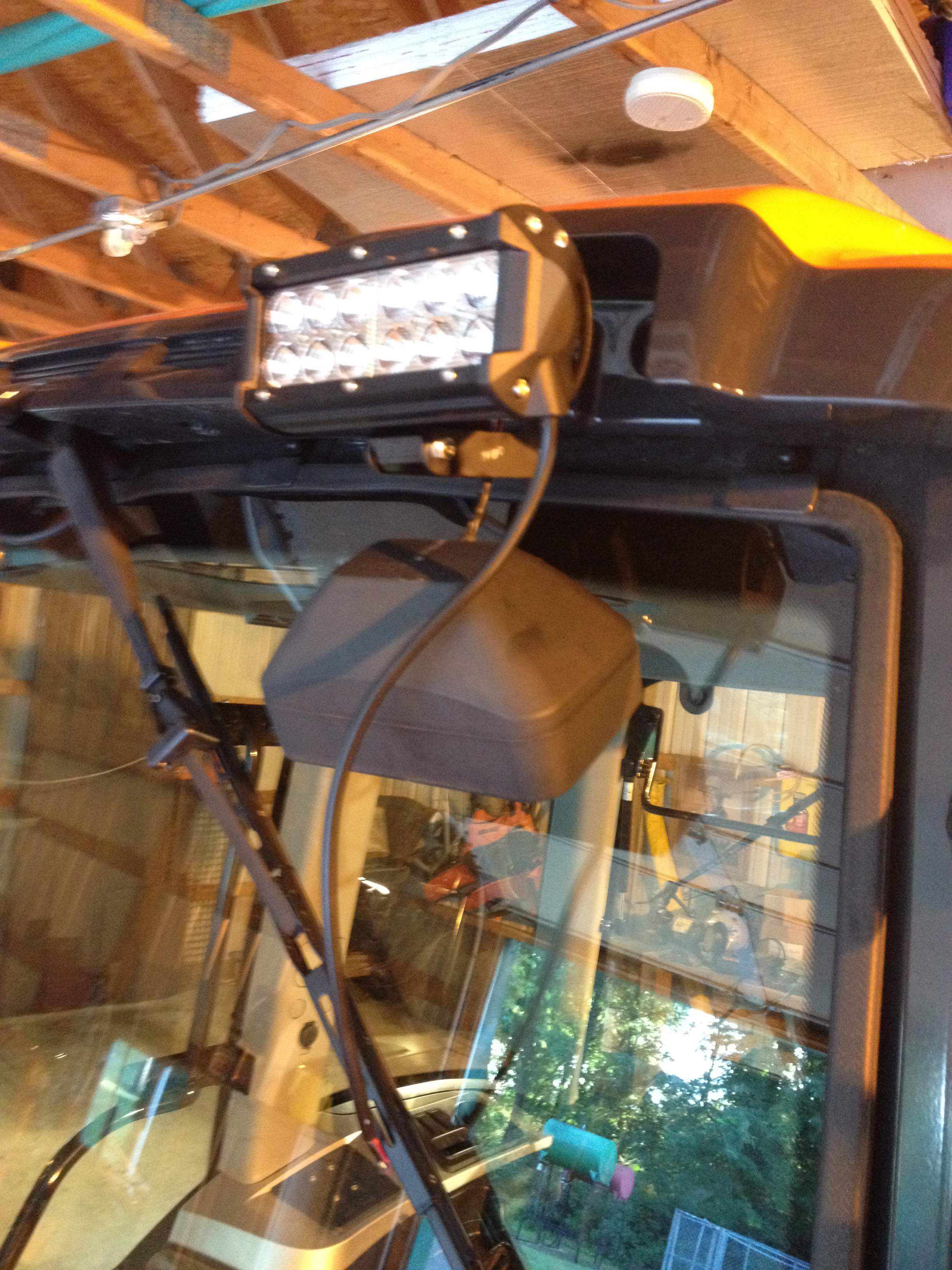

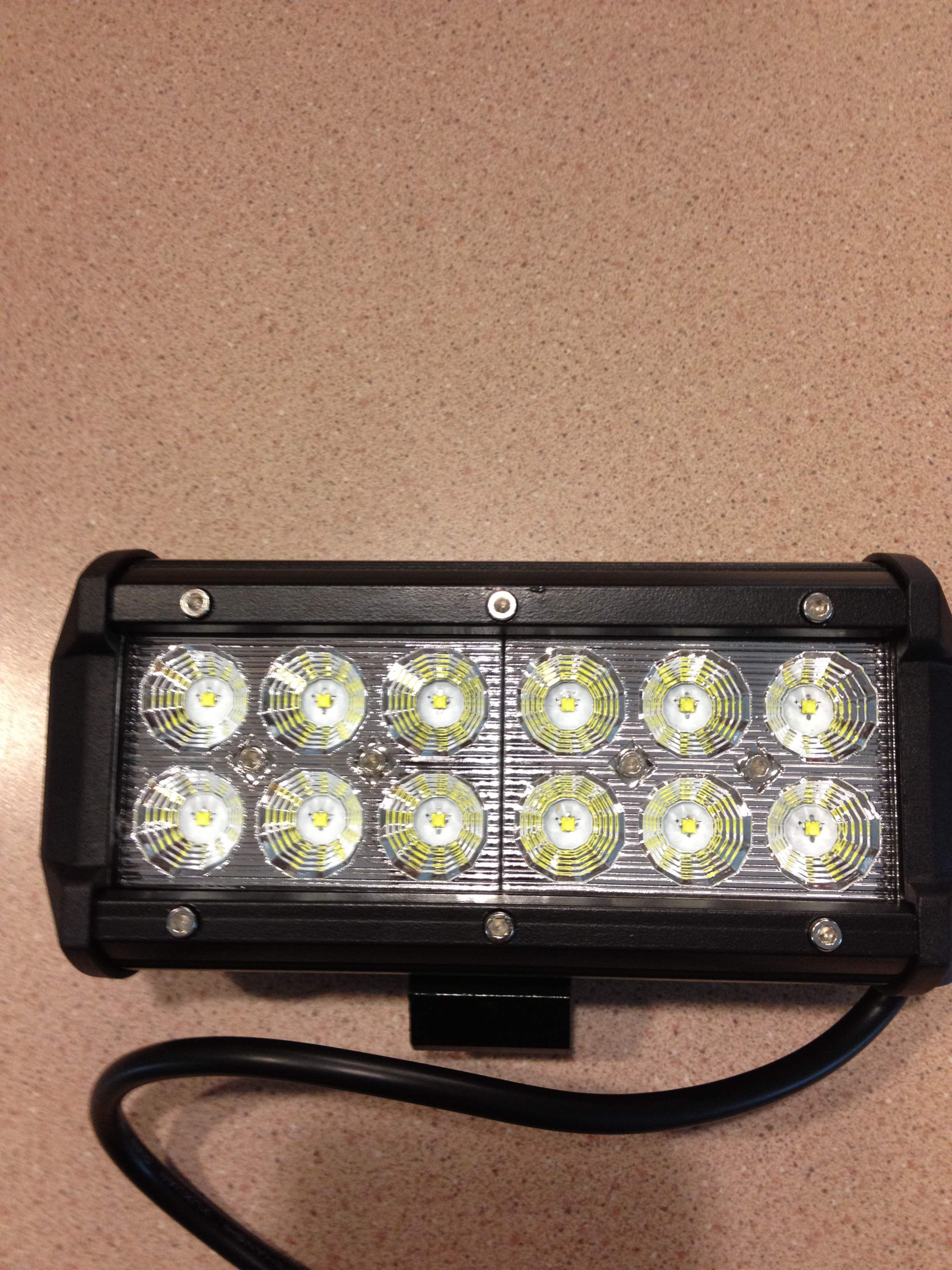

I would look at the Cree LED,s lights.I have Two sets mounted on my Kioti tractor and Kubota RTV 900 happy with both..

I'm really liking the look of those Cree 7" lights. I'm thinking 2 forward and 1 backward off the ROPS.

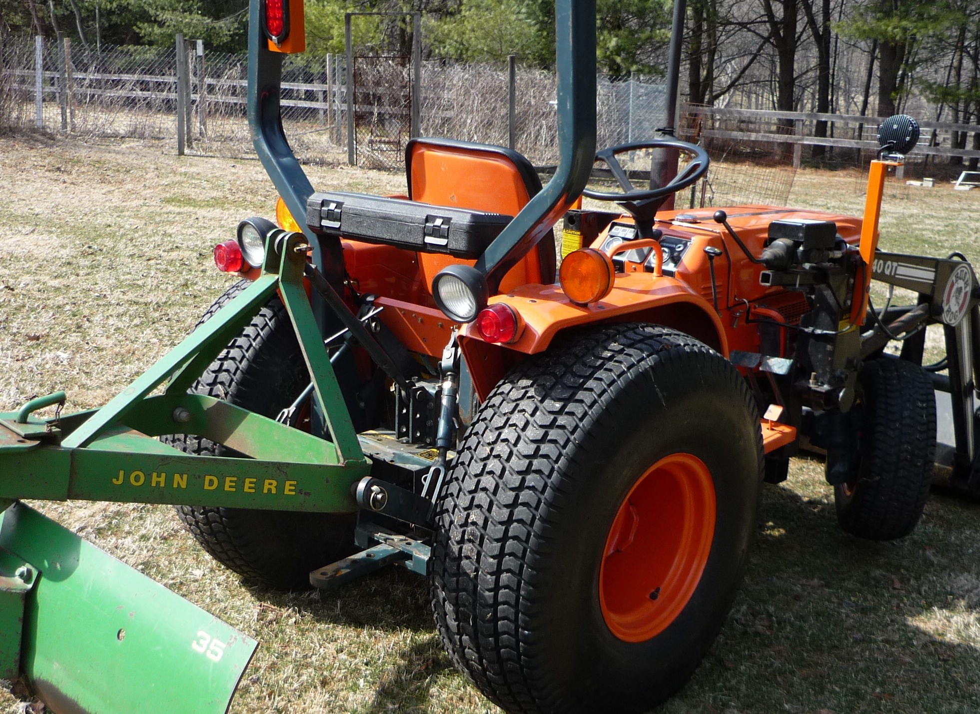

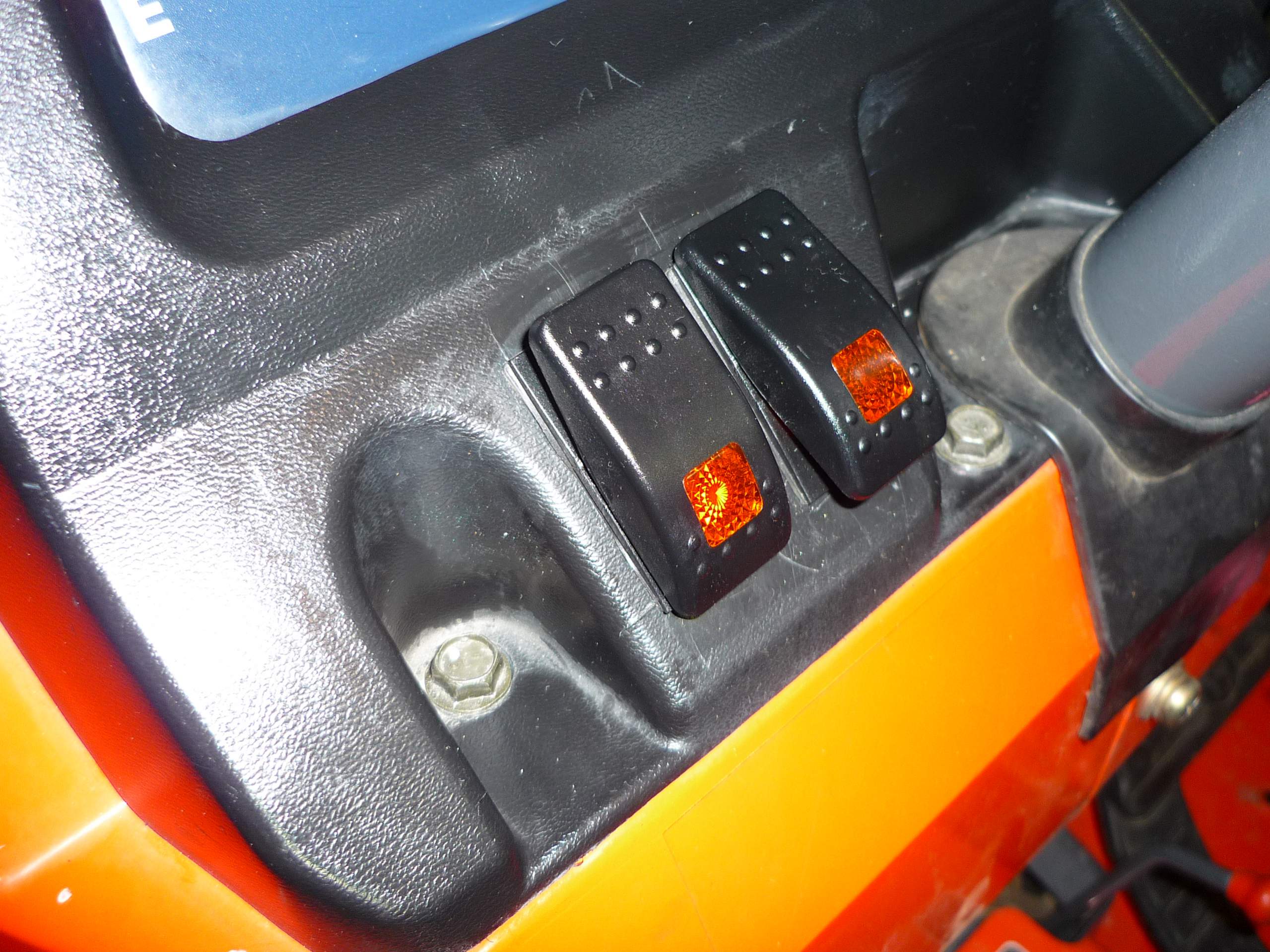

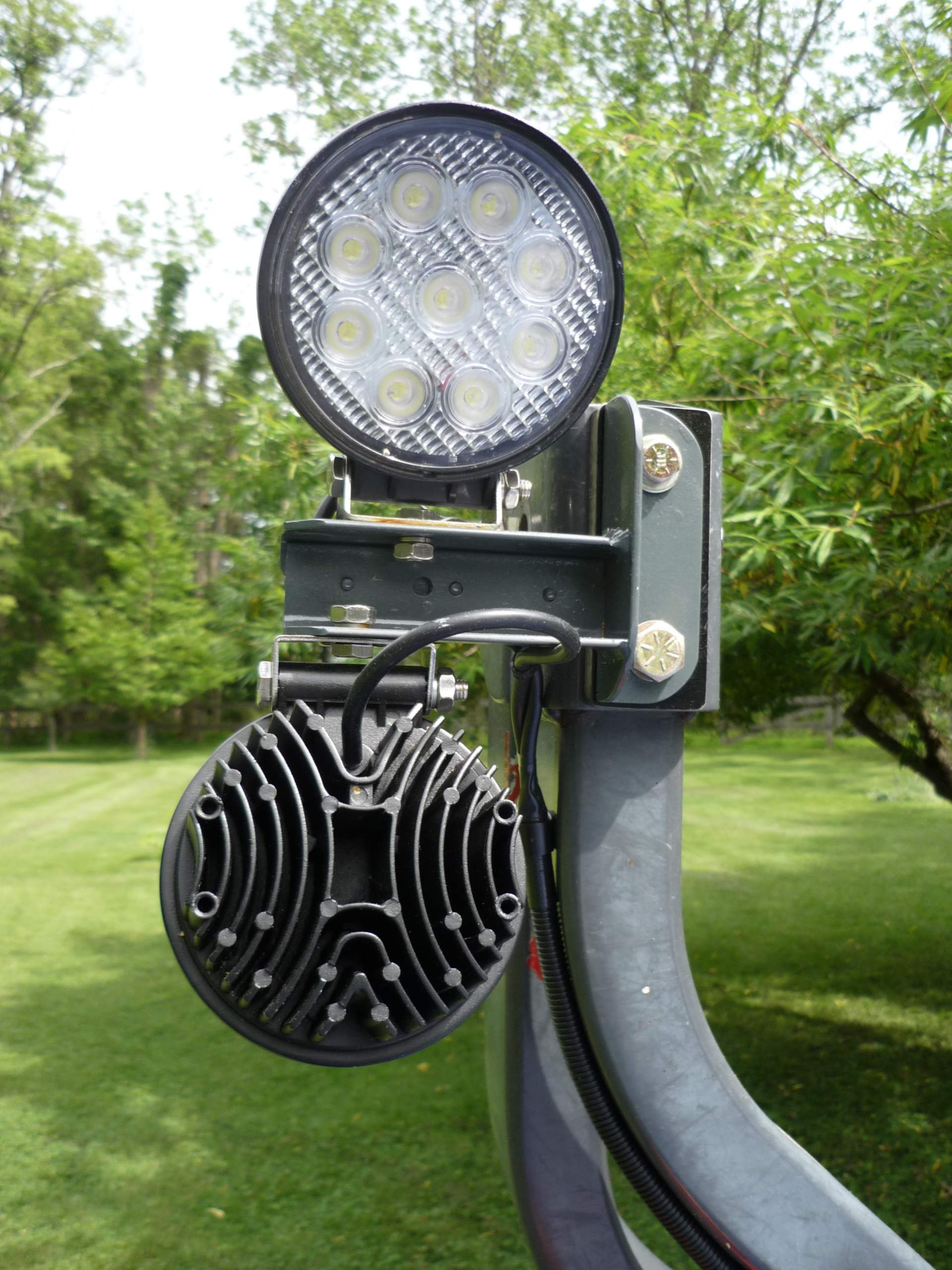

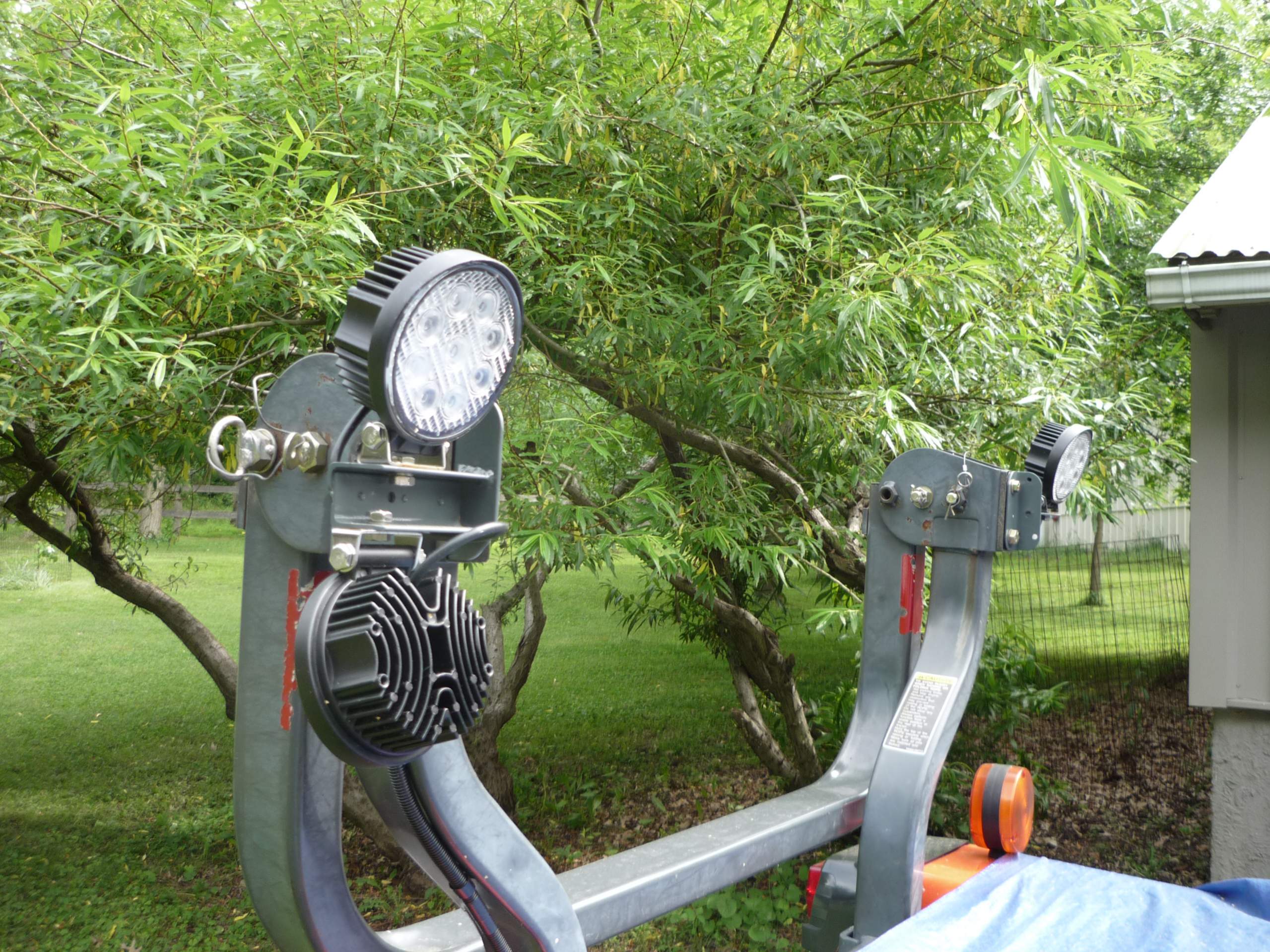

I've added 27W LED light to three Kubotas so far, and for the $15 each light has cost, eBay or Amazon, I can't complain. No failures, no problems, and best of all, low current draw, so leaving all four on at once isn't a big deal. No issues with blowing snow blocking the lights, either. Waterproof LED switches work well, for me. For an open station tractor, the ROPS seems like a good place for them. I like spots towards the front, floods for the back. Photos are my second tractor- now I have four lights on my third. Why not? Kubotas come with wiring for rear lights, which makes it easy.

Those look great Varmint. Thanks for the detailed pics. I'll update soon when I pull the trigger.

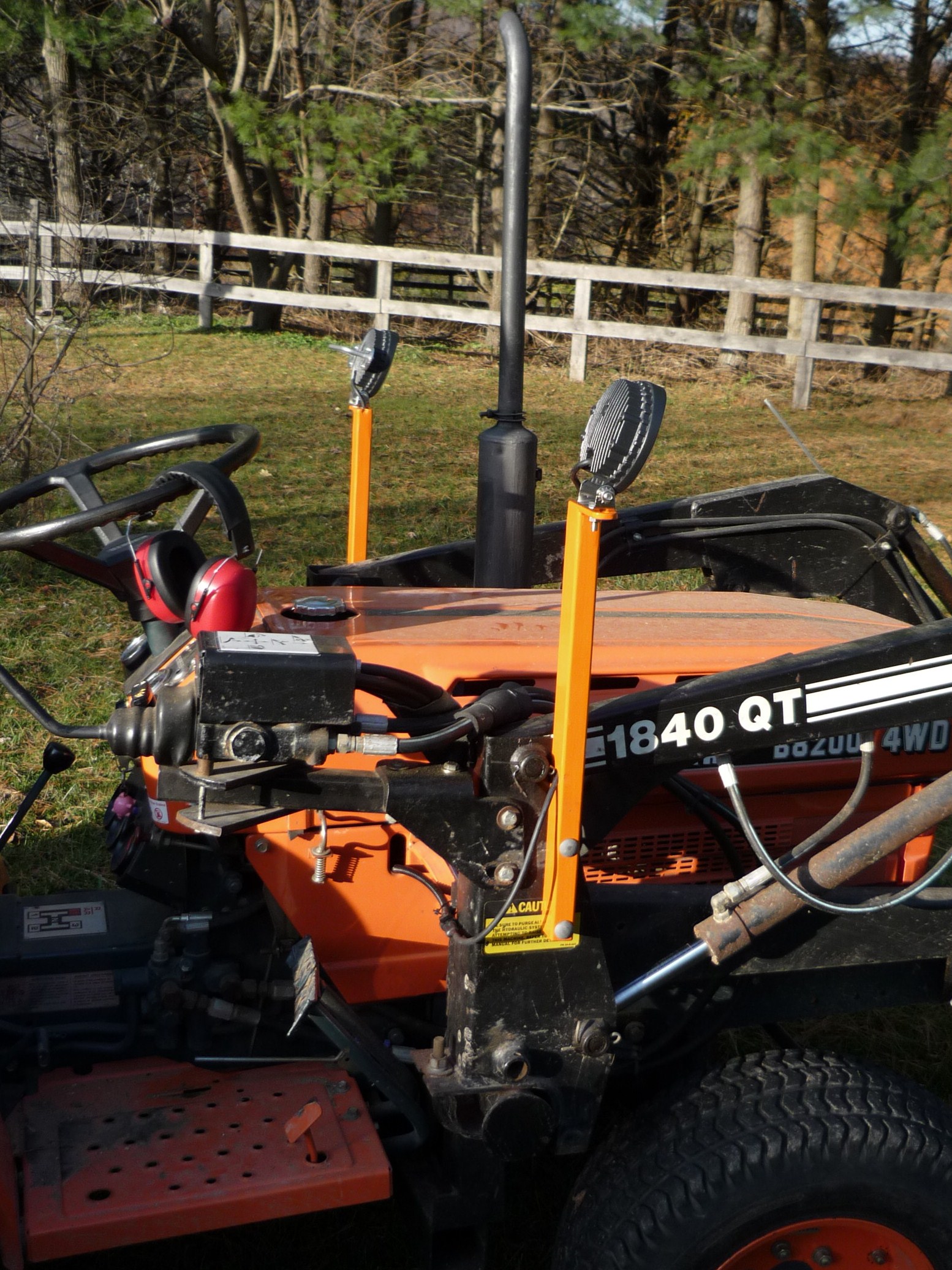

I don't generally use my tractor at night, only for snow removal... so bugs aren't the problem they might be otherwise. I had mounted lights on posts on the loader frame on my first Kubota, and that worked pretty well, but higher seems better, since I am often working in a confined area- brush and trees on both sides of the lane I plow. I like the idea of 18W sidelights, too... maybe another project.
