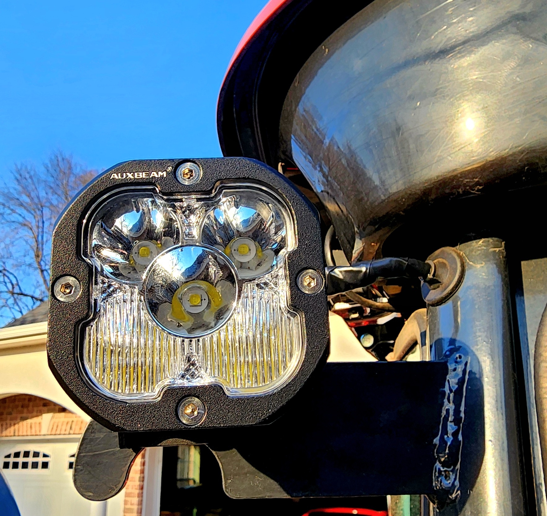

A word of warning though, be careful when you buy any pods that are listed as "combo" spot and flood patterns; I found out quickly that the AuxBeam pods that I bought for my tractor's side lights were much more spot than flood, as seen below:
AuxBeam "combo" spot and flood shown as my side lights:
I'm waiting on a set of Rigid Flood pods to arrive that will replace the above pictured AuxBeam combo lights to eliminate the spot hot-spot and be a more even flood all the way around the cab.
