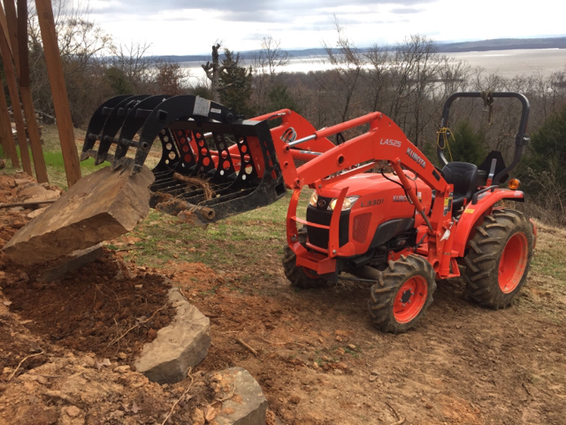

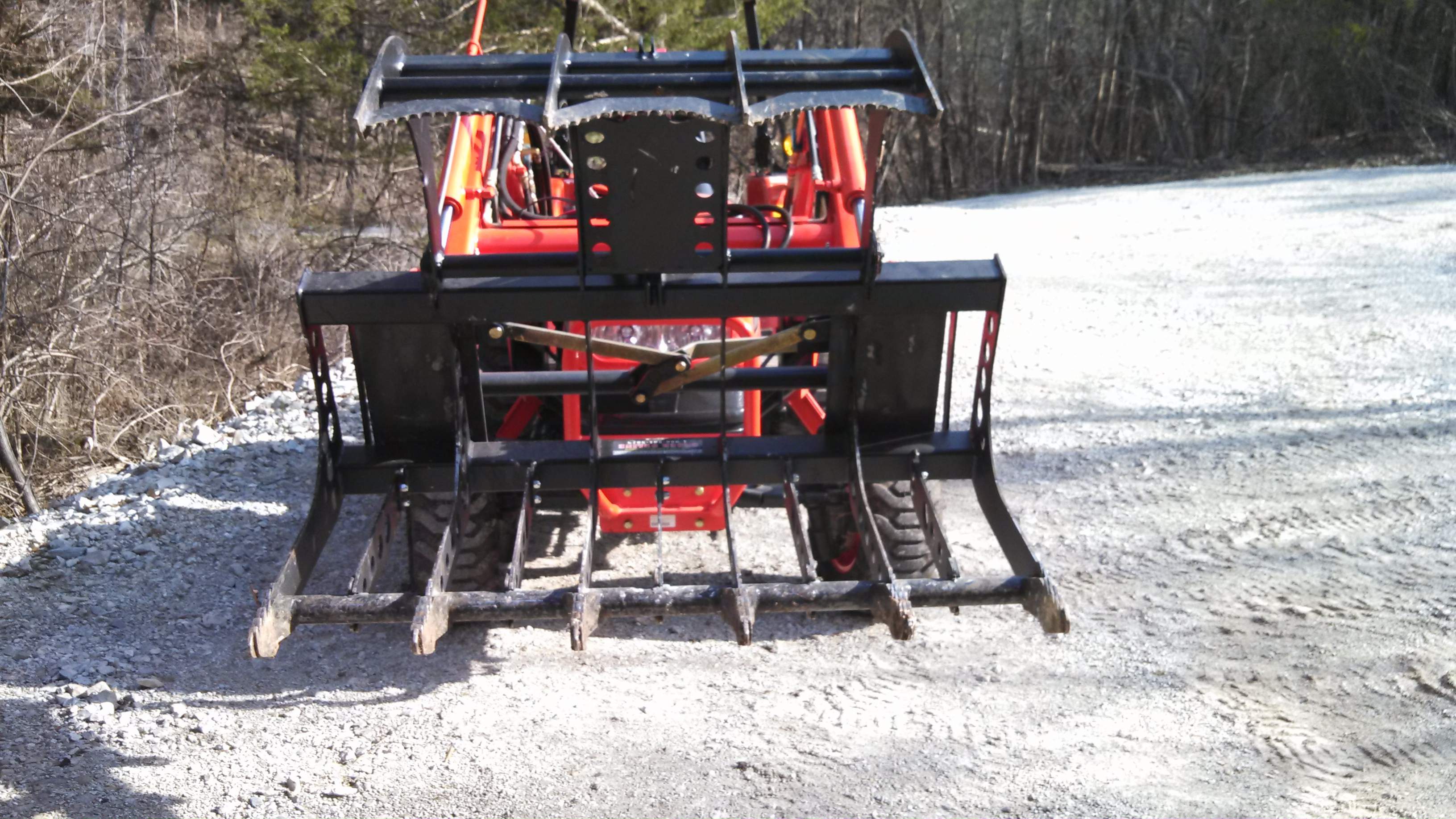

I am pretty happy with my EA 50 inch. It is not A36 steel. It is a high tensile 80,000 psi steel. I use it on my Kioti DK35se, a similar sized tractor to yours.
/ Lightweight Root Grapple
Thanks for the information and picture! Good stuff.
