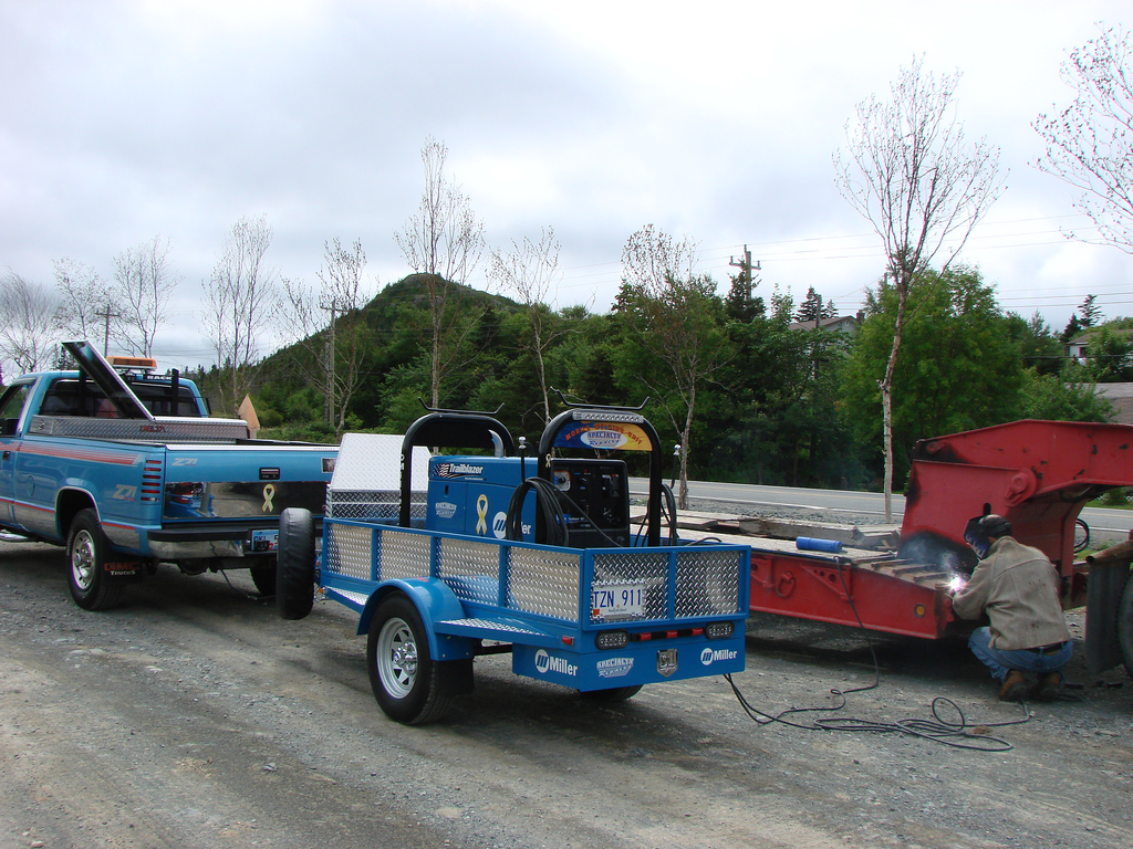

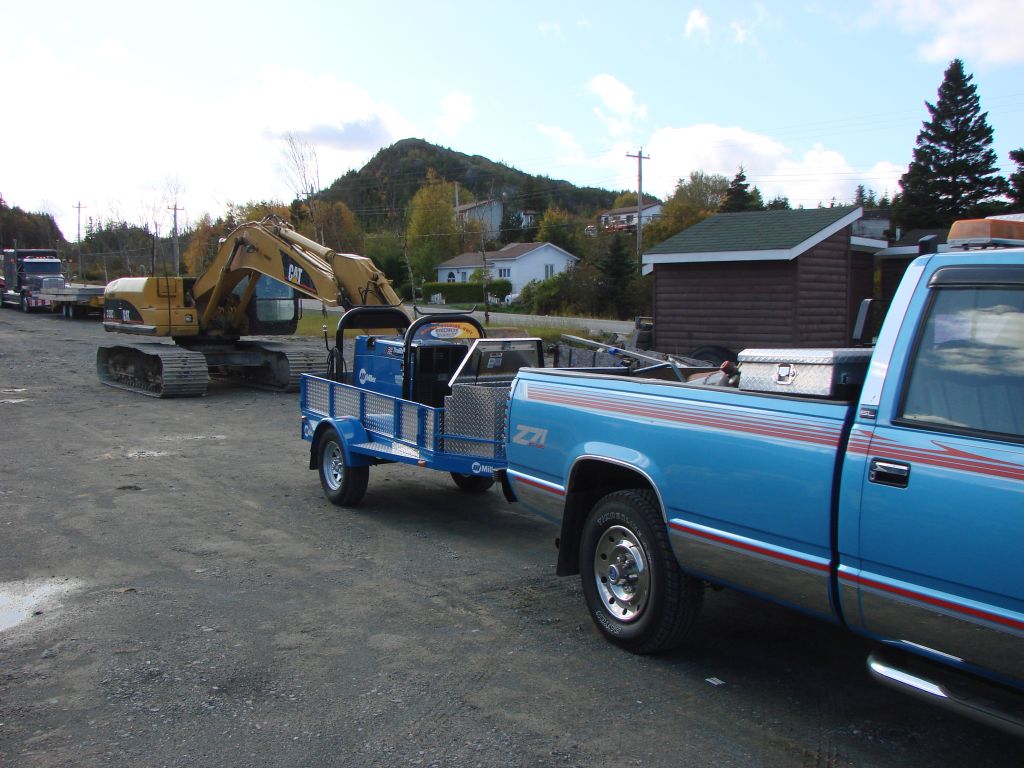

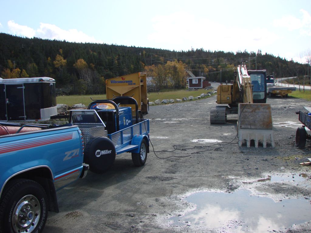

I never said it was the best thing since sliced bread. I happen to think sliced bread was a great invention :laughing: I'm heading out with the unit and doing stick because It's going to be a windy day for one. It's a heavy thick piece on an excavator in a very tight area. I do aluminum mig with the mobile unit but in this case stick is going to be best for the type of repair BUT I still like mig better :D Each process has it's place. Everyone is aloud to have a favorite process ;) The stick process will never become obsolete in IMHO and that's why I still use it.
A few pics from the past:
