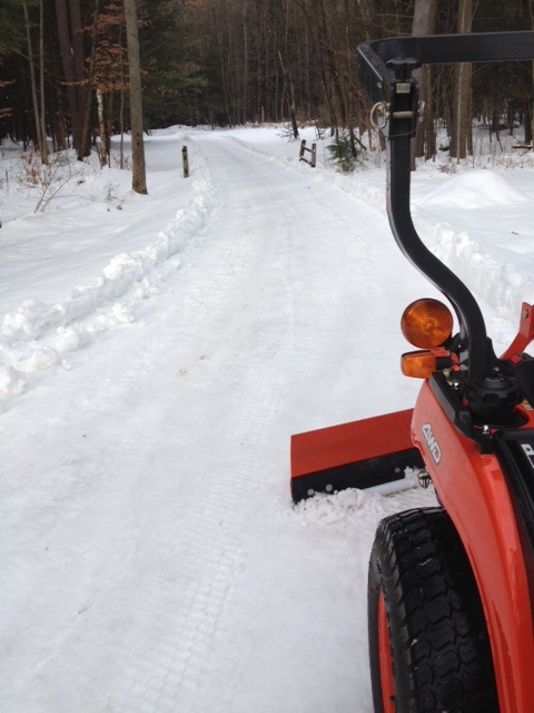

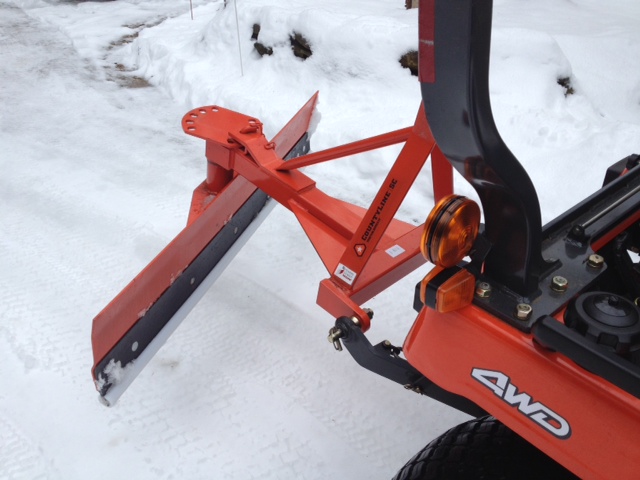

I cut into the tube, completely through one side, on a table saw, then forced it onto the blade with a hammer and wood block. It's a very tight fit and so far has not come off. The width of the saw kerf worked out very well with a single cut...any wider and it would have been a loose fit, any narrower and it would have been a lot harder to get on. HDPE plastic is very easy to cut/machine, and highly scratch/impact resistant, even in very cold temperatures.

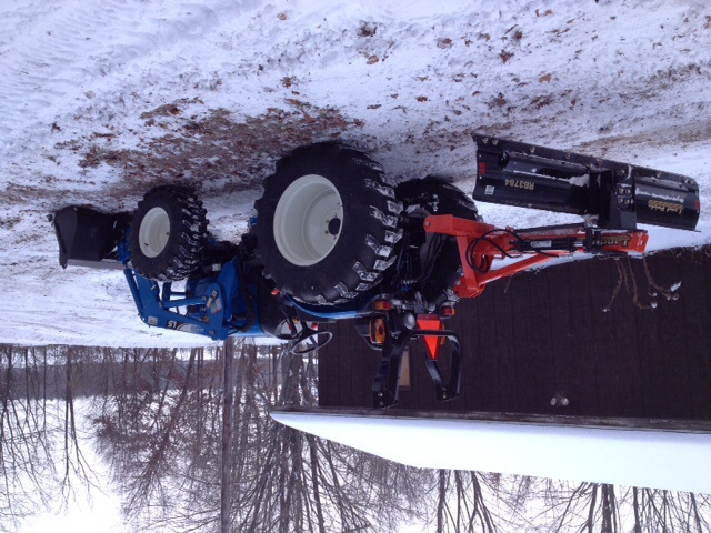

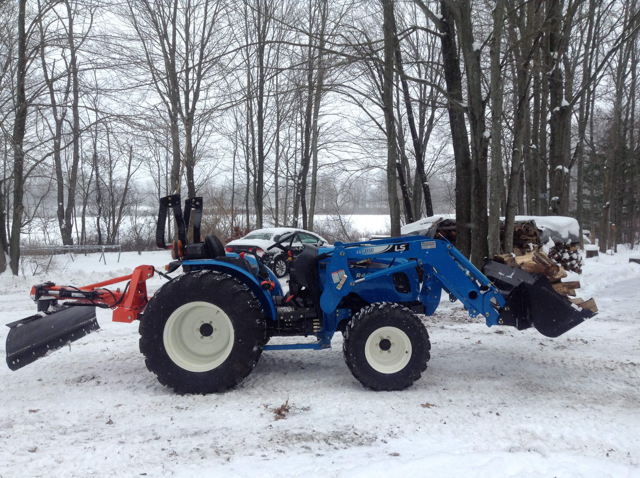

Do you think that type of plastic pipe would hold up with a heavy 630# blade like this? Thanks

I got the plastic tube from McMaster Carr, McMaster-Carr.
It wasn't cheap but, I think it's about the best material choice. I know that others have used a rubber edge with good results, which may be less expensive, but a rubber edge requires bolting to the blade and I did'nt want to do that. Regarding whether it will work on a larger heavier blade, hard to say, I would think that you might want a larger outside diameter tube, and one with a heavier wall. Regarding turf-tires, so far I have no problems in 4WD. If I'm pushing the pile, the wheels will sometimes spin when I reach a high snow bank, but I figure that it's telling me I'm at the limit of what I can safely push without risking damage to the tractor.

PVC is cheaper than HDPE, but it will crack/shatter in freezing temperatures. Plus it's not as scratch/ding resistant as HDPE, so it will wear out sooner. HDPE is also more flexible, which means that once cut, it grips the blade better than PVC. I got the plastic tube idea from another post on this site. Some guys use a steel pipe with welded tabs, which they bolt through the blade. I don't weld so I opted for the plastic tube. If you search plowing gravel driveways on this forum, you will see other posts and other solutions.

A follow up to my original post...I discovered that as the plastic tube begins to wear from dragging along the gravel, it gets thinner and as it gets thinner the groove tends to open up, which makes it slip off the blade. I have a fix in mind, something another poster on this site came up with, which consists of drilling holes in the pipe and securing it to the blade with rubber strap hooks. I think this will work ok until the pipe finally wears through. Once that happens I am going to use the rubber horse stall mat strip others have mentioned.
