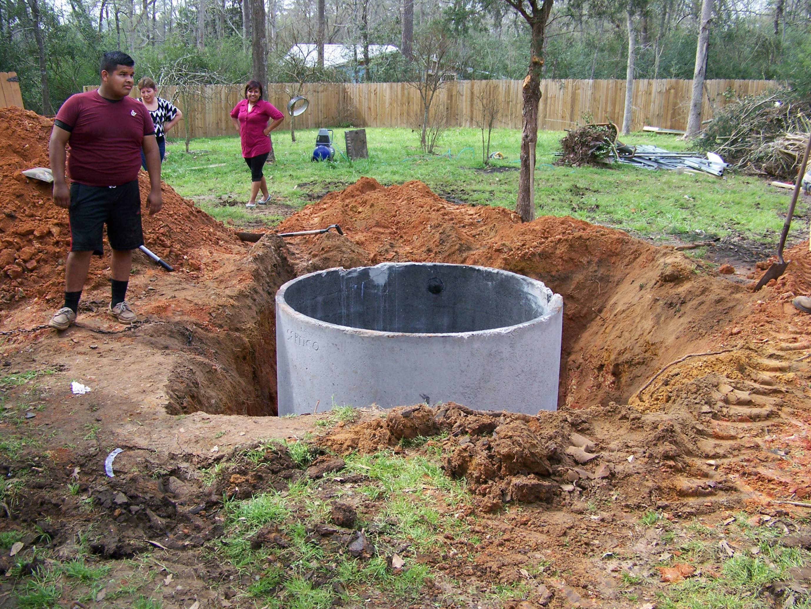

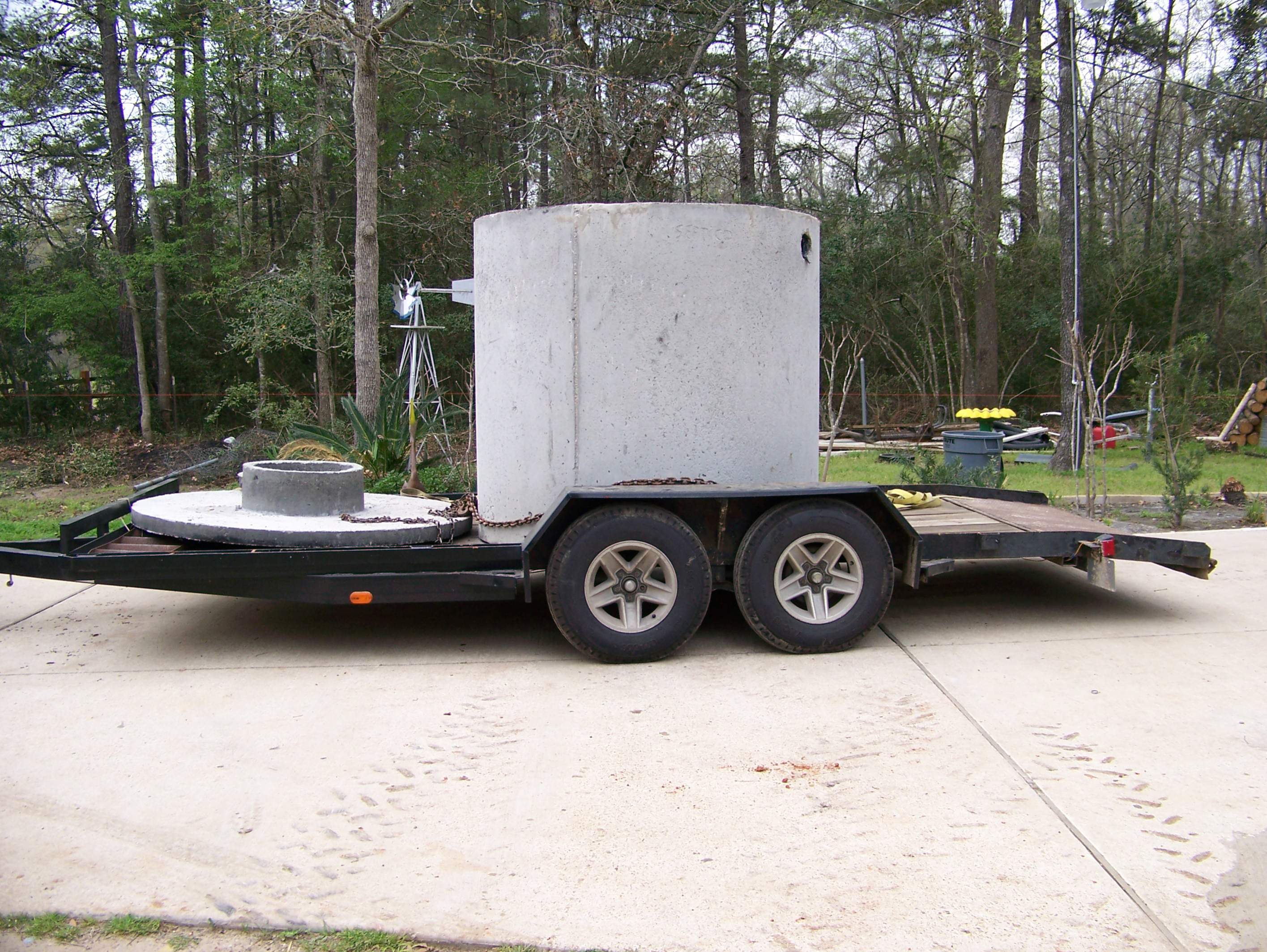

Here is the 750 gallon tank I installed. I barely got it off of the trailer. Once we lowered it, I couldn't pick it back up. I could take enough weight off it, in the hole, to reposition it with the help of a long 2x4. 3-22-14 Miguel's Tank In the Ground.jpg3-22-14 Miguel's 750 Gallon Tank.jpg
