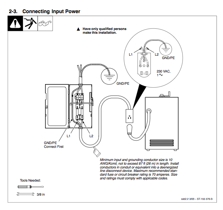

And from the thunderbolt owners manual
   / Lincoln Ac/Dc 225 breaker size #16
In both instances they call for 10 gauge wire --- for up to 87 or 100' then 8 gauge. I know many people think you need to run 6 gauge for a 50amp breaker. But what I've seen/read is that if you run a dedicated branch circuit you can use smaller wire for a given breaker size IF you follow NEC 630.11
And all the owners manuals that I've looked at spec a wire size that matches my calcs when using 630.11
In the case of the Lincoln 50 amps X .45 (based on 20% duty cycle from 630.11) = 22 amps which means you can use 10 gauge wire. And some of the older manuals go so far as to spec 12 gauge wire with a 50 amp breaker since the ampacity of 12/2 nm is 25 amps.
