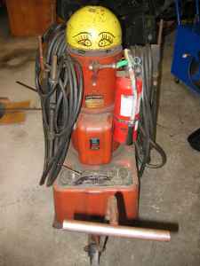

Shield Arc,
That was the granddaddy of all the tombstones and almost all other lincoln transformer products. IF a person wants a transformer welder, and they can find one of those at a right price, it is the one to have...Miller who?:laughing:
Mark over the years I've probably only run a hand full of these, but I do remember they have a very nice arc. Like everybody else has said, tough as a nickel stake! I can't ever remember anyone ever saying they seen one burnt up.
I also like the arc of these Lincoln machines.
