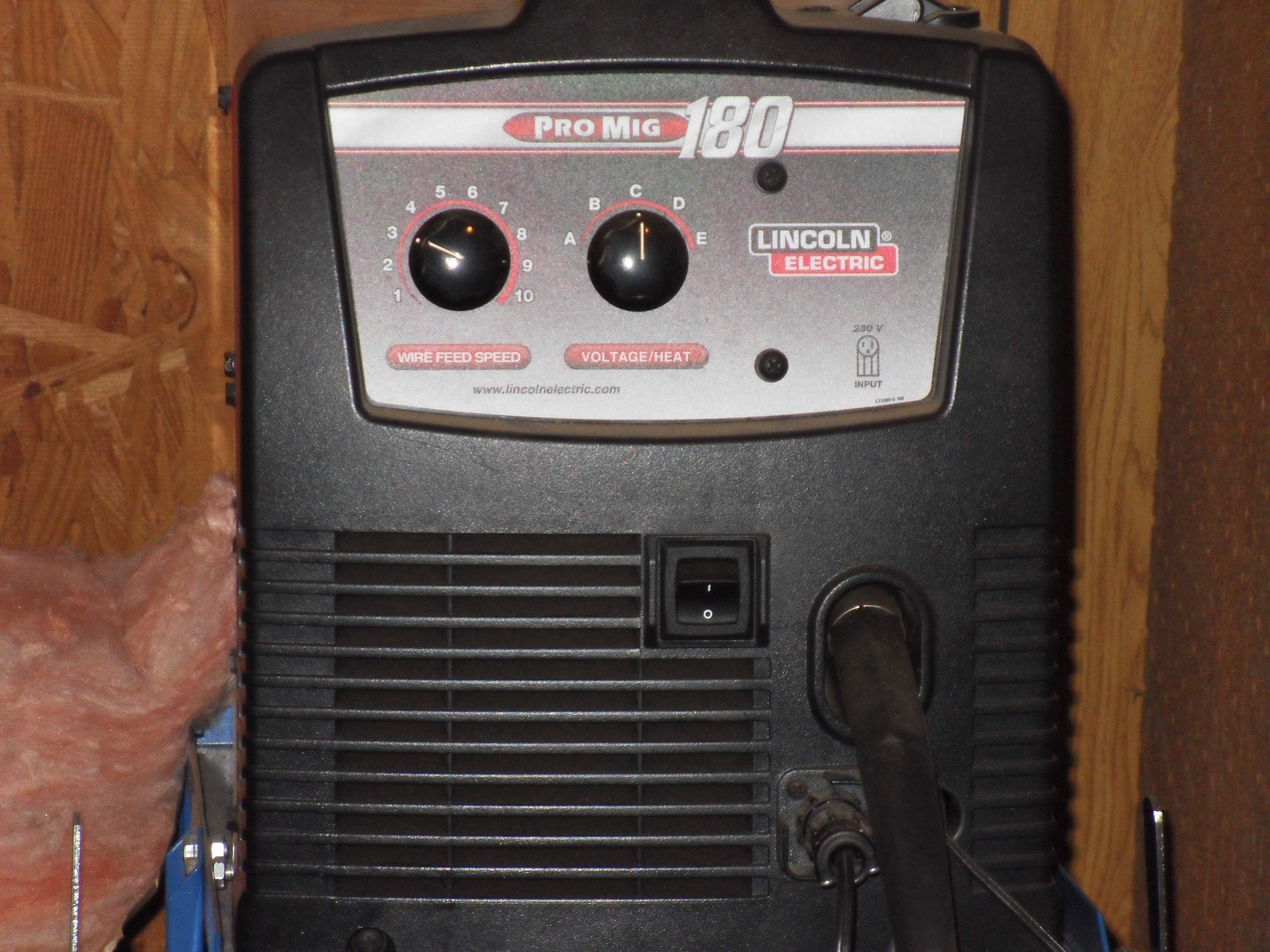

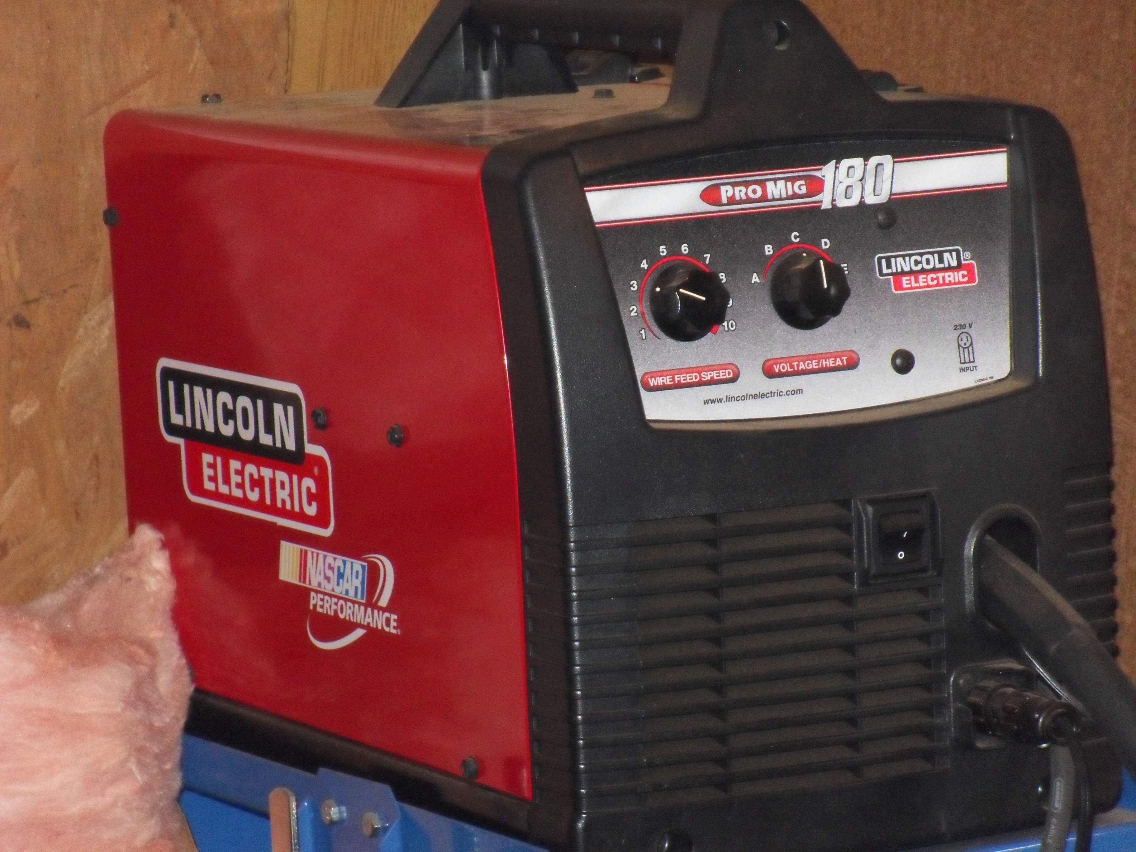

If the one you are talking about looks like the one I have in the pics, I would say go for it. I have only used the flux cored wire with it, and it does great. I don"t have a shop where I can weld inside so it works great for me. I do all kinds of welding at work, but this one works great for me. zman :thumbsup:

I just didn't like the idea of the tap settings but it probably won't make a difference for the beginner.
