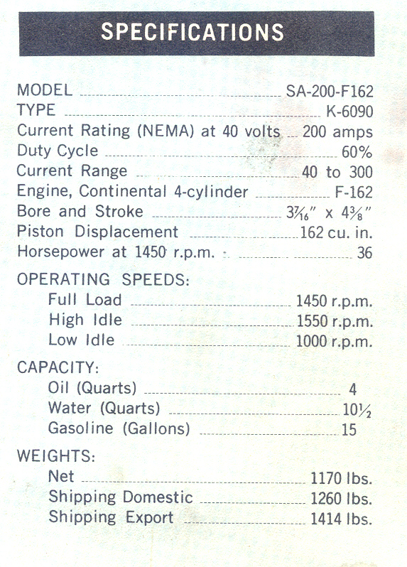

This might help, specs right from Lincoln.

Thanks SA!!
36 hp at 1450 !! quite a bit more than I anticipated !
might be around 40 hp at 1800, should be good for about 18kw, provided I can get it running to its full potential without breaking the bank !!
Thanks again!!
Scott

Well I pulled the head off it yesterday. all 4 bores look to be in good shape. 3 & 7/16 bore so it does seem to be a f162. I am able to spin it over by hand, it turns smooth though about 120 degrees , then gets notchy.I'm hoping it in the geartrain and not a spun bearing or ?????
