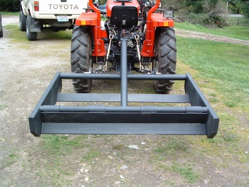

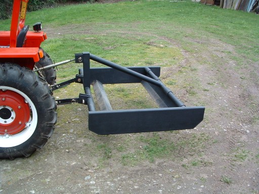

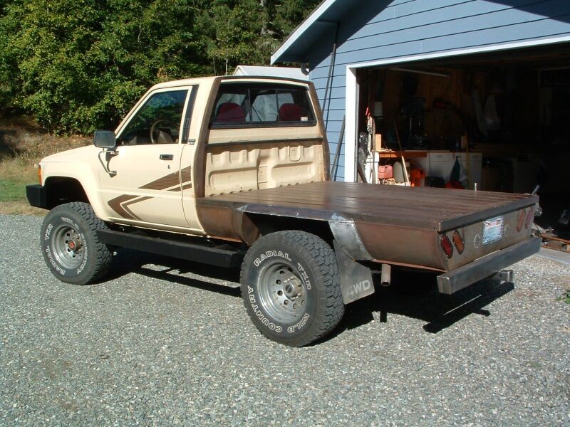

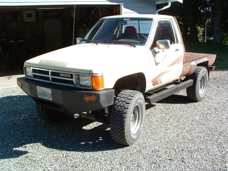

I would skip the gas and go with the .035 flux core wire. The gas bottle ties you to one place, unless you put the whole thing on a cart. It is really nice to plop the thing down where you want to work and run a heavy extension cord to the unit. The only time I have used the gas system is the few times when I have done stainless and aluminum with it. Use good wire, that makes a big difference and I have helped several people thru mig performance problems that were related to the quality of the wire they were using. I have had very good service from the Lincoln wire, and it can be had at most any home depot or box store that sells the lincoln welders. Put it to work, I think you will be impressed with it's performance. Here is some of hte big stuff I have done with mine over the past 5 years
Grader
Fork bucket
Grapple for fork bucket
Tow behind sprayer cart
Pickup truck bed
Bumpers
Rock rails

and more small repairs and mods than I can think of. I probably use mine once a month at a minimum. Just used it last night to build a custom "T" fitting for my truck's turbo coolant line relocation.
Good luck with yours.
