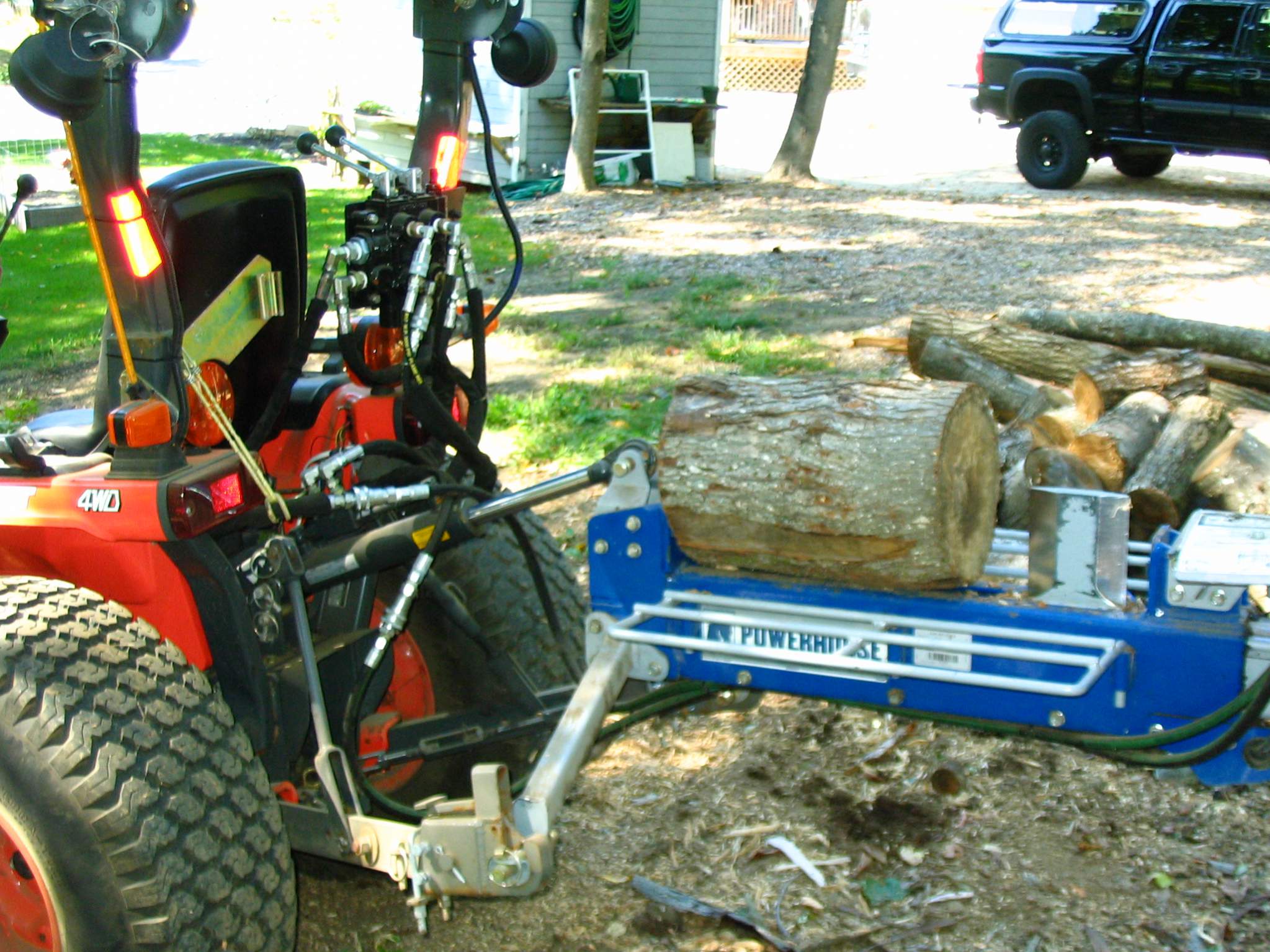

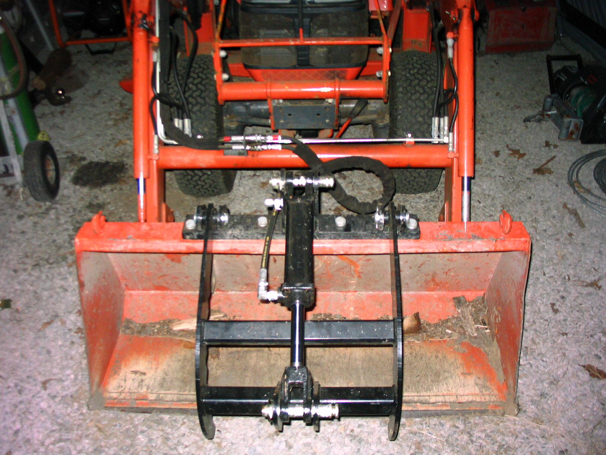

For an inexpensive , easy light use option, not a bad idea. Beats the **** out of adjusting the turnbuckle for your top link... Probably a bit weak for a grapple...
That being said I installed hydros on both...
