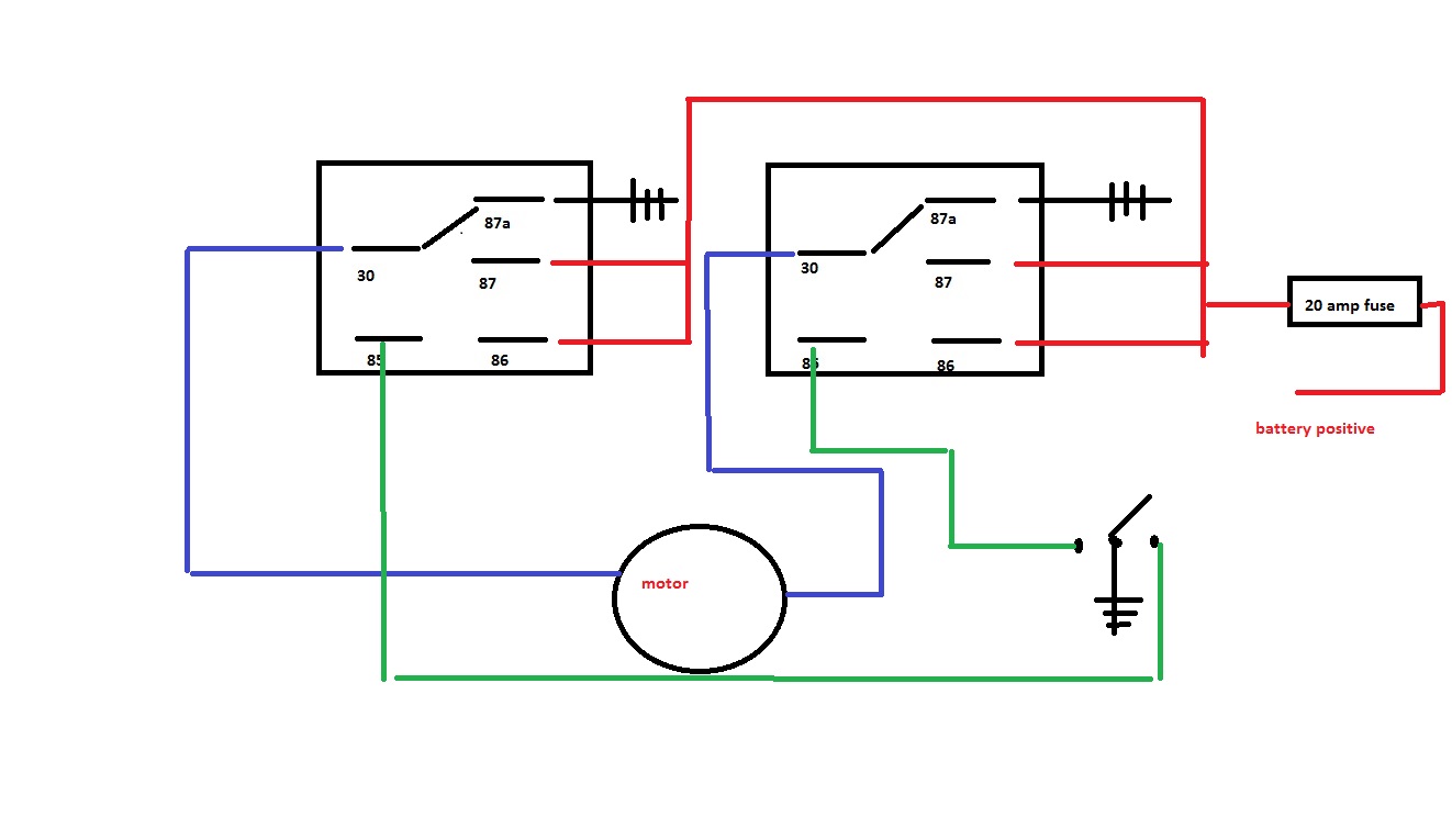

I would like some advice. I want to put a 12 volt linear actuator on my snowblower shoot deflector. It looks like a minimum distance of 22" and a maximum distance of 30". There is a 12 volt outlet next to the back window. I would like to plug in there and have a rocker switch for the in and out (or up and down) function. Can someone stear in it the right direction? Thanks

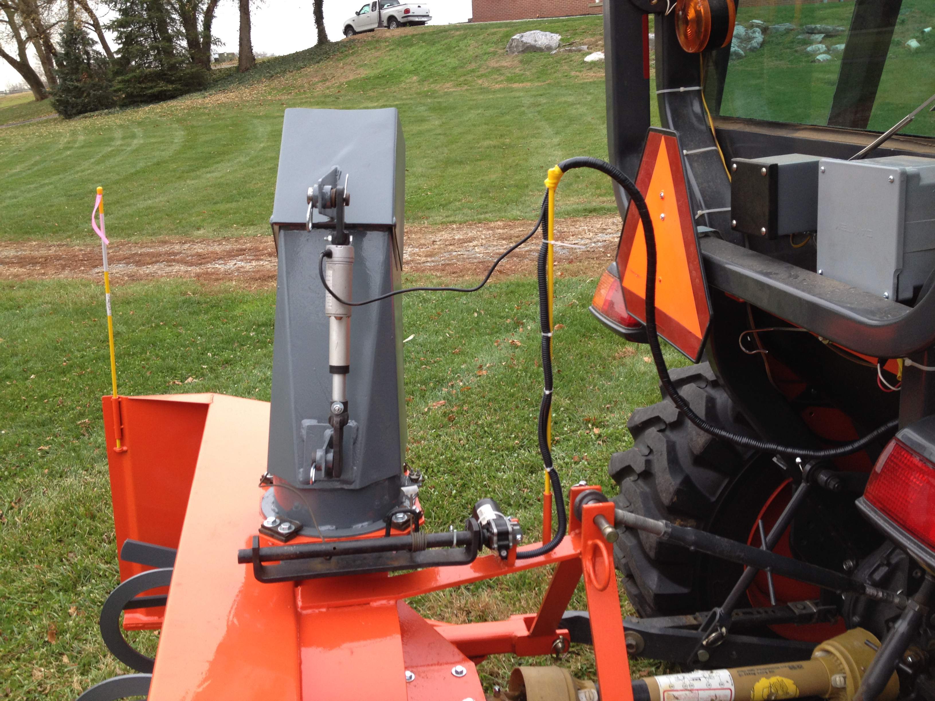

The min / max indicates you need 8" of movement. The LA can be lengthened using a solid extension. It may be easier and less expensive to find an actuator with the range you need and then modify the mounting to make it work. I found mine on line and it has built-in limit switches to prevent it from being damaged when it reaches its limits. Simple matter of reversing polarity to reverse the travel. I built a relay box for the rotation and up/down of the chute. Two small rocker switches are on a pendant in the cab and the blower wiring connects to the cab via a trailer type connector.

http://www.progressiveautomations.com is a good quality source. I've got several no name actuators that look similar to theirs for various things & one of their 500-600lbs rated ones for my power SSQA. They all come with the required built in limit switches.
Just apply +12v & ground, they extend. Reverse the polarity & they retract. A quick Google of "DPDT wiring a linear actuator" should show you pictures of how to wire up a standard $5 double throw double pole switch to run one. I never bothered with relays for the cheap light ones that pull under 5@.

Here is how I have been doing motor reverse on my linear actuators. Allows you to use small switch with small wires and mounts switch where ever you want. Depending on your application you can mount things in different places. I have post on here with more specifics on how I did it.
