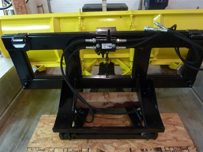

If you do allot of plowing and are concerned about catching the lead edge of the plow on curbs or pavement (or rocks and stumps and stuff).....you may consider adding a crossover relief valve between your cylinders and the control valve.
The crossover relief valve will divert fluid to the other cylinder if / when you hit the plow. Then you just angle it back to its rightfull position after the event.
Some guys feel it is a good thing to have.....and most of the major plow makers furnish such a valve. Like trip springs....it may be good insurance. ;)
Heres a pic of mine.

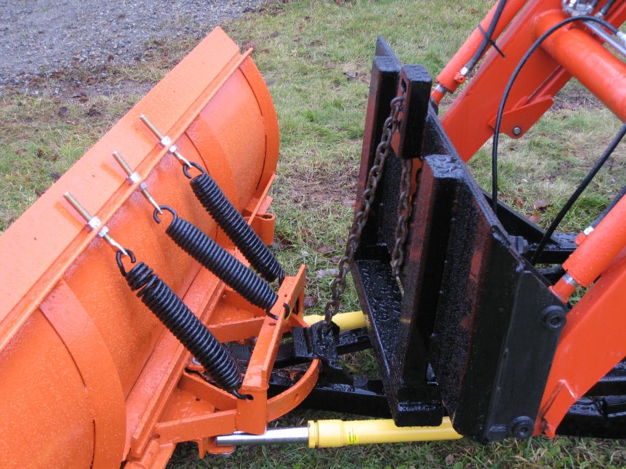

I really like this "Cat" brand plow, it is very well made and robust, with it's single horizontal cylinder for angling the plow, it keeps everything compact and close to the loader and not sticking way out in front.
/ Lines to snow plow?? #13
You're right about it being compact and close. That's the tightest most compact FEL plow I've ever seen! Very nice!
Do you have anymore info. on it? Weight, cost etc.
