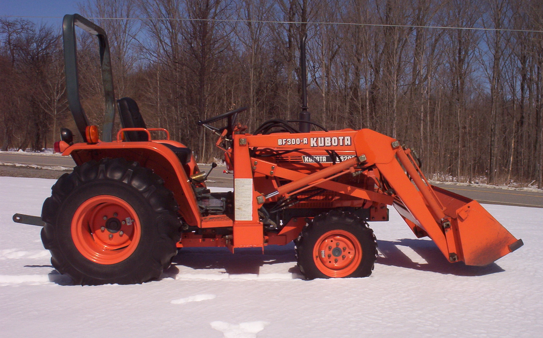

Back in the 80's, I bought a Kubota B8200 that came from the dealer with unloaded tires. Didn't have it too long before I realized they needed something put in them. At that time, antifreeze was somewhere around $2 a gallon.....so I put 7 gallons of it, and 14 gallons of water in each tire. It was fine even in our cold climate....they may have gotten a little slushy on occasion, but nothing came of it. I had that tractor for 24 years..... those tires with the antifreeze, were still on it the day I sold it...no leaks, no rust, and no problems. Besides the cost, the only downside to antifreeze is that it's not as heavy as beet juice...but any weight is better than none
