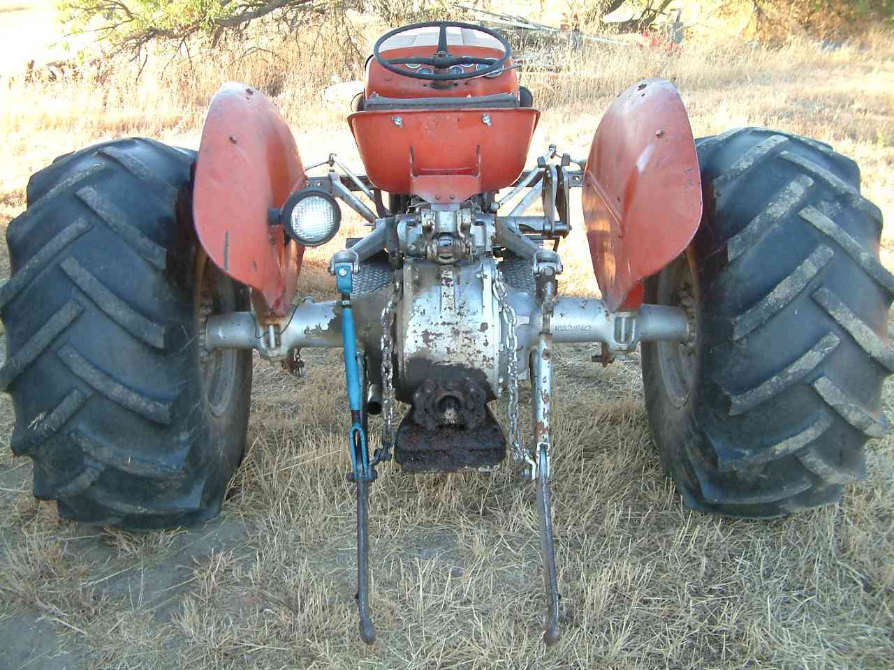

Nice job. Like the way you used 2x4s to break the bead.
Unfortunately, the filled tires on my MF-135 are gigantic compared to those on your JD. And they have inner tubes. No way I can get those on and off the axle by myself. So I plunked down about $15 at NAPA for an adapter that screws onto the tire's Schrader valve and allows liquid or air to be pumped in. Takes a long time to fill my tires doing it this way compared to your approach, but I'm stuck with those wide tube tires unless I want to drop bucks into another pair.

   / Liquid Filled Tires #16
You don't need to pump it out. Take the tire and wheel off the tractor. Position it so the valve stem is at its lowest point, open the valve stem and it gushes out. If the pressure falls and there is still water inside, fill it full of air and do the same thing again. Repeat a couple of times and most of the fluid should be out.
