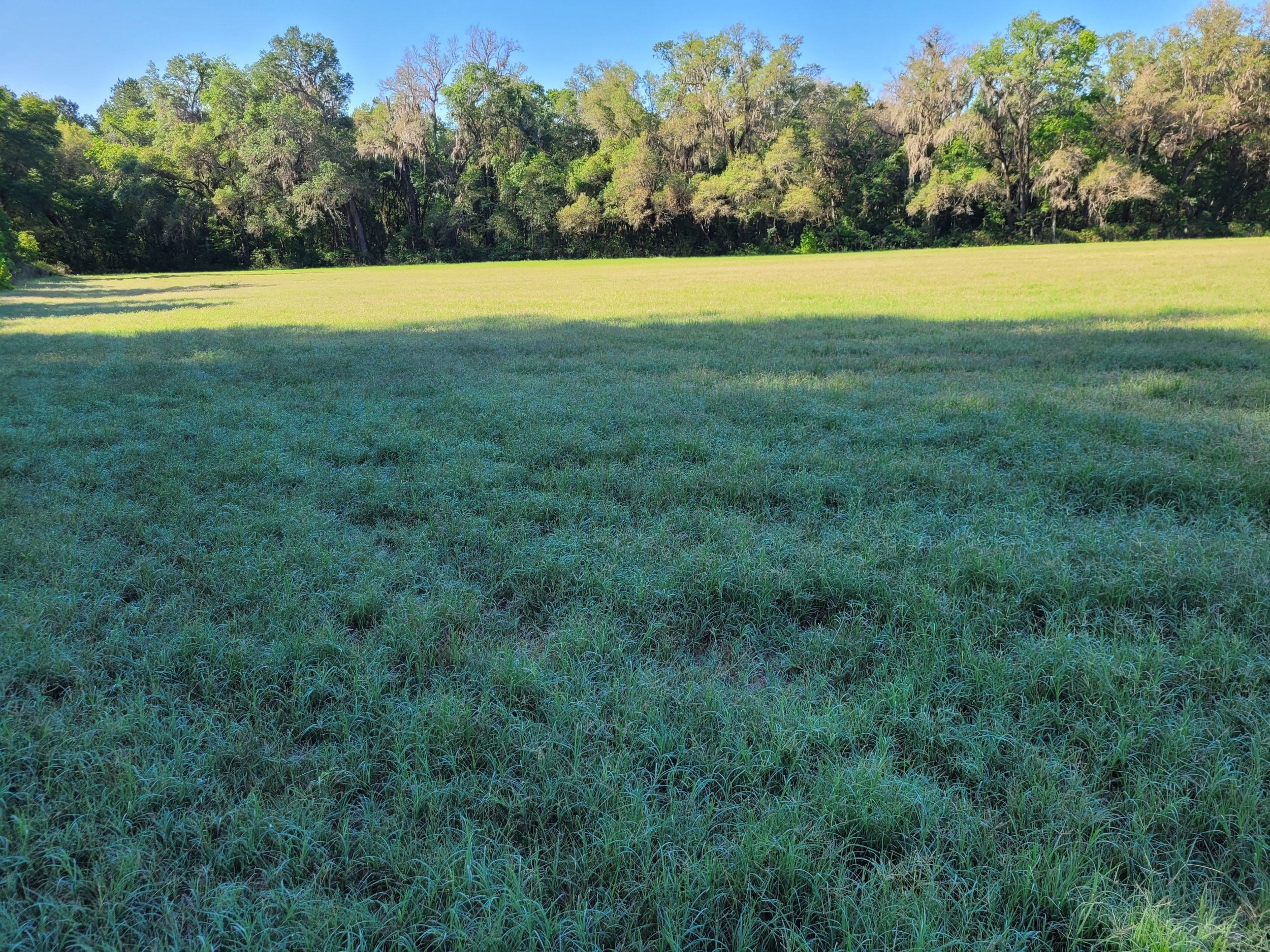

Well it's been 10 days and I can actually say that the product has definitely greened up the field, but the big question will be answered when I cut to see if it has helped any with production/tonnage, right now the grass is growing slowly due to 40 thru 50 degree nights but that should change by the end of the week as we are supposed to hit 90 degrees by Friday. I will keep the thread updated.
   / Liquid Lime/Calcium Anybody tried it? #42
Well it's been 10 days and I can actually say that the product has definitely greened up the field, but the big question will be answered when I cut to see if it has helped any with production/tonnage, right now the grass is growing slowly due to 40 thru 50 degree nights but that should change by the end of the week as we are supposed to hit 90 degrees by Friday. I will keep the thread updated. View attachment 862562
Do you see a significant difference between the treated vs untreated areas?
#43
Yes, substantial green-up , but I will have to wait to pass judgement until I bale, that will tell the tale.

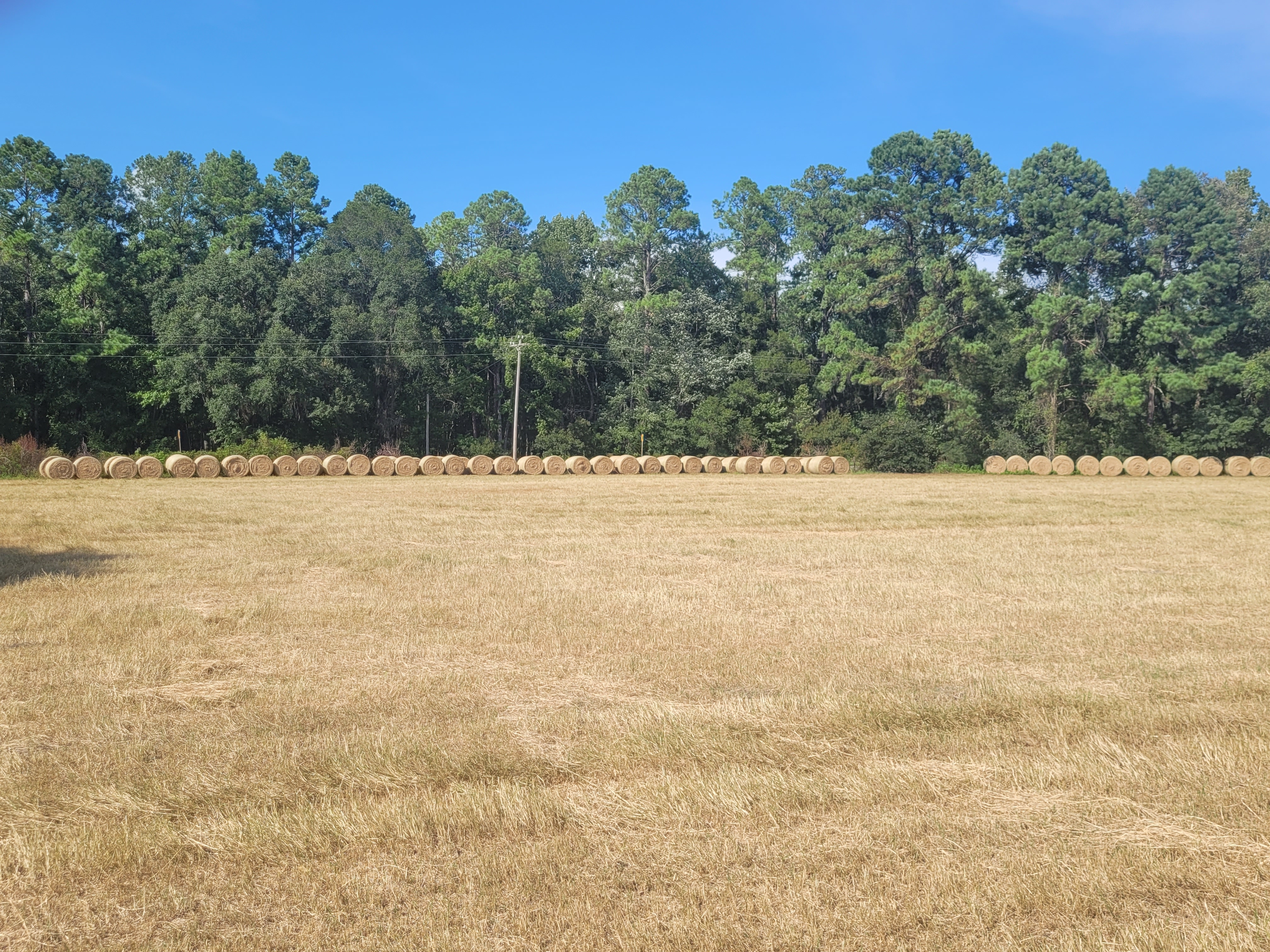

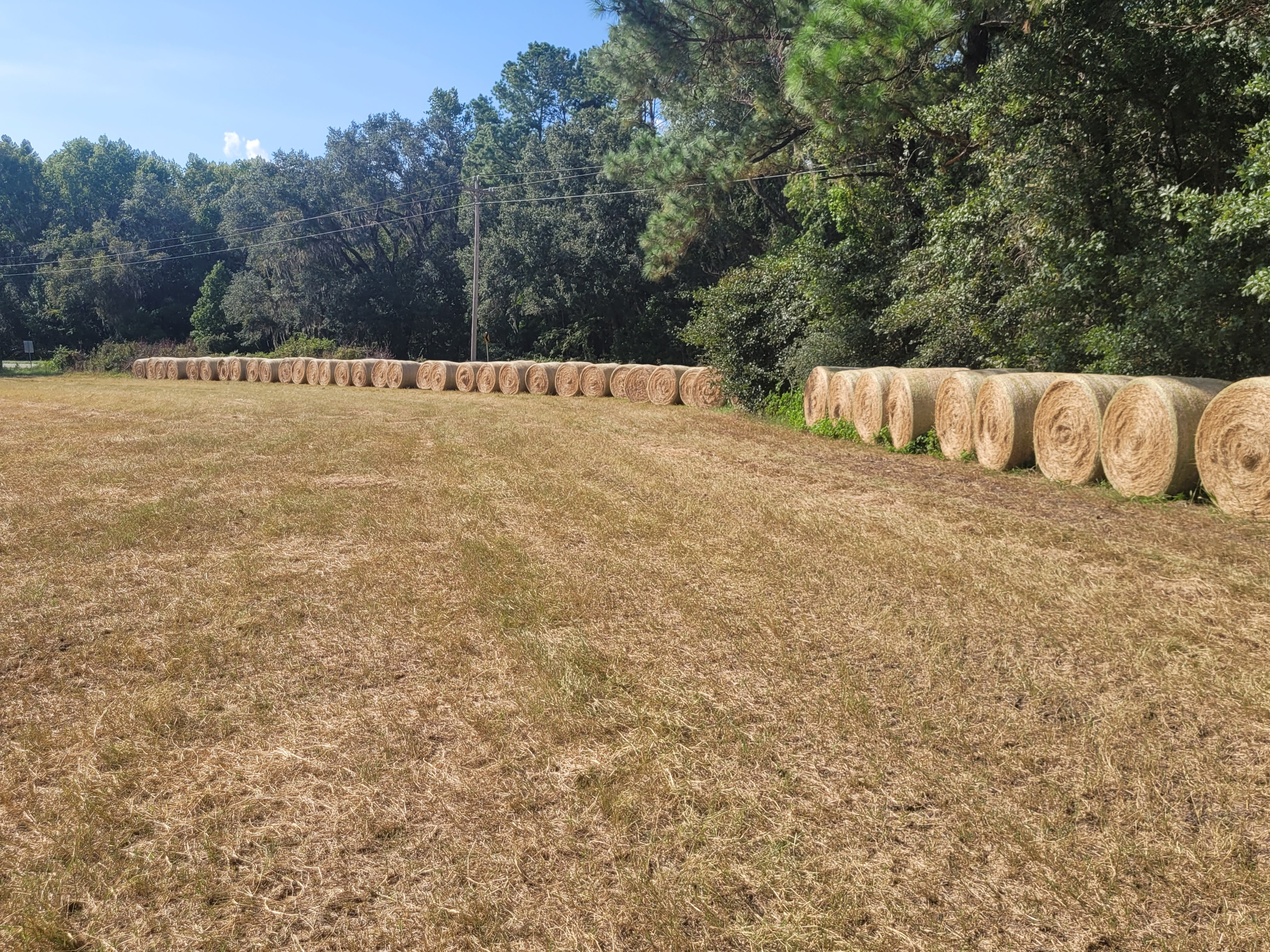

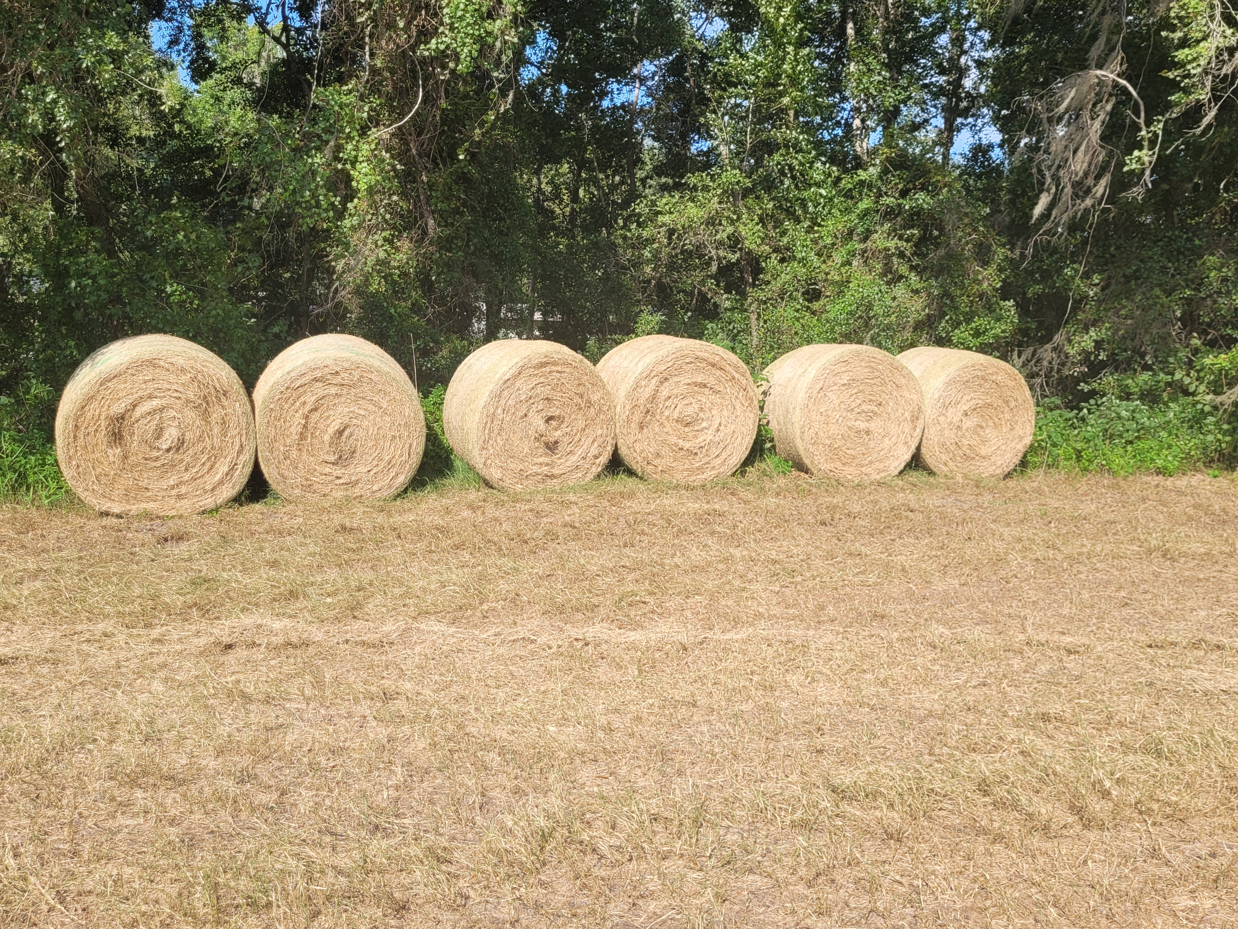

I wanted to update the thread, I am going to say that the product has increased my yield overall, I was averaging about 3.5 rolls per acre before applying the liquid lime and as of my last cutting I averaged 5 rolls per acre, I will update again after my next cutting to see if the results continue. Charlie.
   / Liquid Lime/Calcium Anybody tried it? #50
That's good to hear. I didn't think it would make much of a difference. Even if you have to apply it every year, it would be worth the investment.
What type of grass is the hay? Looks like it might be Coastal Bermuda???
